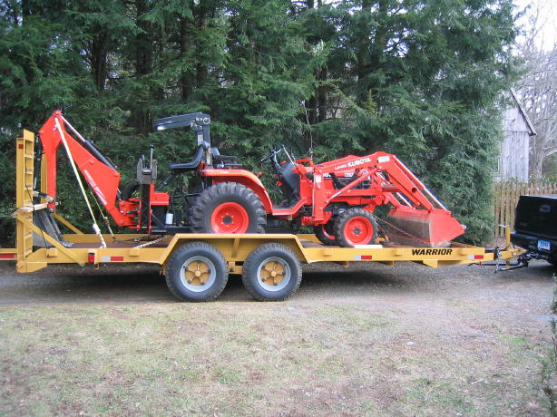

From other posts here in the past I pretty much concluded that when I buy a trailer it will be 18' minumum.
I like the tilt type trailer, 10K rating, dual axles, brakes on all wheels...others have in the past posted pictures of their B7800/2710/2910 size TLBs on 18' trailers and it seemed like the miminum good fit.
Even if you only trailer once, if that once things go wrong...that is all it takes to point out that the right trailer for the load would have been better.
I think there are both weight and size considerations. As well as poisition on the trailer considerations, in order to get the right tounge weight.
Others that know better can speak up, but when I buy a trailer it will be a 18 footer. This is based on what I have read here at TBN posted by others owning this size TLB...

Here is a picture of RayBee's B2710 TLB on an 18' trailer...
Just about fits perfectly...helped me realize that 18' is the minimum I need... /forums/images/graemlins/smile.gif
