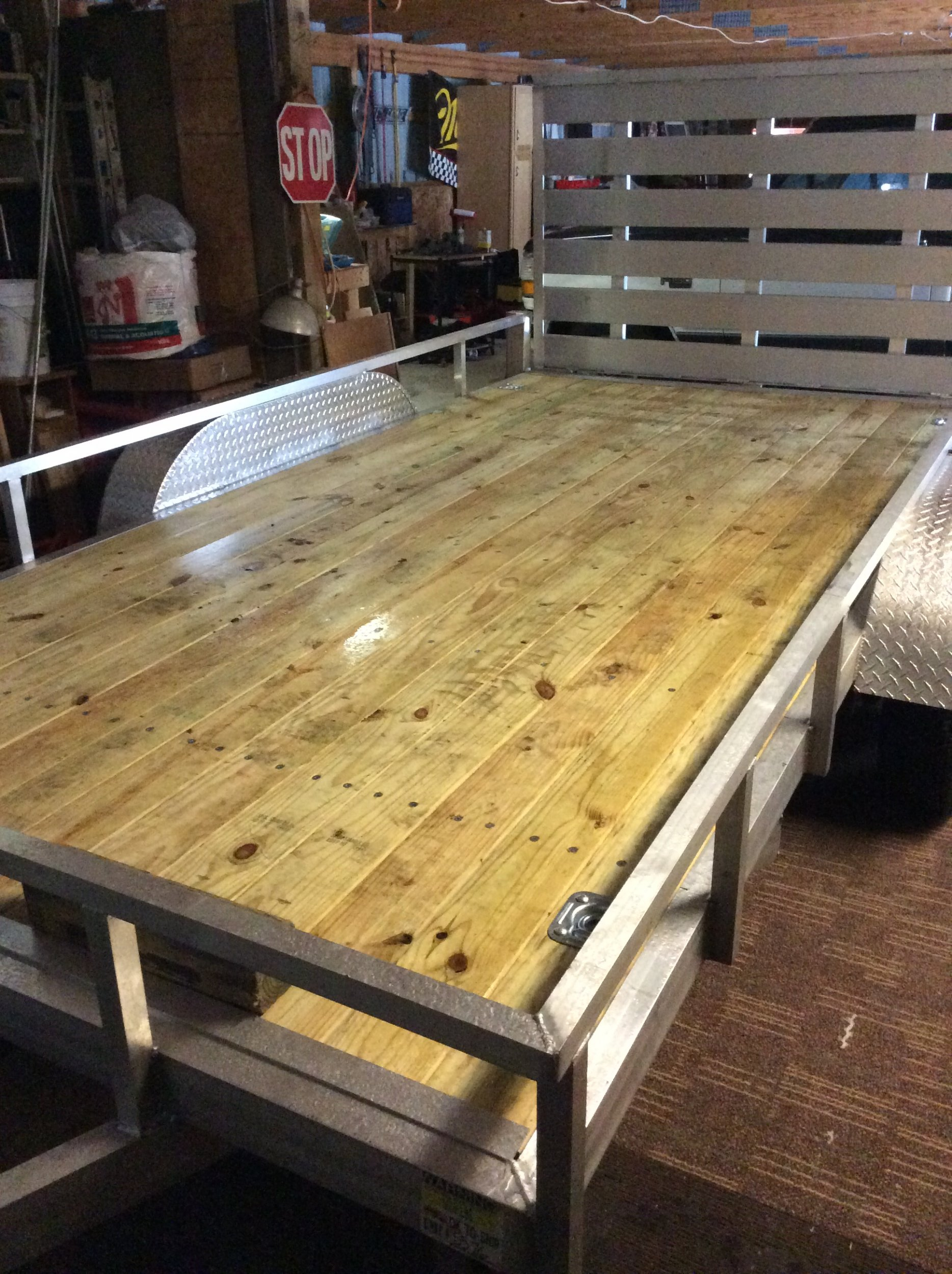

I use a 14' aluminum trailer. 5k capacity for my BX25. It has brakes.

Review the tow abilities of your truck or tow vehicle. I think getting any trailer that is smaller than tandem 18 or 20 ft will seem like a mistake in a few short years. This size will also tow well and back much easier.
But reguardless of what you get, look at the local market - trailers seem harder to find during the last 2 years. I highly recommend buying from a company who uses only certified welders. Become familiar with accessories that can be used with a triler - set back Jack, ramp storage, or tilt bed. spare tire mount, and brakes that are required in your states. Best Wishes.
