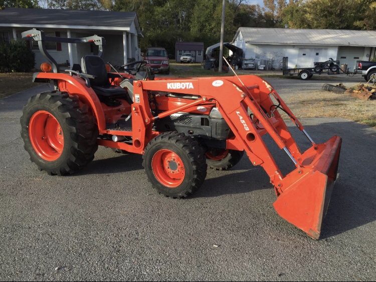

I have a Grand L 3130 Kubota with FEL. I am not buying a trailer any time soon, but always watching the market places for sales and private sales. If I find a deal, I want to know what I need. It’s no deal if it won’t do what I need it to.

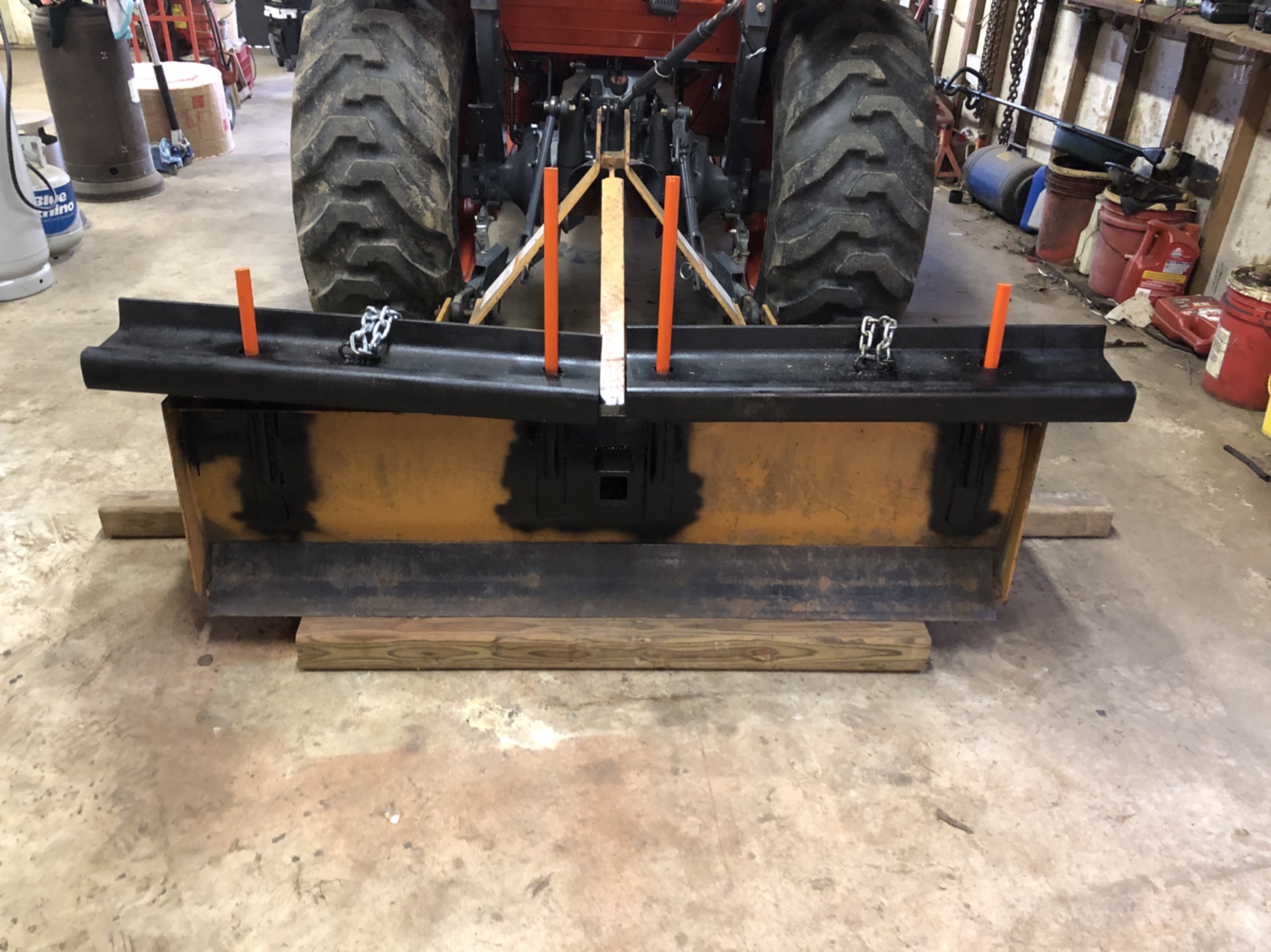

My tractor is 3,200 lbs ( not sure if this includes FEL). I have recently added some weight to my box blade and believe it comes in at around 1,000 lbs.
Typically I expect if I take it off property it will be the tractor, FEL, box blade and a 5’ Brush hog ( planing to get a EA brand bush hog at 665 lbs). So ballpark weight total of 4,750 ( assuming FEL is part of the 3,200 of tractor)
What length trailer and what axels should I be looking for? Will one axle with brakes be enough? Or must have both?
Thanks for any feedback! Y’all are typically informative! That’s great for newbys

Tractordata.com shows the weight for your tractor at 3305 Lbs (WITHOUT LOADER).
Box blade per your number = 1000 lbs.
Loader with bucket...maybe 800 lbs? (my guess)
Bush Hog....your number... 665 lbs.
Est. weight of trailer itself ... 3000 lbs.
Thus, your total = 8770 lbs.
You should get a 20' trailer with two 5000 lb. axles, and with brakes on BOTH axles.

Thanks for the info on with or without loader.
I just spoke to my father and he told me I should be able to weigh it all together at the steel plant he works at! So eventually I will trailer the tractor there and weigh the tractor with FEL to know that weight for sure, then weigh the box blade alone. Eventually I will have the exact numbers.
But the info you provided helps for sure for now! Thanks!

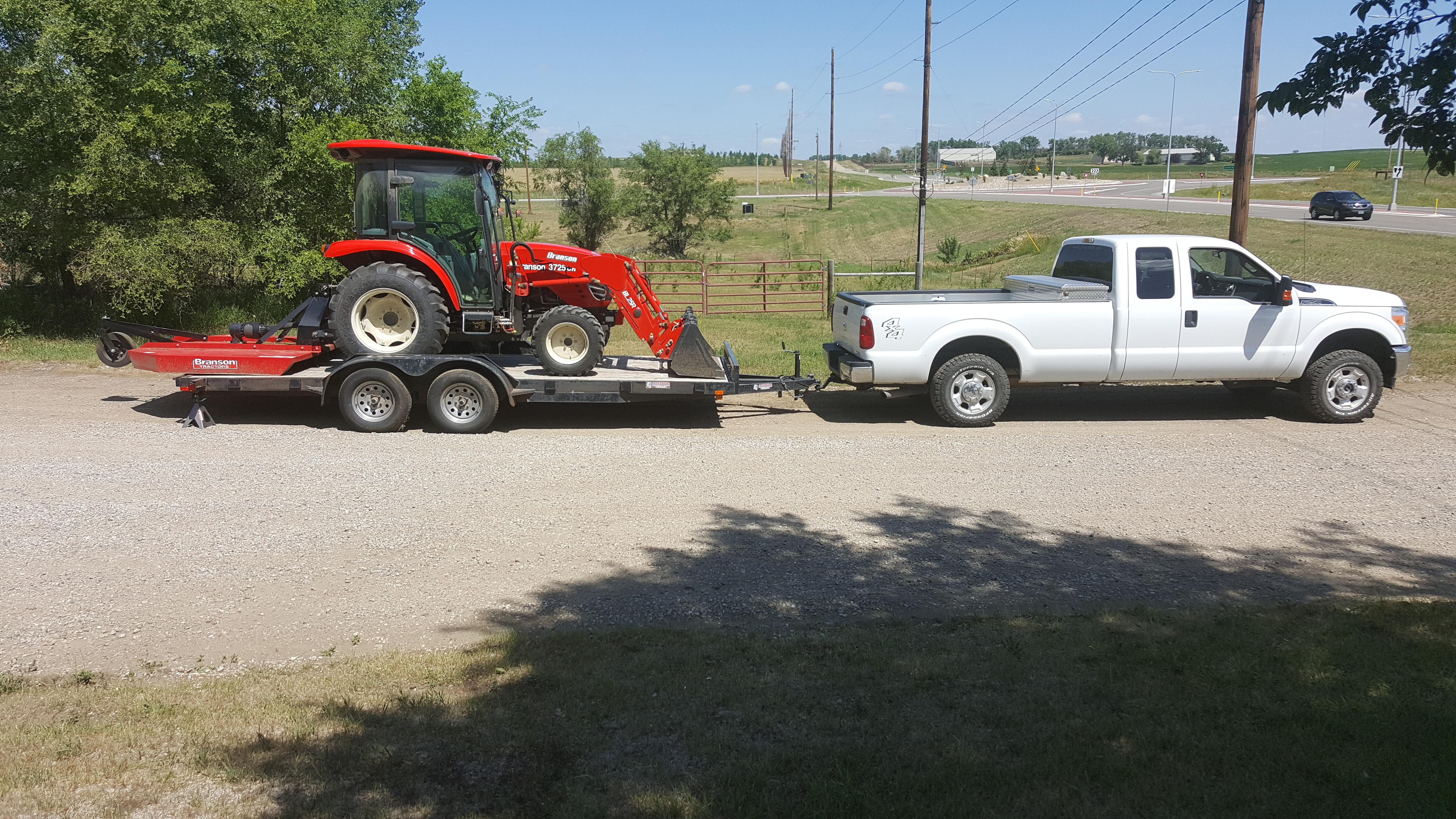

20’ foot will be cutting it close if your wanting to haul everything, I have a 20’ and mine fills it up real fast. You can always set everything in your driveway or yard as if it were on a trailer and get a idea of how long a trailer you’ll want. I also agree with fried on the axles and buy enough trailer the first time.

I have an 18' trailer now. With my tractor, FEL, and 6' brush hog, it hangs over the back of my trailer by several feet.
If you then want to also be able to haul it with a box blade as well, I would seriously consider 24' as the absolute minimum.
My next trailer will be a 26-28' deckover gooseneck.
