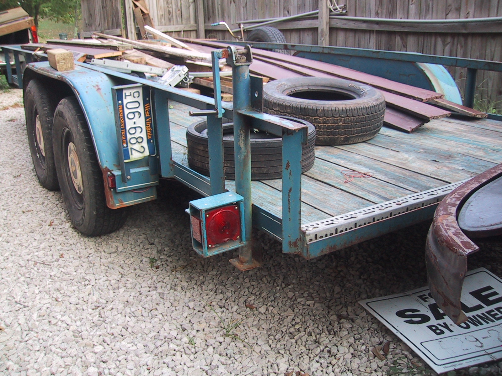

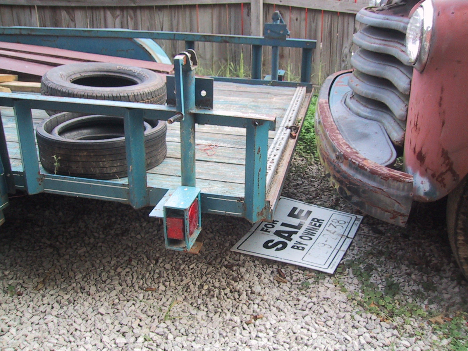

I used old Jacks from a truck camper "Cut down" on mine. pictures inclosed. But I have seen some home made just using Square tubing with holes drilled . Thats the way to go fast to use.

That is a good one, Oldmax. I like that, have to keep my eyes open for some of those things.
