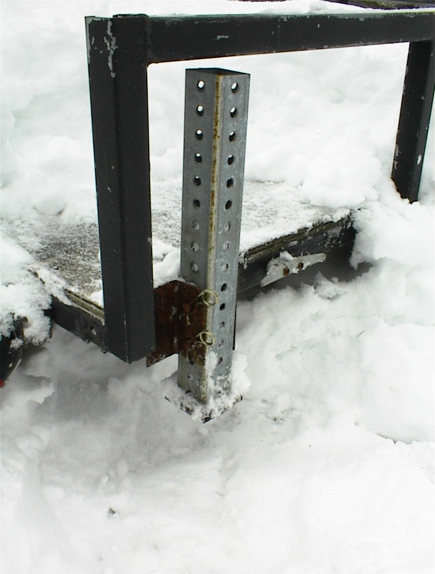

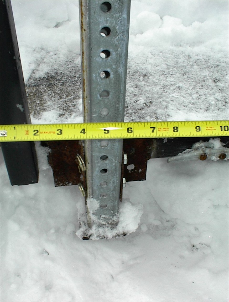

I made exactly what you descibed - used a couple of pieces of angle iron welded along the side of the square tubing. The Dept of Highways here use sqare tubing with holes every inch or so for sign posts. I was given some from a sign that was damaged and was able to get enough that was straight to make two legs for the back of the trailer. I have a jack on the front and the three points make a good strong base for unloading/loading the ride on lawn mower. I used bolts for the pins, got them long enough I could cut of the thread and drill a hole for a hitch pin. I dug the corner of the trailer out of the snow and attached a picture.

Donnie, the jackstands you added to your trailer are pretty close to what I have in mind. Although, I think I would still prefer to use a piece of tubing sliding within a larger piece of tubing for the extra strength and rigidity. I'm sure yours works fine though.
