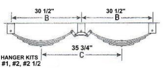

I did not catch this the first time I looked at it but it appears the equalizer is in funny and the springs should be on the topside like this picture shows that Tommu56 posted a link for. Either the guy who built it did it wrong or someone has had it apart to rework this trailer and put it back together wrong.
Where do you usually keep the springs? They should be hung on the topside of the equalizer.

Hopefully just removing some hardware and re-assembling everything correctly will work.
Otherwise you may need to remove the ft. and rear hangar brackets to get the correct lengths with the springs assembled on the correct side of the equalizer.

Thanks Guys, I thought they were supposed to be under. I will put them both over and see if they stay.
