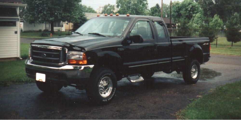

Ooh yeah! Pictures of Super Duty's. That's what I like to see.
Hoss and Inspector, you've both got nice looking trucks.
I'll add mine to the mix. It's a '99 PSD.
--Brad

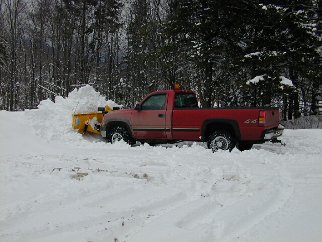

Do you guys have a problem with the caps lock on your key boards? Seems like when ever you type "truck" it comes caps /w3tcompact/icons/tongue.gif. I guess I'm out numbered... no other Chevy's out there... Help!
Actually I have no preference. Attached is a picture of our wrecker it also has a 9' plow for winter. It was the last year they made the old body style, which I like better than the new Ford or Chevy. Ended with the Chevy due to some problems that Ford would not take care of because they claim it is a commercial use and voided warranty, that's a story all on its own. Then some stuff happened after warranty that just shouldn't be with a truck like that. So went with a Chevy, dealer was closer and better managed. We'll see if the Chevy can take it. We plow 100 commercial driveways in the mountains. One winter behind with no problems, we will see what happens in 5 years.
Not trying to stir things, just having some fun /w3tcompact/icons/smile.gif!
