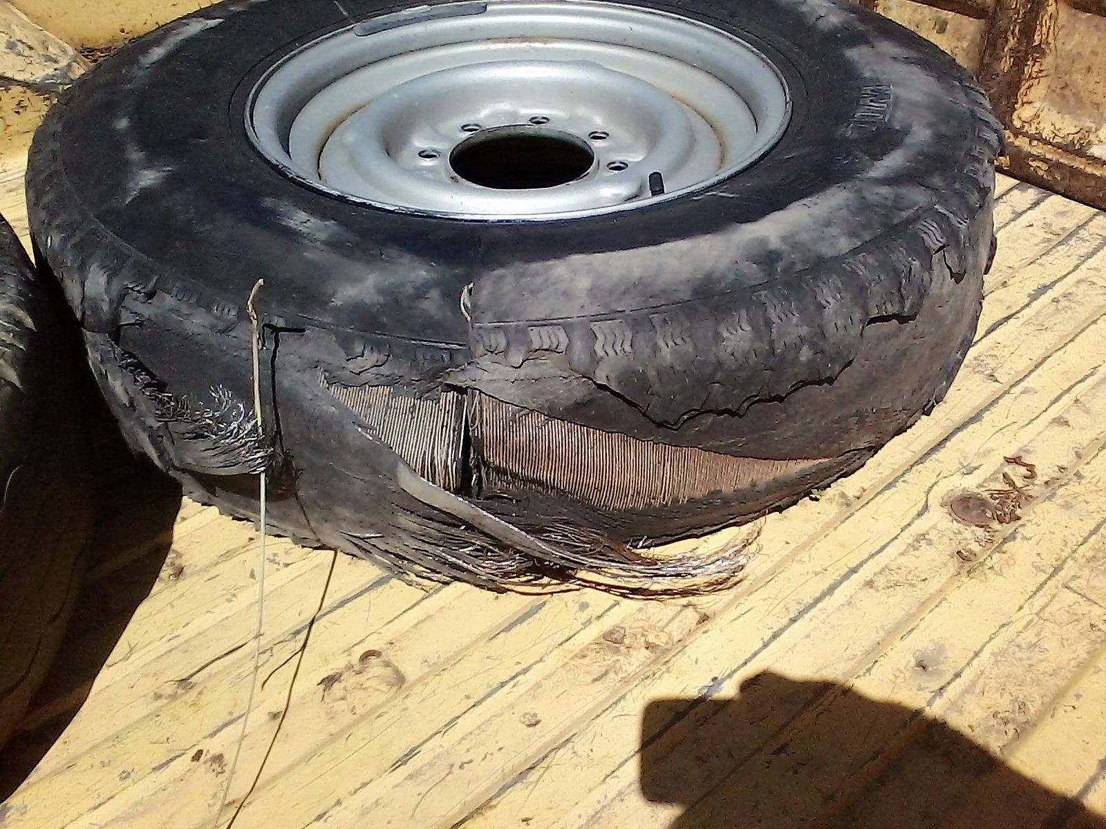

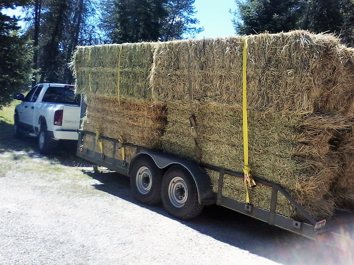

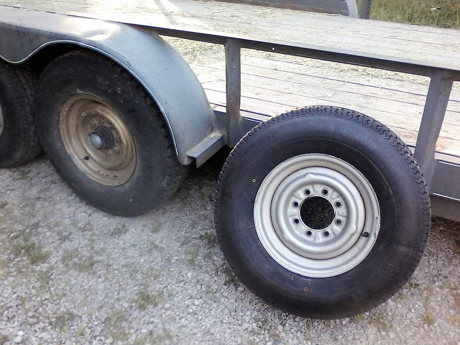

hauling hay today, and one of my 235 85 16 LT radials let loose (sounded like a shot gun)was doing about 55 mph
wasn't specific when I dropped the tire off an when I picked it up it was a trailer tire, although it says E rated-old spare and new trailer tire.jpg
we will see?

Looks like those LT tires are nearly bald and way past replacement time.
Yep,
the other sides tires have been replaced more recently- and have more acceptable treadtrailer tires driver side.jpg

this is making me feel all warm and fuzzy:laughing: hauling hay today, and one of my 235 85 16 LT radials let loose (sounded like a shot gun)was doing about 55 mph <img src="http://www.tractorbynet.com/forums/attachment.php?attachmentid=474598"/><img src="http://www.tractorbynet.com/forums/attachment.php?attachmentid=474599"/> Made it home with an old spare michelin 10 ply recap, <img src="http://www.tractorbynet.com/forums/attachment.php?attachmentid=474600"/> wasn't specific when I dropped the tire off an when I picked it up it was a trailer tire, although it says E rated-<img src="http://www.tractorbynet.com/forums/attachment.php?attachmentid=474601"/> we will see?
What is that trailer rated for? It looks like a landscape trailer, but I think I see it is a gooseneck. You have about 9,000 lbs of hay on that. Your trailer weighs at least 2500 lbs. Thats 11,500.
