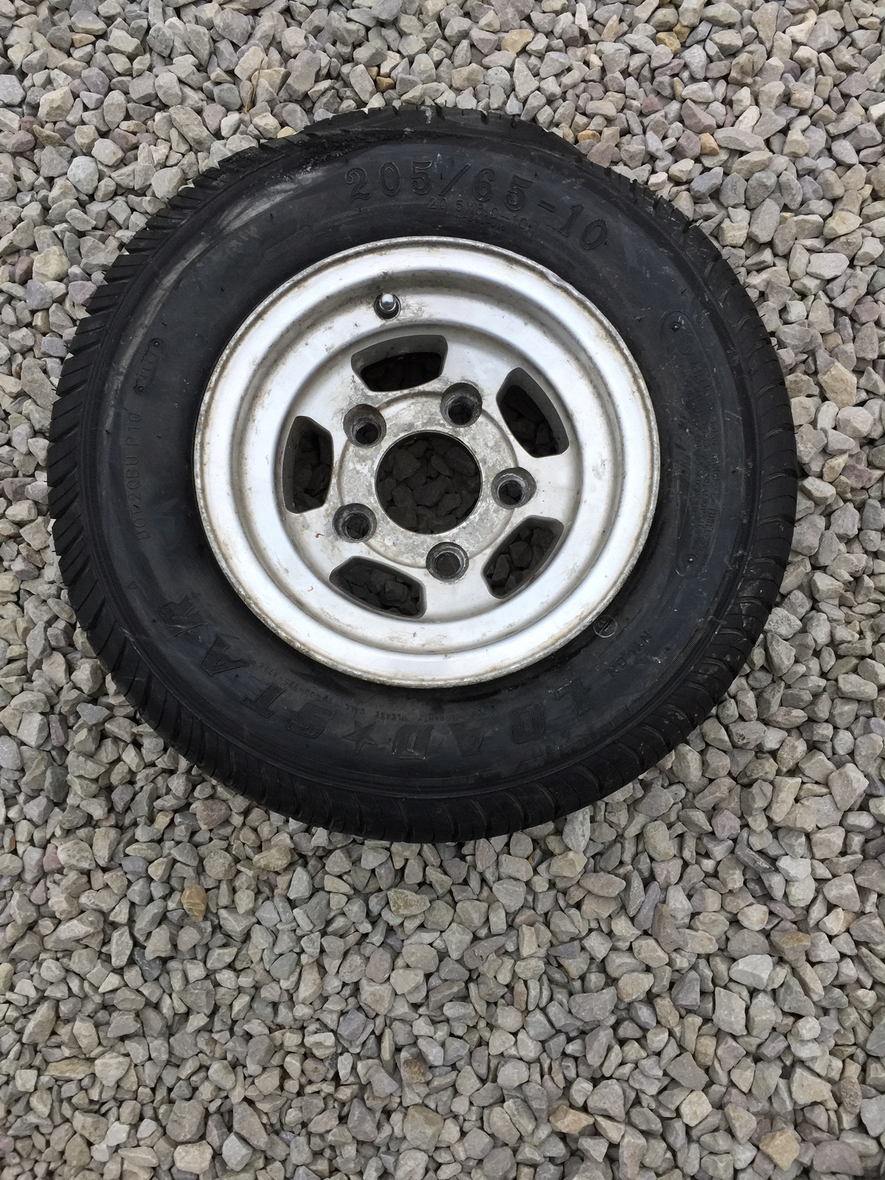

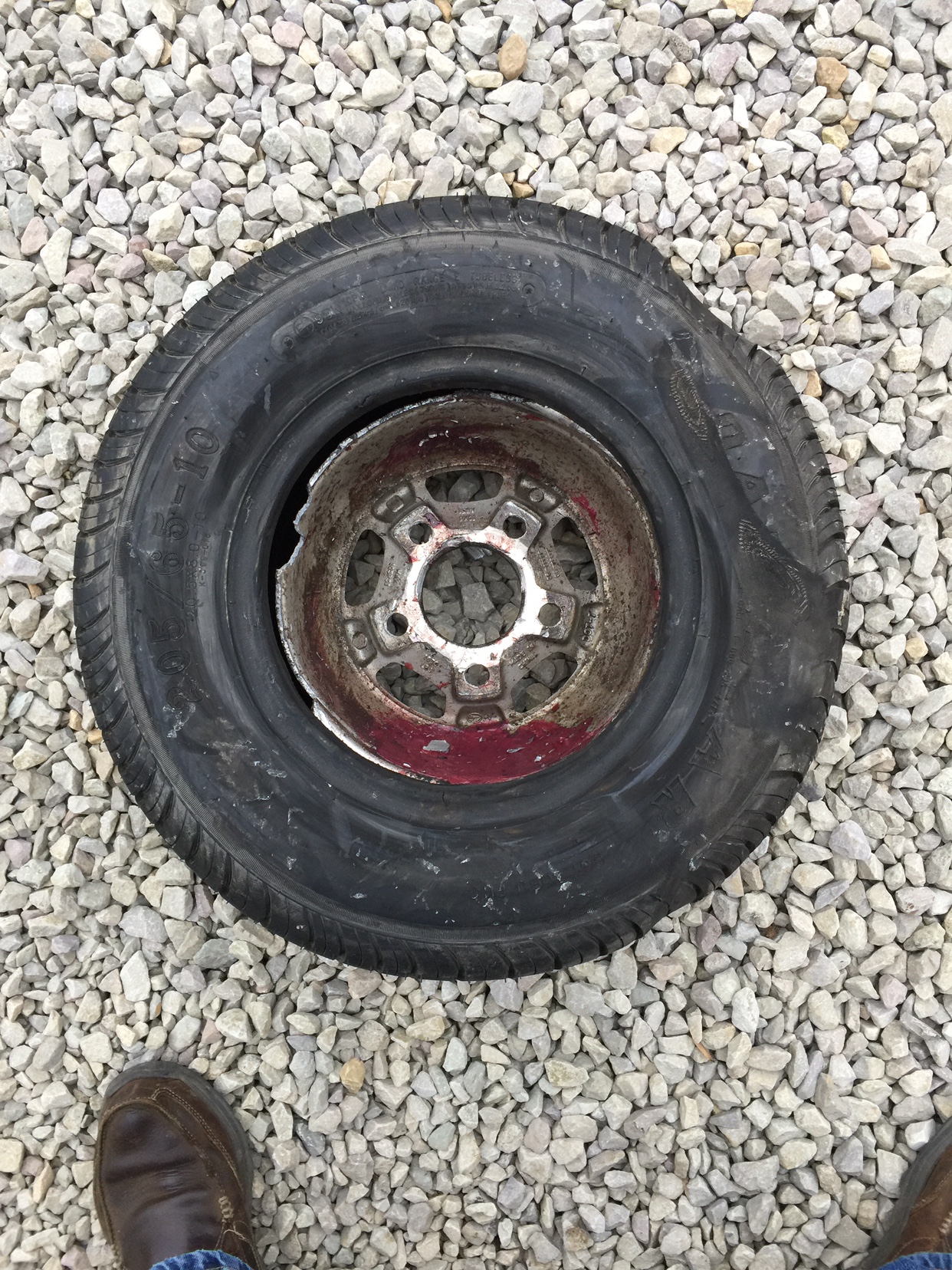

OP, do you have any pictures of the shattered wheel?
You are correct, it did shatter.... and concerning this, I am more concerned about needing to replace the lug studs on the axle itself as a couple of those I couldn't spin the lug nut on by hand all the way but had to use the lug wrench as them seemed to possibly be somewhat scarred, or boogered up a little.
I don't have any pics on me, but I will take a couple this evening, as well as the trailer itself and the other rim that is still in working order.

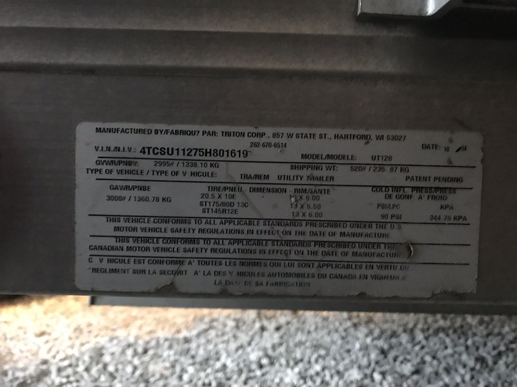

What is the pressure rating of the aluminum wheels you're using? Is it possible the wheel failed first?
I've seen a pretty wide range of quality on aluminum trailer wheels and have been surprised that many are rated for pressures lower then the tires used.
That’s a good angle to peruse. A little looking and it seems that the ut128 trailer parts diagram shows tire, 20.5 x 8.0 which indicates an 8 rim, right? The tires chosen however say to mount on a 6 rim. :confused:
Well, I need to verify the model, as the 10" rims were the original, so it is probably not the UT128... I will look this evening and correct that. However, speaking of rims and weight limits… I assume, this is just like axles... so if you have rims that are rated at 900#'s, that means you should be able to carry a load of 1,800#'s if a single axle, correct? The reason I ask, is b/c the highest weight rating I seen on 10 or 12" rims were like 1250#'s and this trailer is supposedly designed to carry up to 1,660#'s.

Sir, I was not criticizing your driving style.
I was just making a general point agreeing with another member post.
In your case, we are all speculating.
I will say that if the lug nuts are no longer in position, that is the likely cause of all your damage.
Several reasons for lug nuts to come loose.
.improperly torqued and not retorqued at 50 miles or so.
.wheel improperly fit to hub or debris preventing proper fitment. This makes the nuts seem torqued but as the wheel and hub move, they seat together, closing the gap and essentially causing the nuts to be loose.
.hub bearing failure causing excessive heat to the wheel, studs and nuts.
.Aluminum wheels are greatly more susceptible to all of these issues.
Correct, it's the sum of the wheels capacity.
