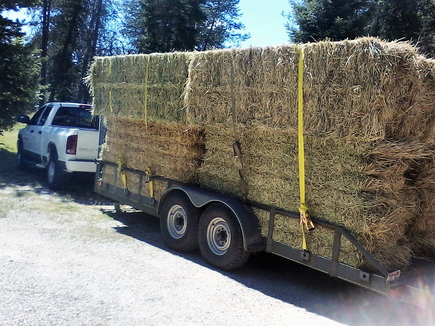

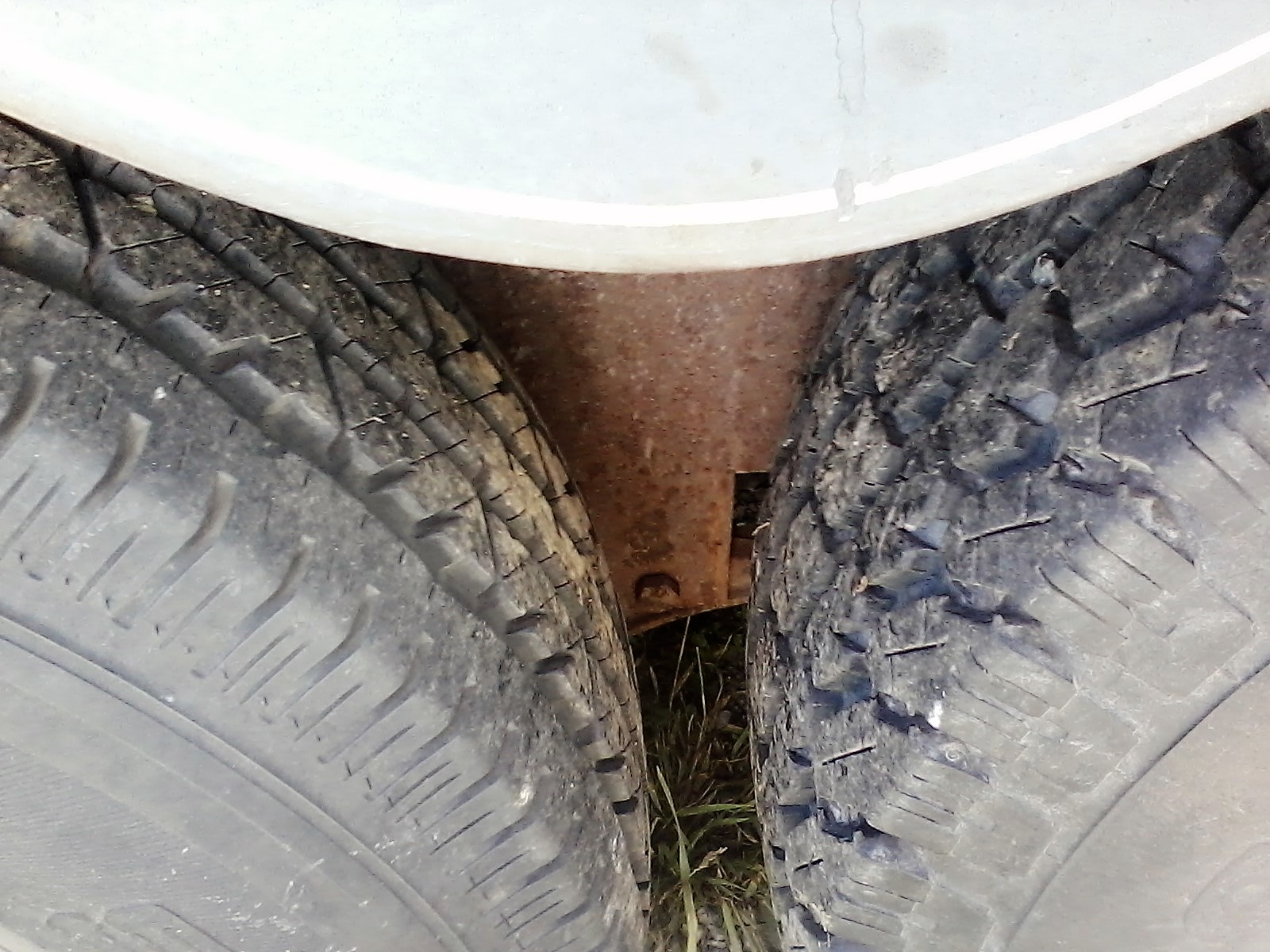

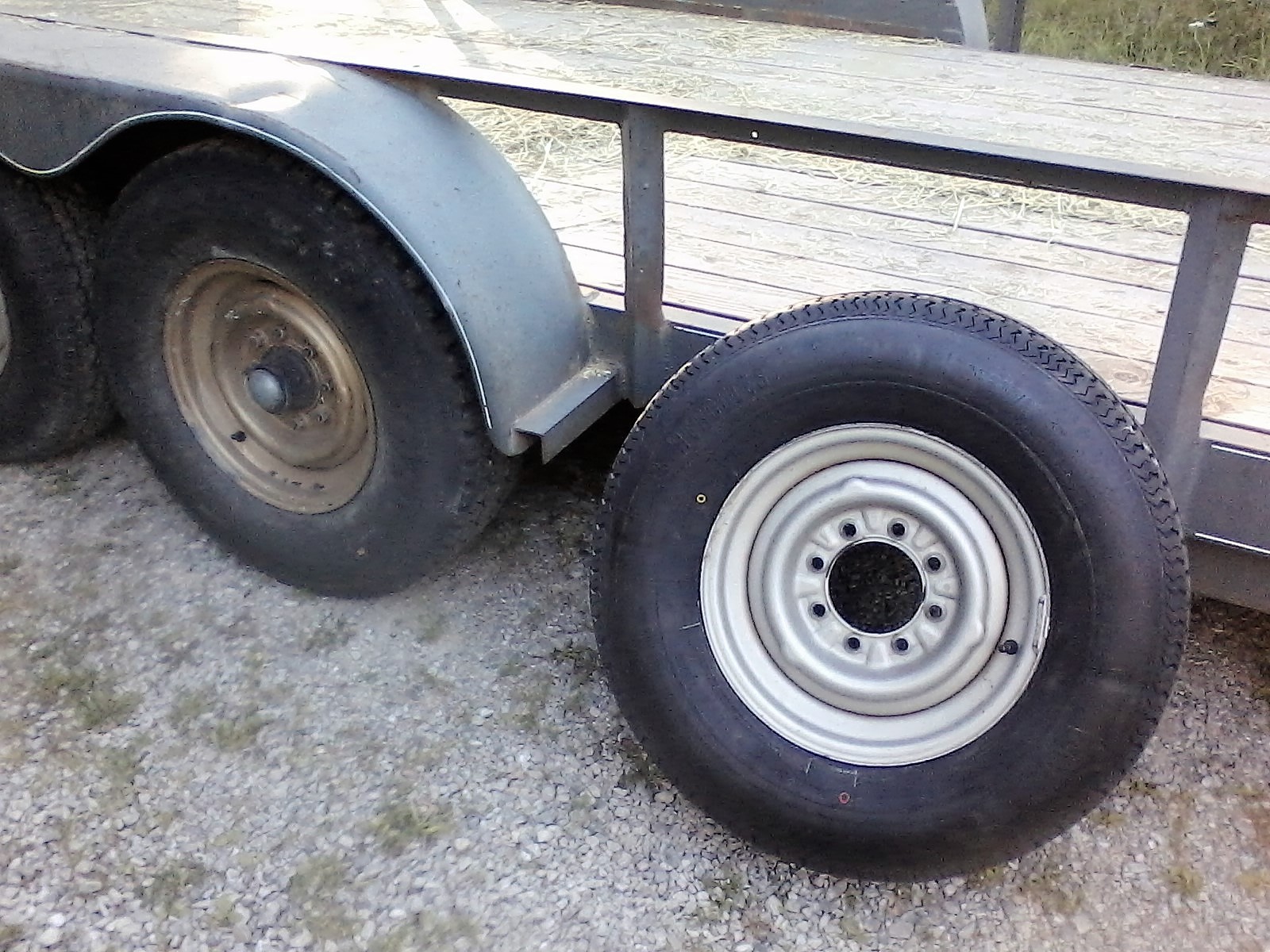

hauling hay today, and one of my 235 85 16 LT radials let loose (sounded like a shot gun)was doing about 55 mph
wasn't specific when I dropped the tire off an when I picked it up it was a trailer tire, although it says E rated-old spare and new trailer tire.jpg
we will see?

Made it home with an old spare michelin 10 ply recap, View attachment 474600
wasn't specific when I dropped the tire off an when I picked it up it was a trailer tire, although it says E rated-View attachment 474601
we will see?
Looks like those LT tires are nearly bald and way past replacement time.
   / Trailer Tire Failure - Not a good way tho start the weekend #57
Yep,
the other sides tires have been replaced more recently- and have more acceptable treadtrailer tires driver side.jpg

What is that trailer rated for? It looks like a landscape trailer, but I think I see it is a gooseneck. You have about 9,000 lbs of hay on that. Your trailer weighs at least 2500 lbs. Thats 11,500.
