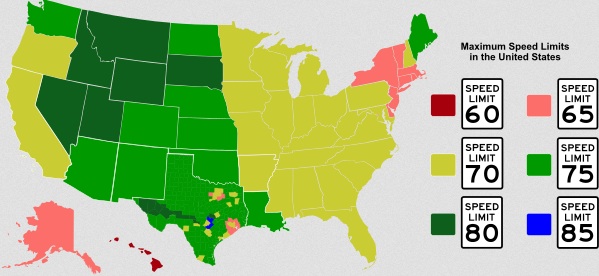

Where is the speed limit 80?
   / Trailer Tire Failure - Not a good way tho start the weekend #45
From:
Speed limits in the United States - Wikipedia, the free encyclopedia

Dang. I was hoping it was by my house.

Wow, I didn't know such a large part of the country had 70mph as the max. Almost all of my driving is in the 80mph states.
