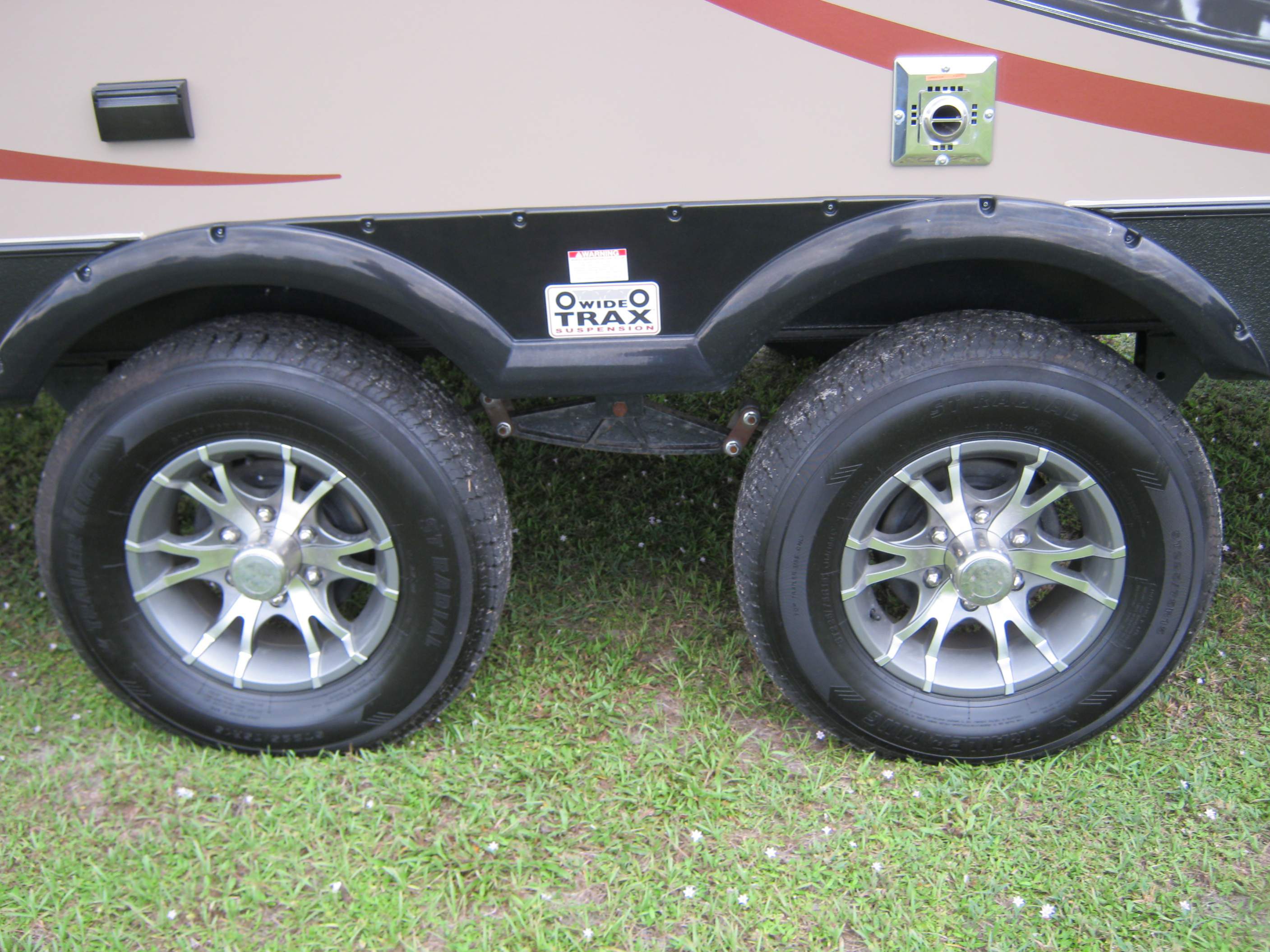

:eek:ptimist: Just checked tires that came with my 2014 Heartland 26lrss
They are Trailer Kings ST Radials
