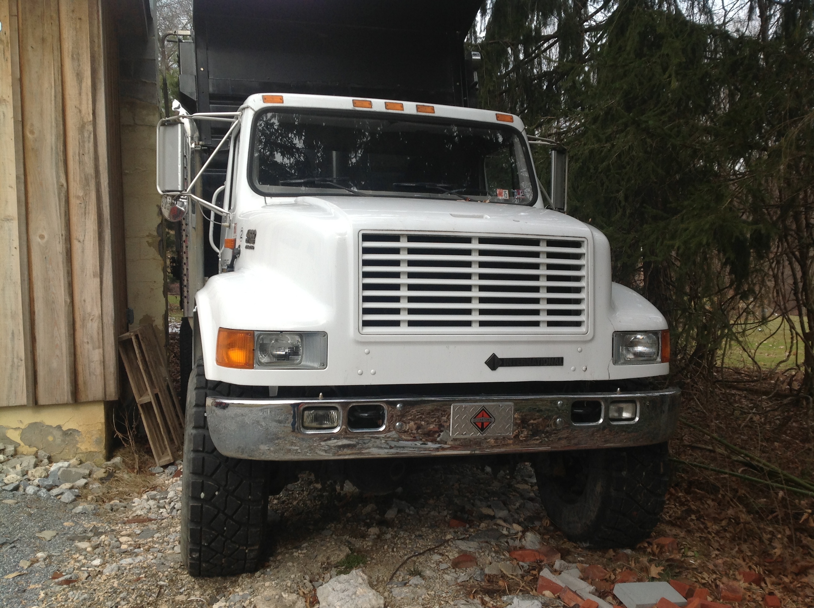

I use drive tires on the steer axles of my 4WD trucks.
No issues.

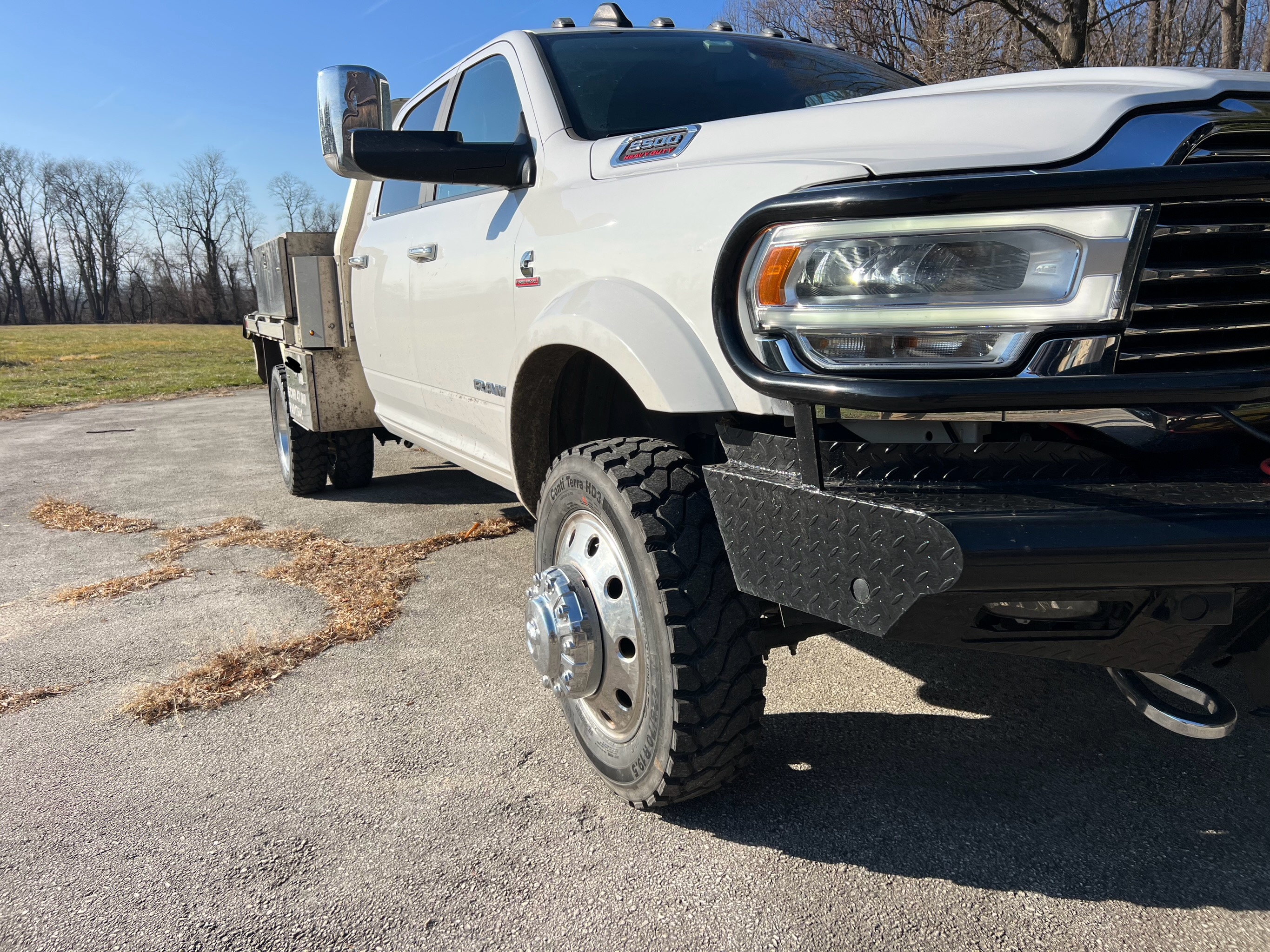

I'm guessing your talking about a pickup truck, not a semi-truck?
I have them on my Ram 5500
I use All Terrain tires on my Pickup truck, they are not axle application dependent ... Semi-trucks have a whole lotta laws that apply

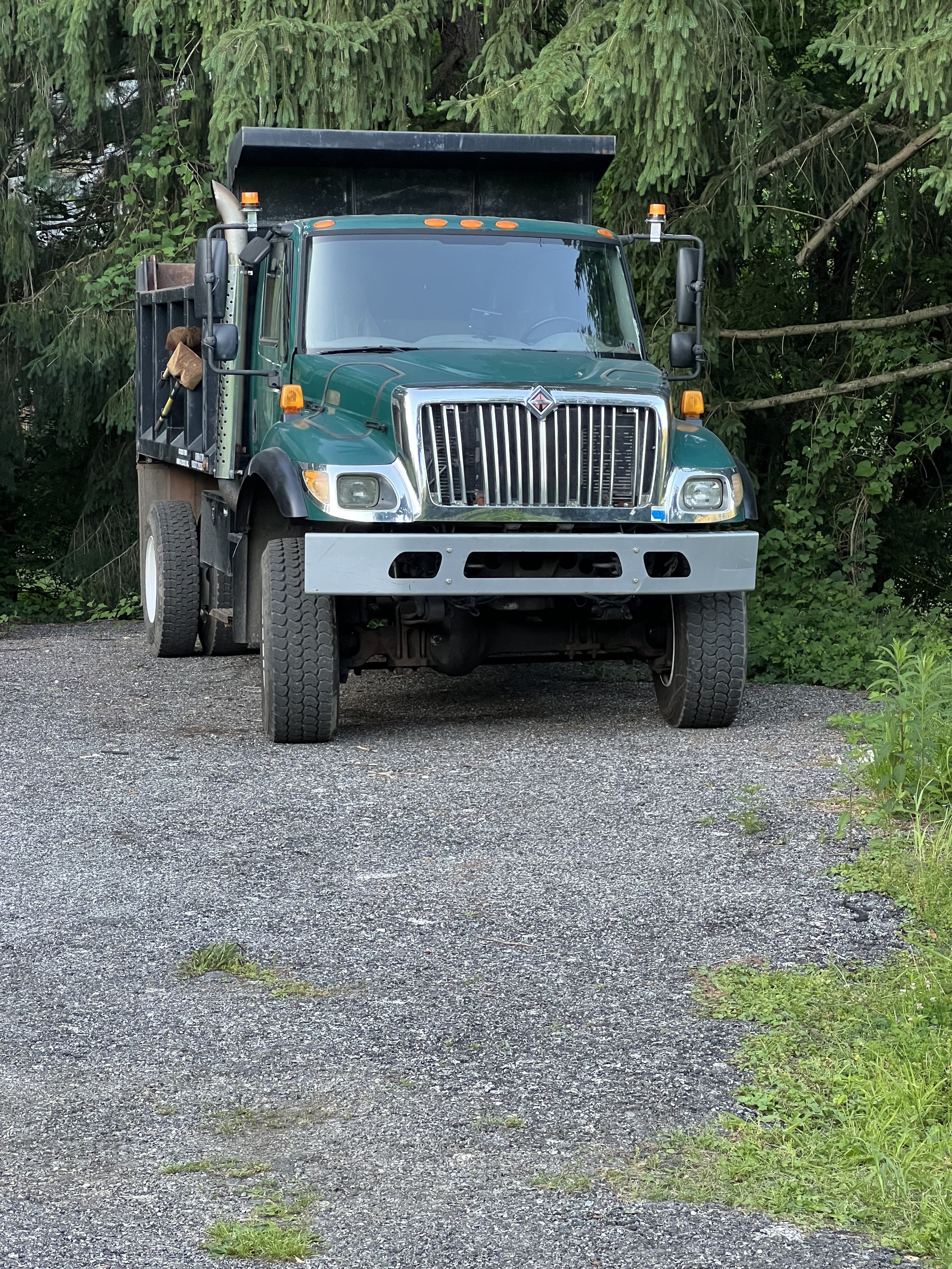

I had them on my previous class 8 35,000 GVWR dump truck.
Current class 8 42,000 GVWR dump truck has milder drive tires on front, but these are also used as super single drive tires.
My point is, drive tires are used on steer axles all the time (front discharge concrete mixer, 4x4/6x6 digger derrick, etc.)

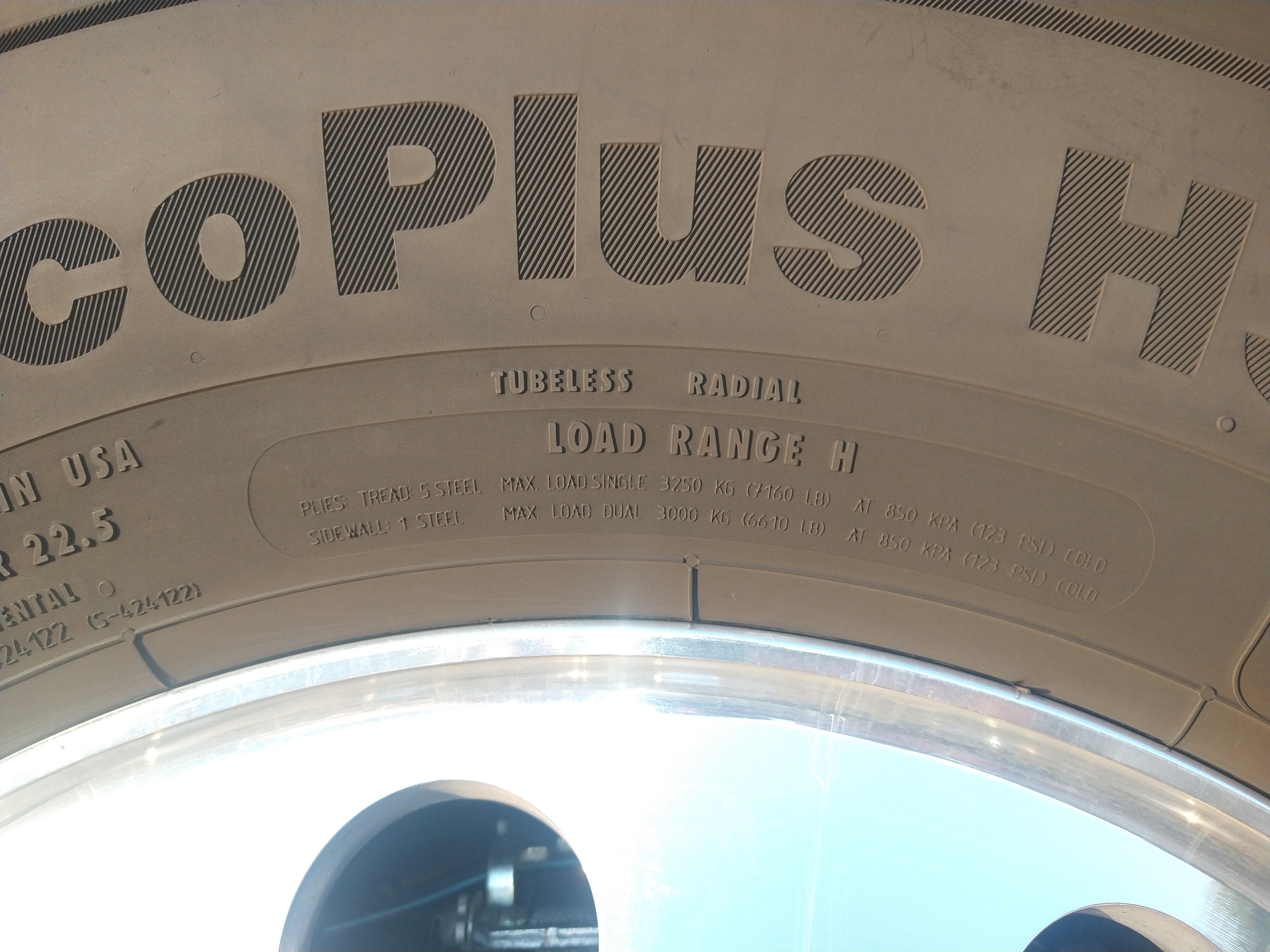

Most all tires of this size have a separate rating for single or duals ...
Here is mine ...
At 6600 Lbs per tire in a dual set up ...is 26,400 Lbs per axle ... Most axles are only rated for 20,000 Lbs, and a tandem axle group with duals (8 tires) is only rated for 34,000 Lbs going down the road, unless you axles are spec'd higher, AND you pay for an overweight permit ...

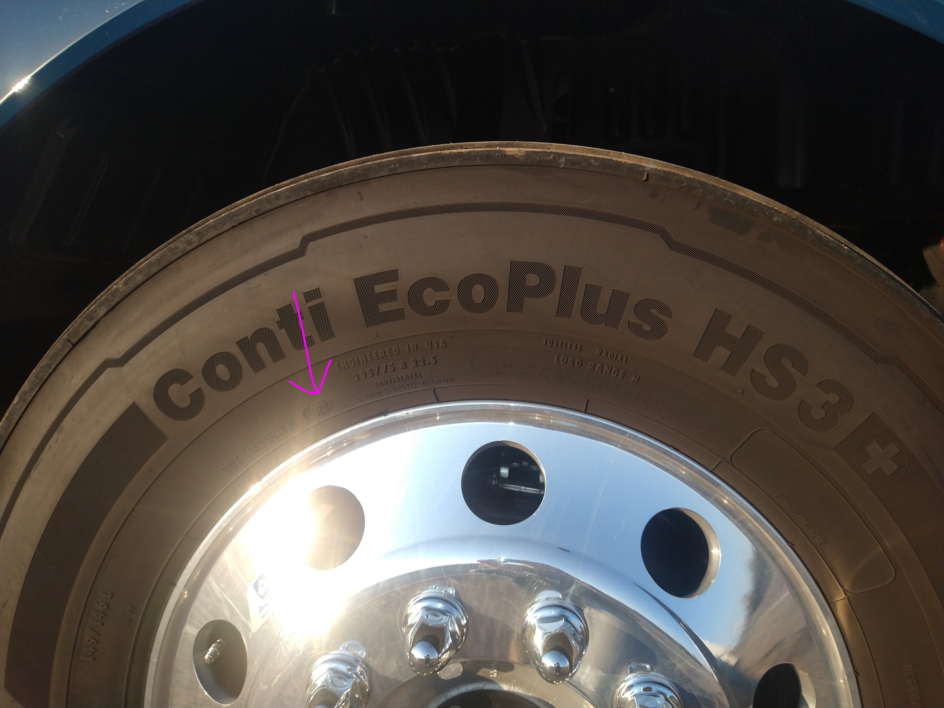

These tire photos are good, but would someone please post a photo showing where to find the year manufactured info and if it's a code please decode it.
I went and looked at my various tires and - aside from the tire size - all I could find was "made in usa". No mention of when! No mention of when. Thanks.

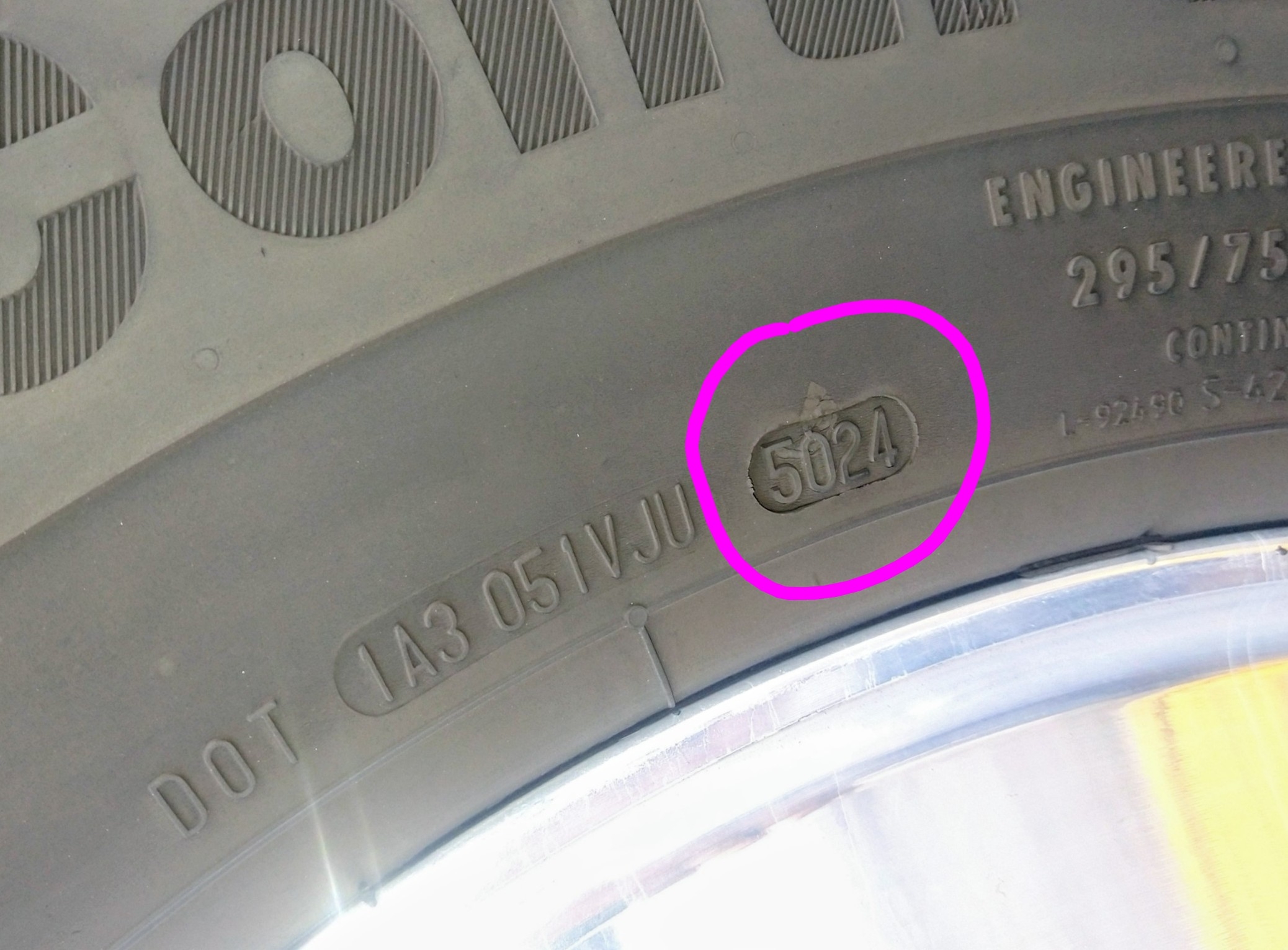

From that previous picture ...
A close up ...
The "50" stands for the 50th month week, and the "24" stands for the year 2024 ... My truck was built in April 2025.
