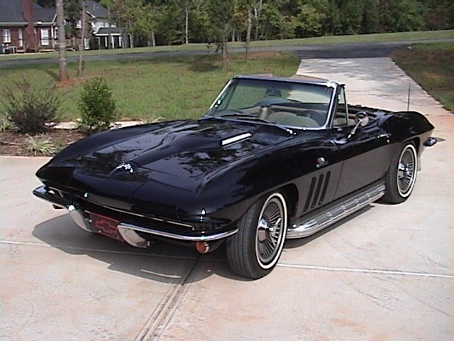

Wow, the cross your straps opinion was one that I got from the trailer rental guy and just about every place I searched on the internet. Many on the internet not only cross their rears but also their fronts as well. After reading your post I guess the determining factor is where the tie down points are on the trailer as compared to the attachment points on the car. If they are slightly outboard you already have your lateral hold built in. If for some reason they were at the same width you might get some side to side movement. I am off to pick up the trailer within the hour. Hopefully it will all become clear when I go to strap down the car.

Check this out. I copied it from the "How to" section of the catalog of a towing equipment supplier.
RECOMMENDED STRAP ALIGNMENT FOR RACE CARS,
ANTIQUE or CLASSIC AUTOS AND MOST FOUR WHEELED VEHICLES
Position vehicle on trailer. Move vehicle as necessary to balance trailer for Tongue Weight Distribution.
Attach one (1) pair of Tie-Downs to front end of vehicle at a point below suspension system and in a manner preventing strap movement.
(a) Attach Ratchet end of Tie-Downs to trailer bed attachment hardware.
(b) Activate ratchet and apply equal tension to each Tie-Down strap.
Attach one (1) pair of Tie-Downs to rear end of vehicle at a point below suspension system and in a manner similar to that described above for the front end of the vehicle.
NOTES:
Webbing should be protected against contact with sharp edged parts, hot surfaces and acids. Do Not Use Tie-Down if webbing is cut, frayed or damaged.
To achieve tie-down load rating, all strap components must be in straight line with the direction of pull.
Hardware should have load rating equal to or greater than the rating of the Tie-Downs.
Criss-Crossing of the Tie-Downs should be used only when both ends of Tie-Down strap are securely locked in a fixed position to vehicle component and to trailer attachment point prohibiting Tie-Down movement
In a perfect world if I were towing the same vehicle on the same trailer I would have my attachment points on the trailer floor located in such a manner as to have the staps at approximately a 30 degree angle and 3"-4" to the outside of the attachment points on the vehicle. That will give you the optimum towing tie down strength and security.
Most people make the mistake of trying to secure the vehicle too near to straight down. That's not at all the best way to go. Good luck with your journey. /w3tcompact/icons/smile.gif

Thanks, everything went great securing the car. The oval holes in the frame along with the T hooks made it very simple. I did end up crossing the straps at the rear as the tie down points were at about the exact width of the attachment points on the car. I did end up putting a blanket at the point that they cross and since the frame attachment point on the car is on the bottom of the frame the straps touch nothing on the car. My only complaint is that I have a hard time seeing the passenger side tire in my mirror when making right turns. The regular mirror is filled with a lot of white trailer and my spot is a bit small to see where exactly the wheel is. I'll just have to be extra careful on that one.

<font color=blue>Jeff, tell ya what. For $10,000 I will drive down, pick the T-bird up and drive it back to my place. This will let you forget all about this trailering stuff. No more worrying. No anxious trip and 10 grand too. Whaddaya think?</font color=blue>
That offer is acceptable with the one minor change I have made. Let me know!/w3tcompact/icons/smile.gif
