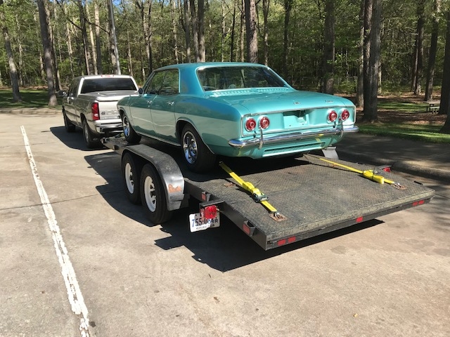

Great TIP! In Virginia your required a annual inspection on trailers that have dual axles they do a good job checking everything, But they never check the sleeve for the 7 way connections. I very rarely check it myself, & the only reason I check it is; It was required on pre, inter, & post trip inspections to check your pigtail when I drove a truck for 40+ years, But nobody ever checks inside the plug'n sleeve. Again great warning Hay Dude that will be a item on my safety check list from now on I just did a 841 mile trip with my trailer earlier this year to pick up a car. I checked everything on the trailer, But that thank You again. IMG_0116.jpg
