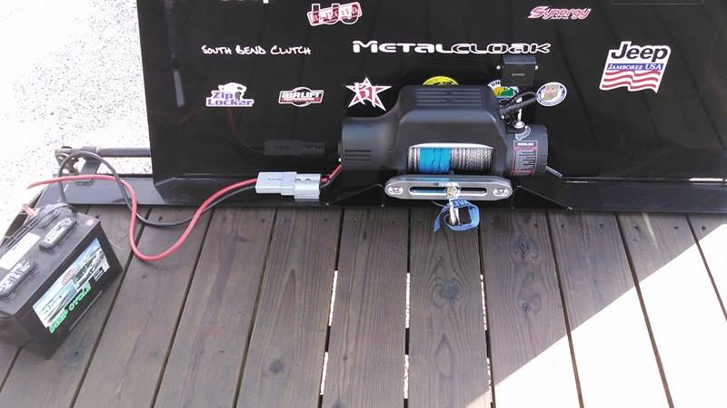

Anderson Powerpole and SB Connectors | Powerwerx specifically SB175 SB Series 175 Amp Anderson Powerpole Kit | Powerwerx in yellow (for 12v according to Anderson Powerpole - Wikipedia) is the best price around I've found.
I used 16 Ton Hydraulic Wire Terminal Crimper Battery Cable Lug Crimping Tool W/dies - - Amazon.com to crimp. Not the greatest tool, but adequate for occasional crimps. I suspect it's not any different than the higher priced similar Chinesium ones.
Also have some tinned copper lugs to crimp on for the battery post ends. Don't remember where I got them from. Probably Powerwerks as well.

I'm putting a winch on my trailer, putting a battery in a toolbox. I'll also get jumper cables in case I need them.

I have an 8K ramsey winch on my trailer. I ran wires from truck battery back. Installed these Anderson Power Products - 6319 - SB 5 SB 5 connector Gray Power Connector Housing - Allied Electronics at the back of my truck and wires from the winch. I ran the ground from the truck battery back because I was always having ground issues (rust, dirt, grime). I welded a SS bolt to my trailer and connected ground for winch there for the same reason, rust dirt grime = bad ground connection. I could buy wire and connectors cheaper than buying and maintaining another battery
