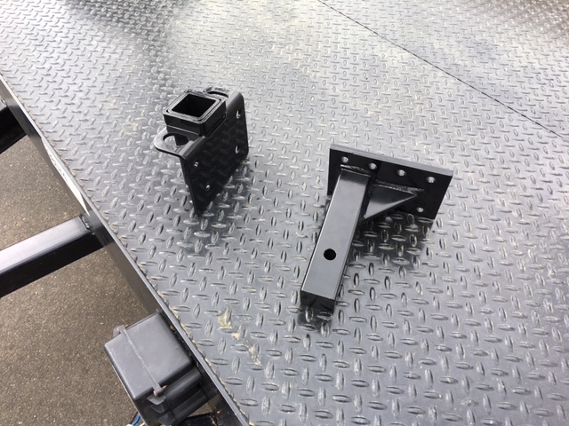

Okay, here is my little bolt-on solution for a removable winch mount. It required two parts from Northern Tool. The first part is a box hitch receiver made to bolt on the underside of a step bumper. It is a fairly beefy part. The second part is a pintle hitch adapter that fits in a box receiver. It is very beefy; too much so in fact. The shaft is solid steel and it is heavy and makes the whole winch assembly heavy when moving it. Both parts are shown here and cost about $65:
My trailer has a fairly thick , 6" high panel across the front. I drilled holes and mounted the hitch receiver facing up as shown:

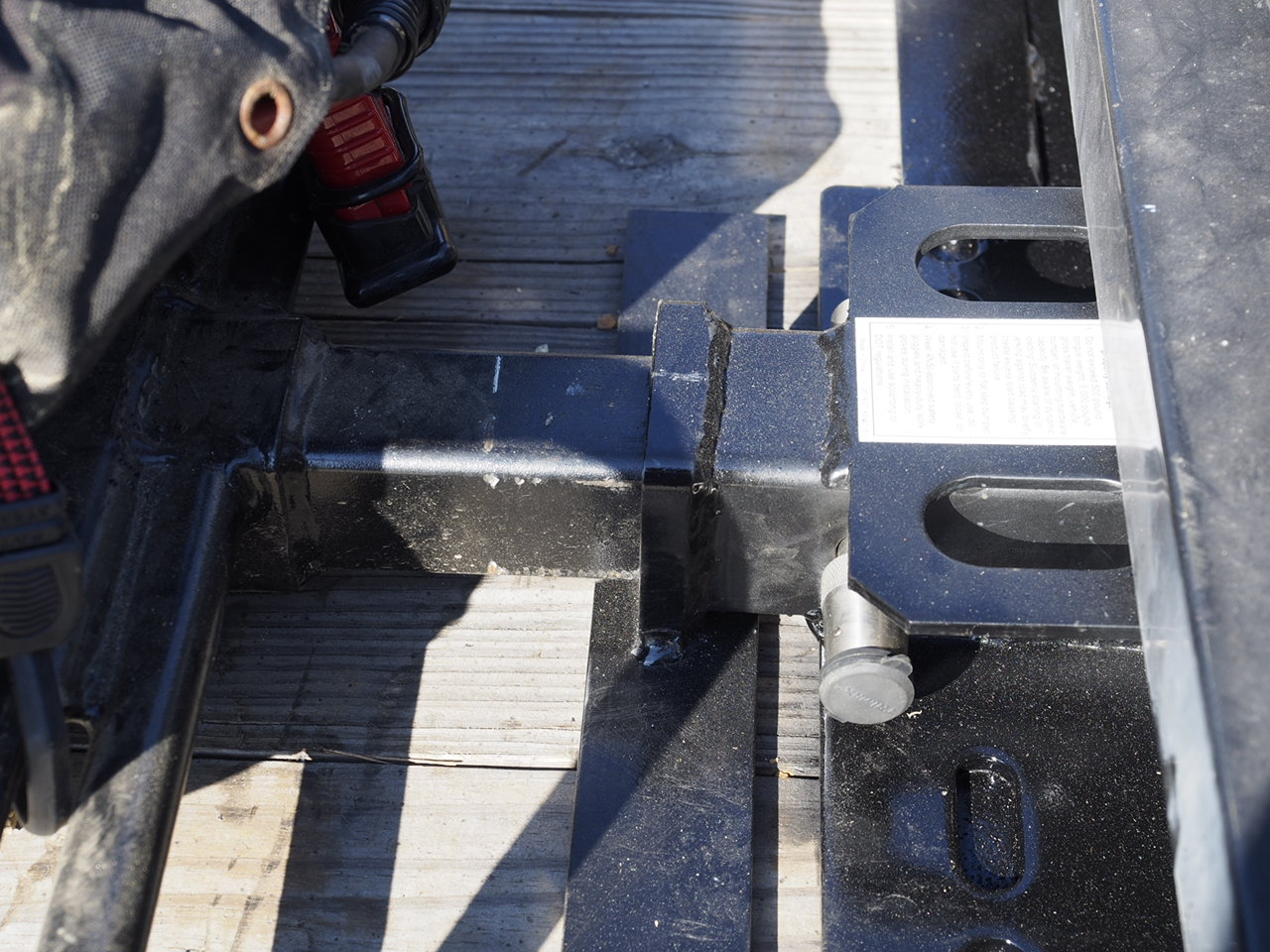

The pintle adapter just drops down into the hitch receiver. The winch will be mounted on the pintle plate:

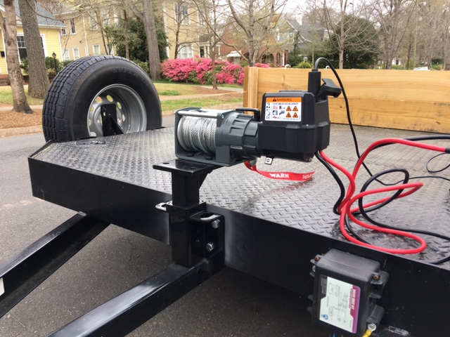

Here is the whole thing in place. Works really well and when the winch is removed there is nothing on my trailer deck and nothing in the way. Winch can be locked in my toolbox or a locking hitch pin can make it secure when in place.
Problems: 1) Ruined a handful of cheap drill bits drilling through the thick pintle plate and took a good 30-40 minutes. No big deal. 2) Pintle adapter is heavy and makes the whole thing heavy. 3) There is still no way to hook the thing up to my truck hitch receiver since it would be oriented wrong if I used the pintle adapter shaft. I will solve this problem with a hitch mount made for winches. It will mount between the winch and the pintle plate. It will have handles (which will help with the awkwardness and a hitch shaft that projects rearward, about $50.
A lot of trouble and expense but it keeps the winch off my trailer deck, makes it removable and able to use it on the back of my truck as well. If I had welding capability Icould have fab'ed up something cheaper but probably not as neat.

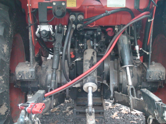

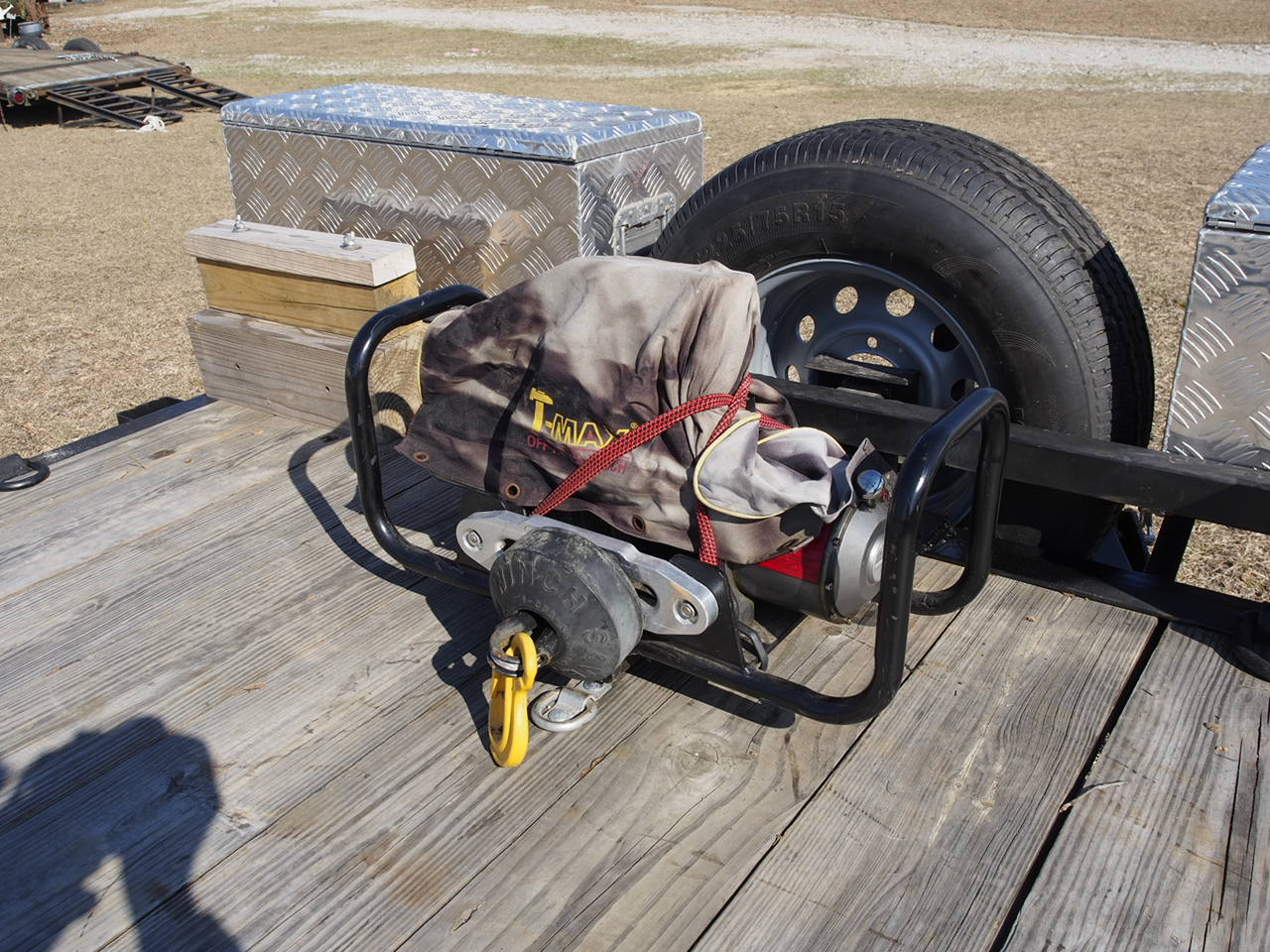

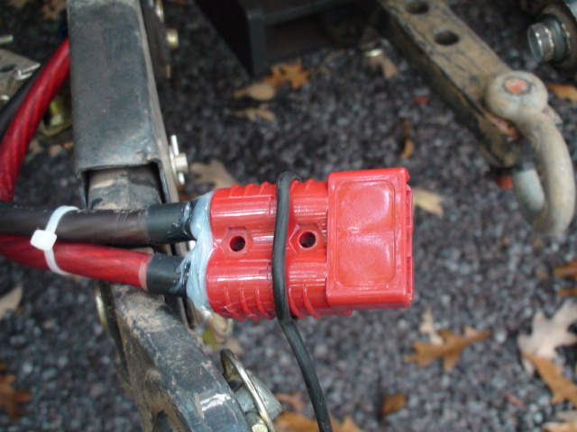

Here is my setup. All of my standard jumper cables are 1 gauge CCA or solid copper 25' in length, with Anderson type QDs on both ends. My truck and Jeep batteries also have mating QDs and winches mounted. And the jumper cable alligator jaws also have QDs. Very flexible setups.
My 20+2 equipment trailer has a 9k# winch in a portable mount. The winch was used recently used to pull an old Ford tractor with low/flat tires that had been sitting in a field for quite awhile. Lots of physical resistance that really tested the 9k# winch setup. Less capable winches would be okay for ideal situations with a rolling load on a hard surface.
I welded a truck step bumper 2" 5000# receiver to the trailer's front structural assembly. I would not consider using less than 2 gauge battery cable and 0 gauge would be better as the available voltage drops the longer the cable is due to wire resistance. And for the most part, the larger the cable diameter the less resistance to current flow.
Added photos of tractor/winch setup. All the same wiring principle.
