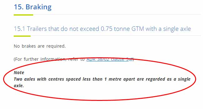

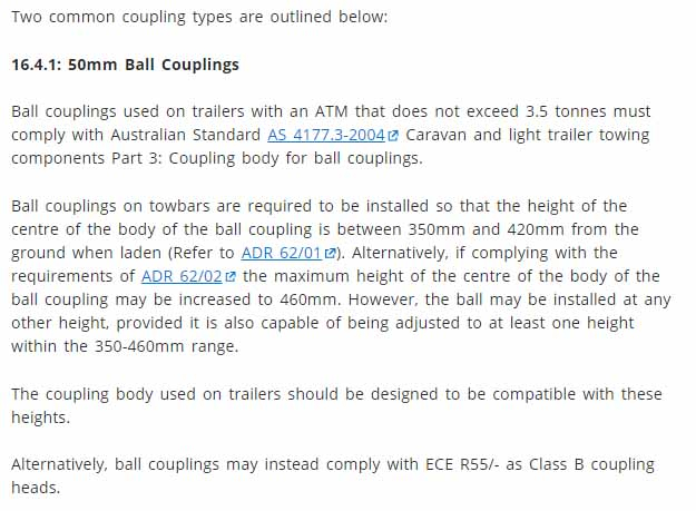

I consider a 1653 lb limit absurd.
Yeah, no mention of the towing vehicle. However - the regs go into great detail with the ball coupling. In the extract below, "ADR" refers to Australian Design Rules.
If you really want to take your head for a spin (definitely not recommended though :sleep:) get in to the full saga: Technical Requirements
Part of that says:
I guess every country has it's fair share of rules and regs...
   / trailer without brakes - max weight #76
A lot of USA trailer would fall under the two axles under a meter apart rule.
   / trailer without brakes - max weight #77
At least Australia understands the importance of having that hitch right at shin level.
