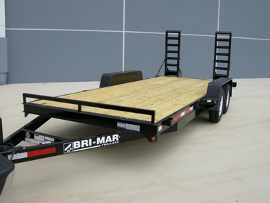

It's this type of trailer... yea or nay?
If you're buying it, I'd get the trailer withoutthe dovetail and nothing less than an 18'.

How about something like this for $3,895:D
10k
18'
5' hd ramps

Don't forgoe the dovetail. You need to lessen the ramp angle to keep from dragging when loading, and it really helps. Only forgoe it if you have another solution, like extra long ramps or tilt.
