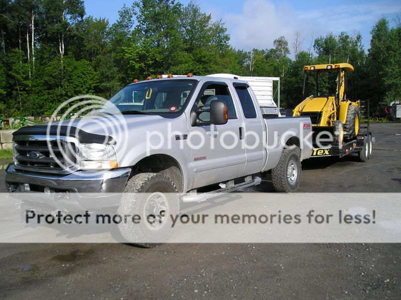

Well, figured I'd post. I hauled this for our local dealer. It's my brother's truck. Hauled it fine, but had to re-adjust load half way there; was getting trailer sway. Machine weighs a bit more than advertised; this one had the thumb and extra parts along with that. I guess around 12k w/ trailer weight? Still a good load!
That's a pretty dang good load and the trailer tires aren't even sagging. Nice setup with quality equipment all the way around!
