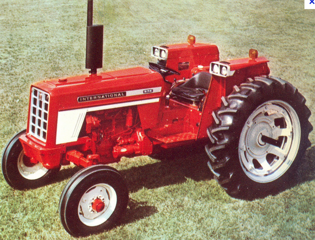

Is this the tractor you are getting
/ Trailering IH 574
Thanks for the replys, Case485 that is just like my tractor, but with shiny paint. My brother checked the tractor out for me and says he is almost positive there is no balast in the tires (tires where put on about 2 yrs ago. That being said, I think yall are right about the truck being near it's max which is not so safe. I would be at roughly 5200 lbs (tractor) + 750 (shredder)+2500 lbs (trailer)+250 lbs (weight hitch, chains, weights)=8700 lbs for the total load. or at 90% of my total capacity and thats with a tongue weight of 1044 lbs at 12% or 1305 lbs at 15%.
