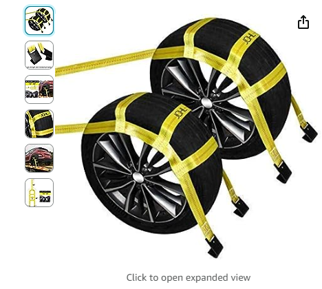

When I ran light-medium duty flatbed wreckers, I almost always used the JTR hooks like nisaacs pictured. Attaching directly to the frame section was always preferred. I would occaisionally have to use the large J-hooks and go to the solid rear axle and lower A-arms on older vehicles (pre-front wheel drive drek-and older trucks, etc). We NEVER ran straps through or over the wheels or tires. Good Gawd. That's just begging for trouble.
When I'm hauling cars for myself or others on my own car trailer, I use axle straps on all 4 corners.
Sounds just like it should, the axle strap portion (on the left in the picture) wraps around an axle or lower A-arm at the corner of the car (or truck). On a classic or exotic car, it limits the chances of chipping paint or finish on something high end.
is there a length of axil strap that you use most often for hauling cars, pickups or CUT's?

Also keep in mind, most states DOT require 4 corner attachment. For me, anytime I was hauling distance it was always 4 chains w/4 binders. There were a few times that I wished i had J hooks, but I always found a place to loop the chain without damaging anything.
I thought over the tire straps were going to be easier/quicker, so I bought a set...nope, they always came loose or shifted requireing a re-do.

Maybe? The problem is there is often something that will get damaged that is attached to the axle such as brake lines or wiring.
As far as sharp edges on wheels, some have them some don’t. In my picture of the Challenger above there aren’t a lot of sharp edges.
I've always been able to run the strap in such a way to avoid it snagging anything it shouldn't. Sometimes you have to study it for a bit to "see" how to run it.

I prefer to strap the wheels or axles down as opposed to stepping the car down. That let's the suspension do its thing & give the car a smoother ride.
Also, if you strap the car down, unless the suspension is totally compressed out, a good bump will cause it to flex. Big jolt when the suspension unflexes. Likely to break straps or other parts, or just have things come loose.
