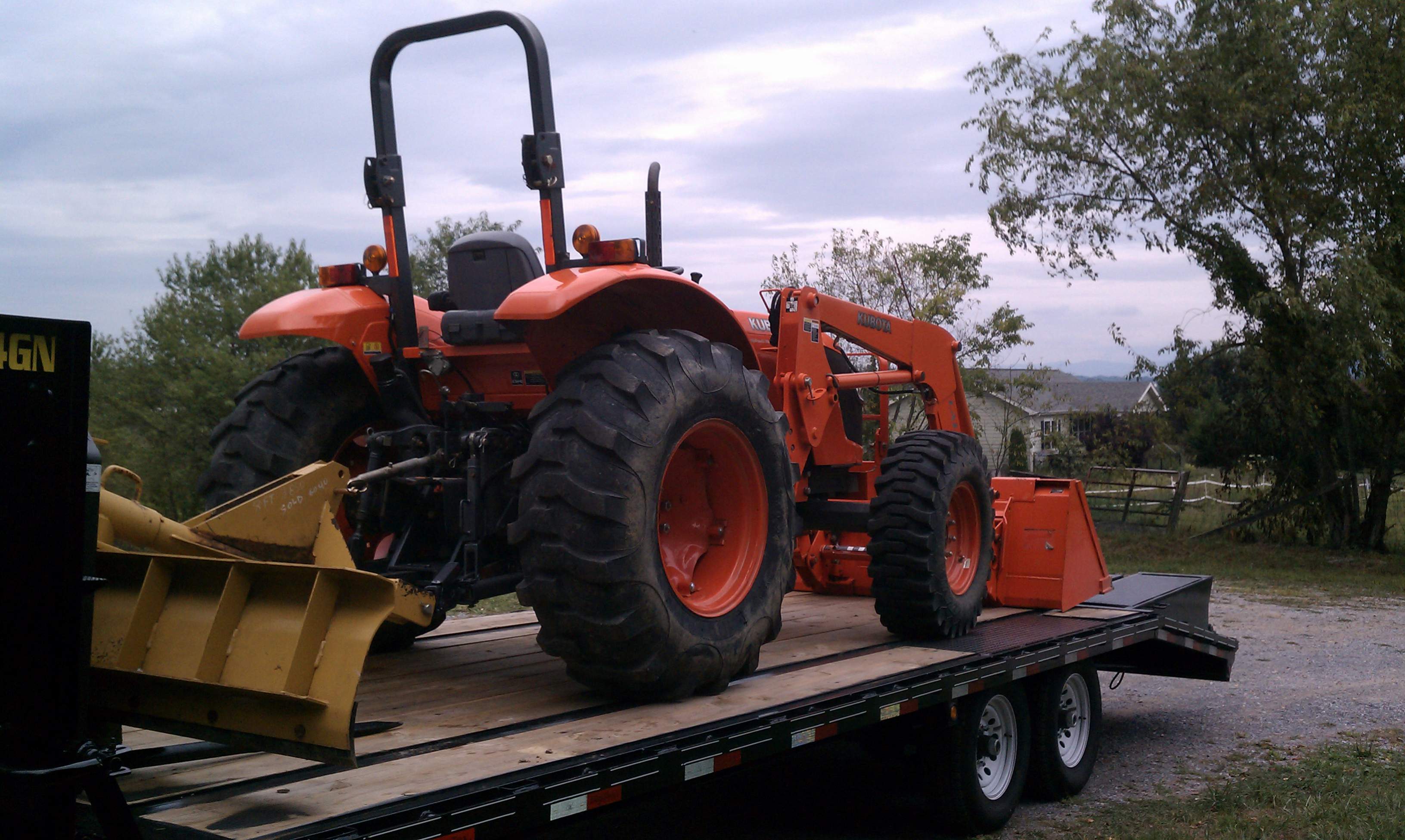

I feel like a newbie. I've pulled trailers most of my life, from 6 x 10 Utility Trailers to 20' equipment trailers to a 33' Travel Trailer. However, they've all been bumper pull. Last year, I bought a Kubota L5740, w/ FEL, and a 7' RC. The overall length of the tractor/RC is about 26' long. Obviously, it won't fit on my 20' trailer. So, here's the quandry. If I want to haul the new tractor, I'm going to need a trailer about 30' long. I'm assuming the better way to go is either with a 5th wheel or GN, not a bumper pull. I know absolutely nothing about these types of trailers. Where do I need to go to learn? Almost all of the larger equipment trailers I see around are GN's. What advantage does a GN have over a 5th wheel?
A little more info about the situation: The tow vehicle is a 2011 F250 4WD, SRW, diesel, with a Leer shell on the bed. I've always used the Leer's to provide a degree of security for treestands and such. It will have to go if a bed hitch is required. The reason for hauling the tractor is to work food plots at hunting land. The land is about 150 miles from home. I currently take a smaller tractor (EX3200) to work the property, but would like to have the flexibility to take the larger tractor. I've even wondered about selling the EX3200 and getting a slightly larger tractor, that would fit on the 20' trailer, just to work at camp.
Any recommendations/thoughts on hauling the 5740 are appreciated.

Is that 26' with your bucket rolled all the way down? I have a Case 485 with FEL and it has a little longer wheeel base than the Kabota. I can haul mine with the bucket rolled all the way down, bumped against the front of my 20' trailer with my 7' shredder and disc legally. you are allowed 4' overhang by DOT. It is also possible to buy 22' and 24' bumper trailers around here, might be worth lookin into? Here are couple of pics, one showing it with the disc on.View attachment 280515
Weight distribution might be an issue, but mine pulls good.Not the best pic to illustrate since I have my forks on the bucket and the bucket is sitting up high, but I can do it with bucket on the trailer floor and be legal...just under the 4' mark overhang.

Sockwell, this is a cut from the Alabama DOT website for their overhang Regs, looks like in the state of Alabama you are allowed 5' of overhang.
No other vehicle operated on a highway shall carry
any load extending more than a total of five feet beyond both the front and rear, inclusive, of the
vehicle
Link to the webiste, see page 4-14 about 1/2 way down
http://www.dot.state.al.us/maweb/doc/Title32Chapter9.pdf

I just bought a 25' gooseneck trailer to haul my Kubota M6040. The trailer has a 20' deck plus a 5' dovetail section. My trailer has flipover ramps that lie flat on the dovetail. If I have the loader and a 7' rotary cutter on the tractor I have to raise the loader and pull forward so that the loader is over the gooseneck, in order to have enough room to lay the ramps on the dovetail. I then back up and put the cutter down on top of the ramps. It all fits, but just barely. The trailer is maxed out at it's 14k capacity with that load. I would be happier if I had some weight capacity left, because I don't like how the tires bulge with the weight. I think the L5740 is a bit lighter than the M6040, but make sure the trailer will have enough capacity for the weight of the tractor plus loader and cutter. You may need airbags on the F-250 to handle the pin weight of the trailer (will probably be at least 20% of the loaded trailer weight, which may be over what the 250 can handle without excessive sagging).
One thing I don't like about my trailer is that the dovetail really drags when you go in or out of a driveway with a steep hill. It's worse because I have an F-350 SRW, which is a couple of inches higher than your F-250. Because of our hilly driveway I have to have the gooseneck sleeve adjusted pretty high so the trailer doesn't pinch on the tailgate or bed rails, which makes the dovetail drag even more. You'll be fine if it's flat where you live, but you may be unhappy if you have steep driveways to negotiate. I think different trailers have different clearances both at the back of the dovetail and also under the gooseneck section, so it pays to investigate more carefully than I did. Some trailers have the axles further apart, which puts the second axle closer to the dovetail, which may help with dragging.
Stability towing the tractor is great with the gooseneck. I towed it 150 miles a couple of weeks ago and couldn't complain at all how it handled.
