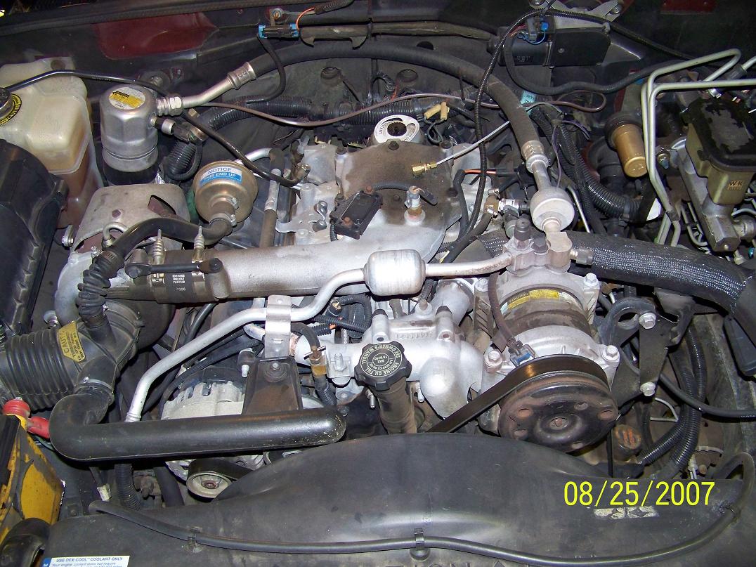

crbr: I can actually see the whole engine. How did that happen? Aren't all modern vehicles supposed to have engines covered under layers of pretty plastic, and be tucked neatly far under the cowl? ;) It looks like you could actually work on that engine yourself. (says I, harumphing, as the owner of a Ford 5.4.....) :)
Honestly, that is an engine that a friend of mine is working on. He's got it torn down to replace a few hoses and gaskets, etc. He enjoys working on his engines to the point of cleanliness and preventative maintenance.

crbr
what the heck happened to that truck in the pic? everything is on the wrong side. All the years ive spent under the hood of a 6.5 thats the first i have seen set up that way. intake is different, brake booster on the wrong side, a/c acumulator on the wrong side, and if thats an S motor tell him to hollow out the cat while he has it apart and have the intake steam cleaned.

workinallthetime said:
crbr
Maybe Its built for south of the Equator?
They do every thing backwards down there.
tom
   / trailering w/ diesel suburban #18
I thought maybe it was reversed in photoshop, but the "caution - fan" is right reading. Must be an Aussie vehicle?
jb
   / trailering w/ diesel suburban #19
if it has a turbo it would have to be engine mounted not manifold mounted, i have only seen engine mounted turbo's on postal P chasis, also the recovery bottle for the coolant is odd. the intake tube is what really stands out to me though.
   / trailering w/ diesel suburban #20
I read that was a picture of an Australian truck (left hand drive postion). It is the Van and or Hummer engine. The heads on those are different they have different intake V angle and the turbo is center mount. Short block is the same.

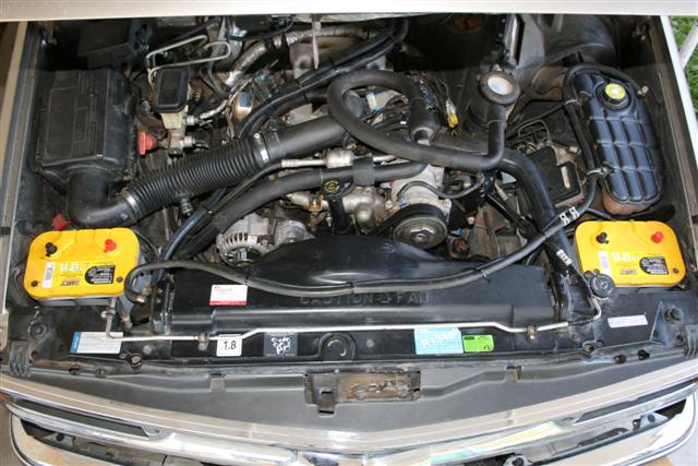

Here is a pic of a Truck/SUV 6.5 engine. Its all realative. Its tight but lots of avg joes can work on them (I've changed injectors and glowplugs) maybe easier than the Fords but its not roomy by any means.
