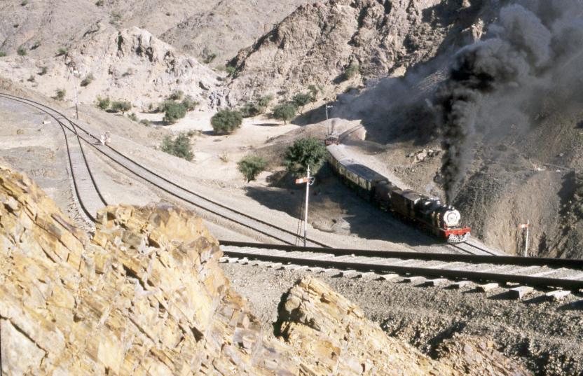

Runaway train track in Pakistan.
Logic is Variable: Khyber Pass Railway
