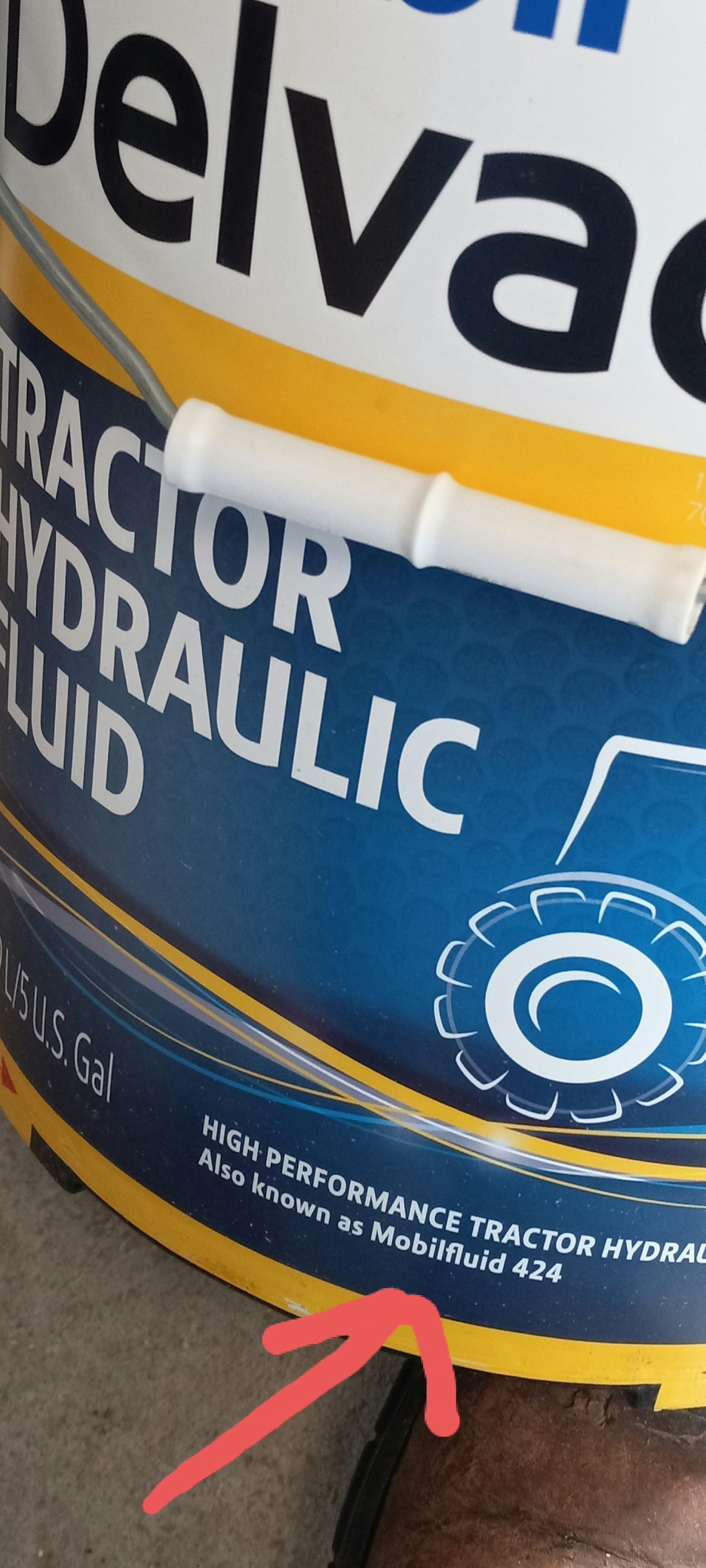

Supposedly that's the same as Mobil 424, which was fine for my application.
   / Trans hydraulic fluid #25
It is. I thought maybe it was different than 424 but then I noticed a small band of writing near the bottom that said formerly know as 424 or something along those lines. I meant to take a picture and share but keep forgetting
   / Trans hydraulic fluid #26
I got a picture of the writing on the Delvac bucket.
   / Trans hydraulic fluid #27
