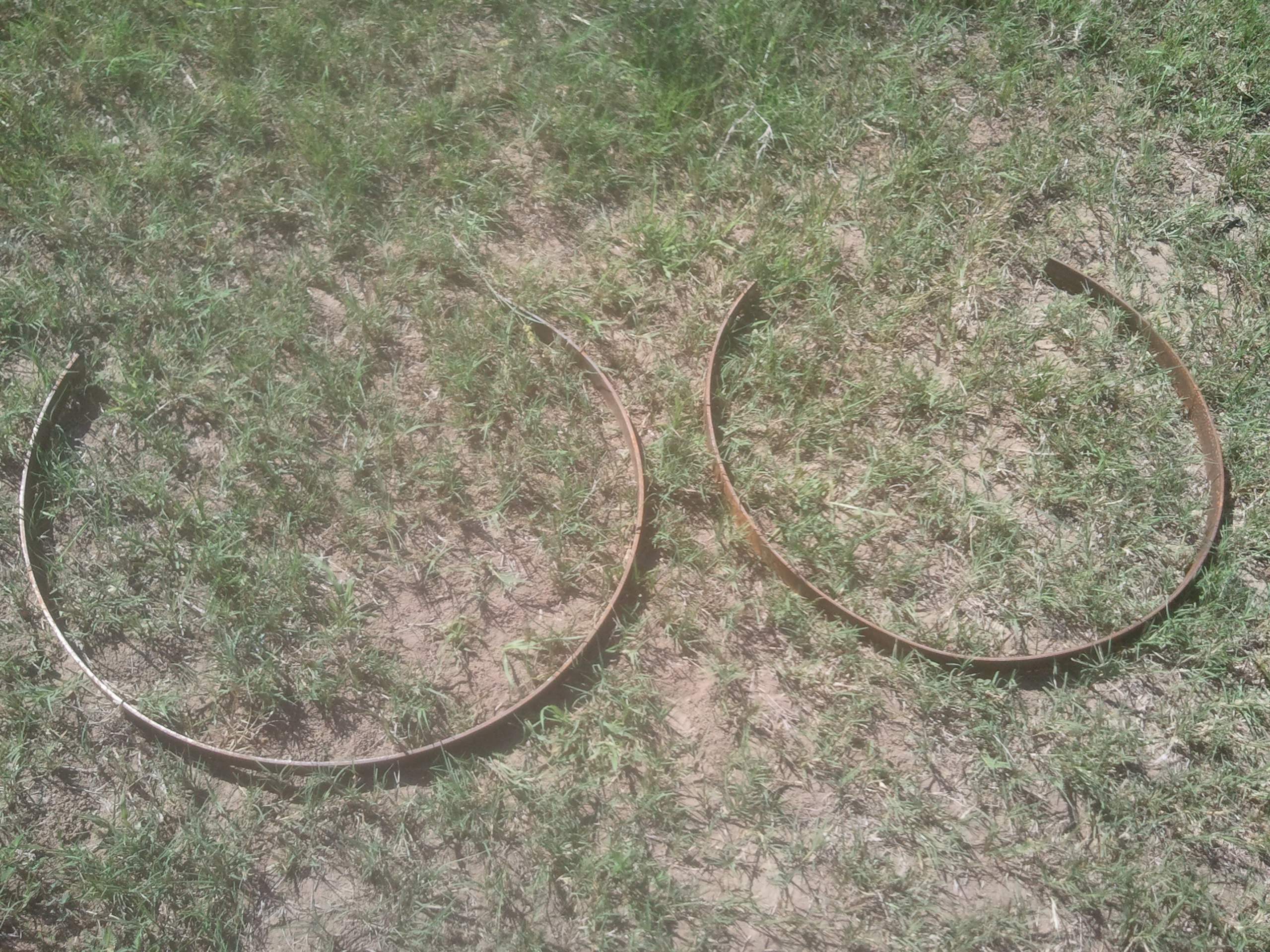

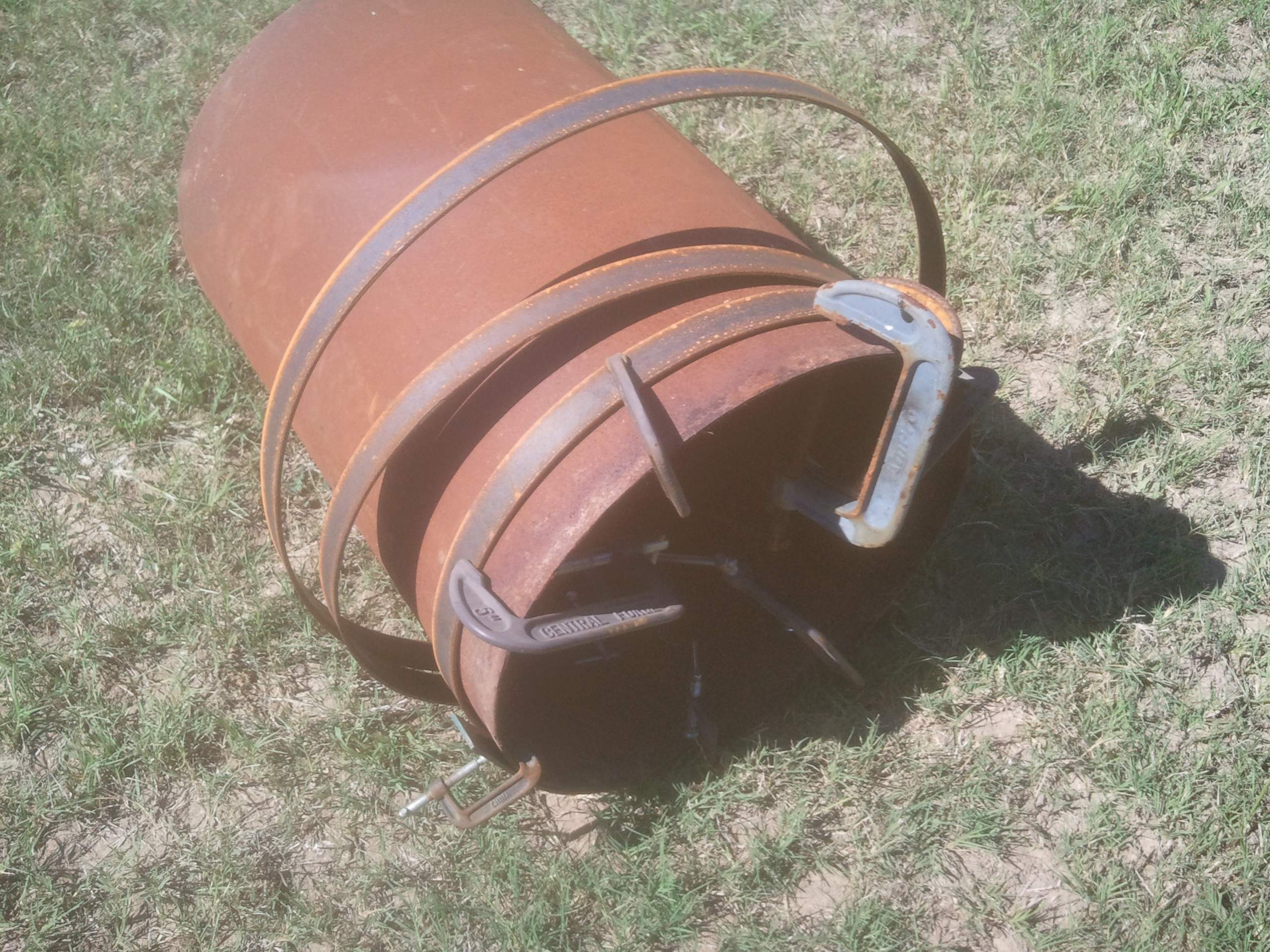

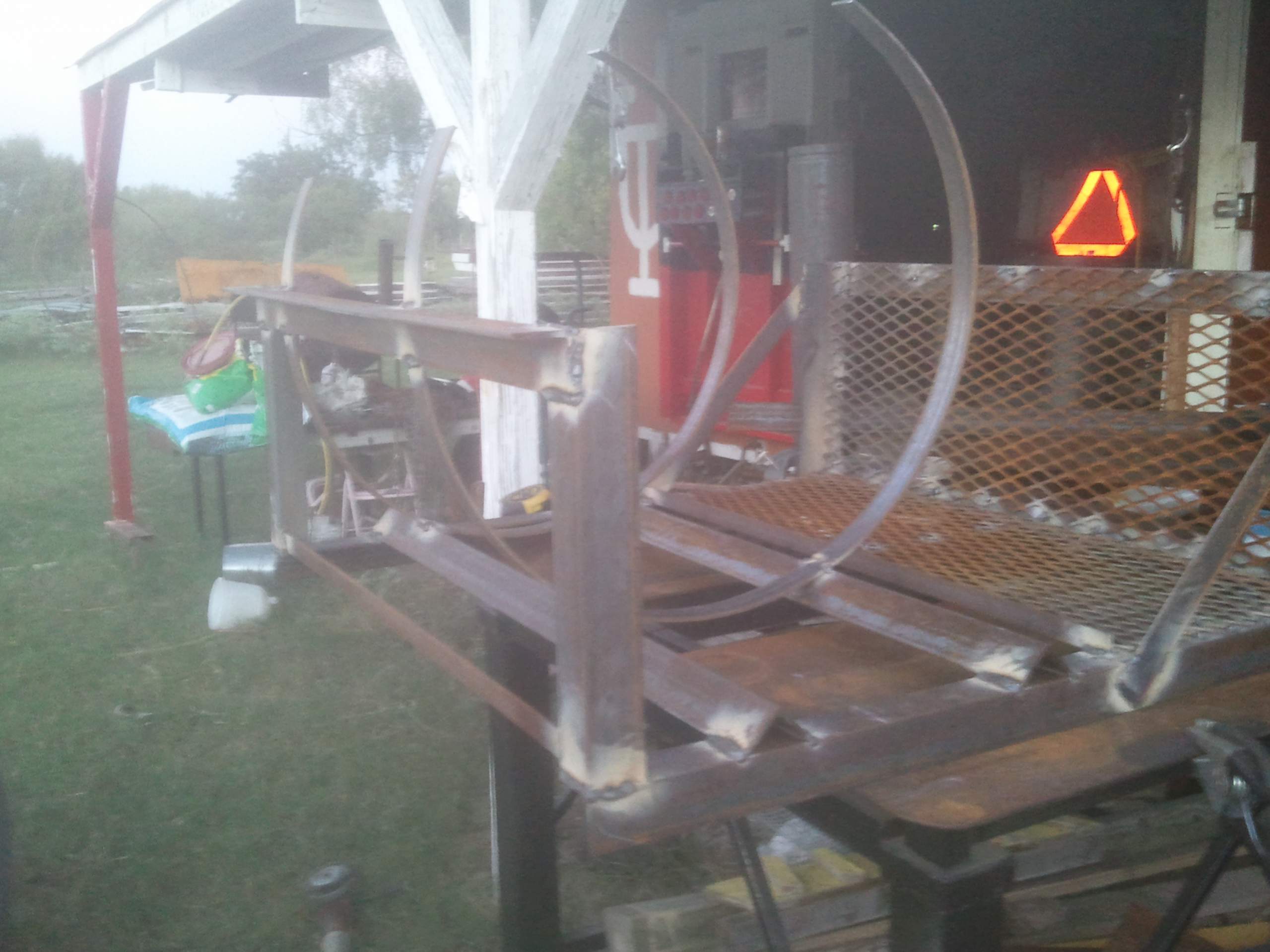

I took a piece of flat and wrapped around a piece of pipe bout the size of the tank to make the straps.

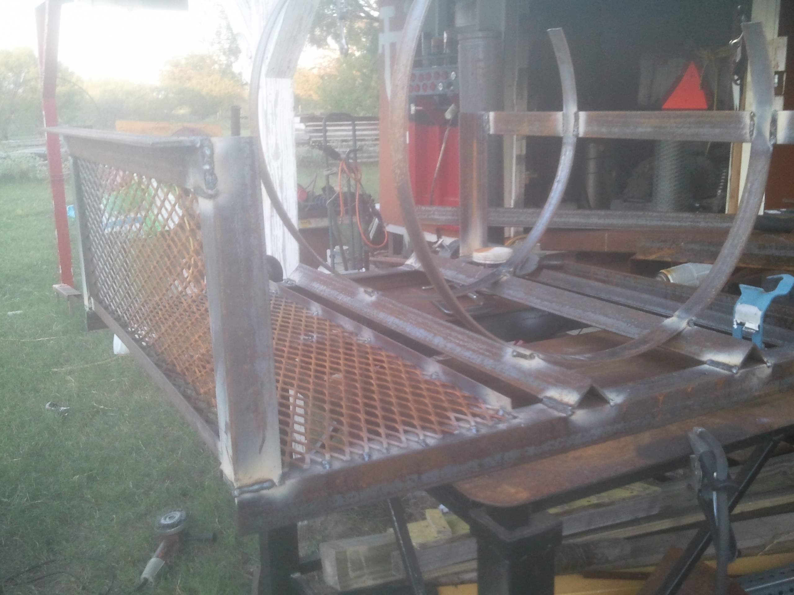

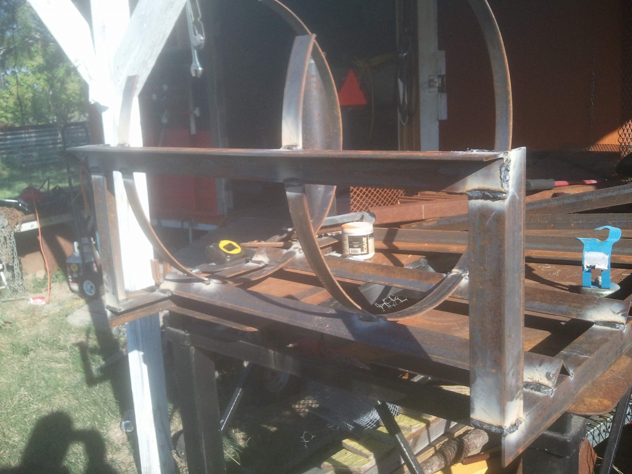

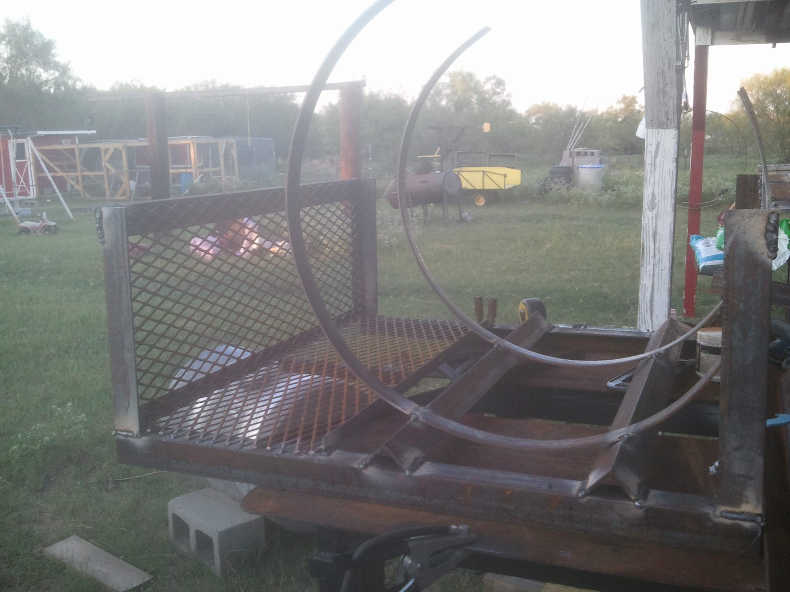

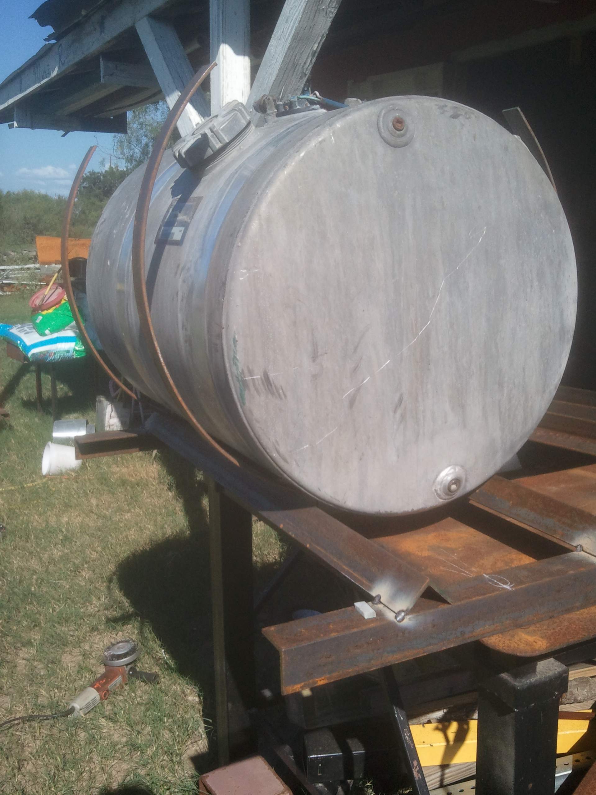

Some more pics of the skid for the tank.

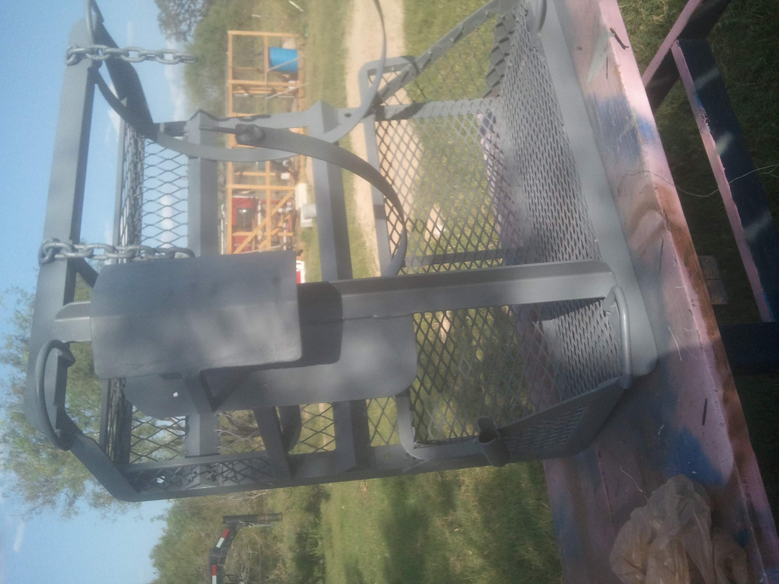

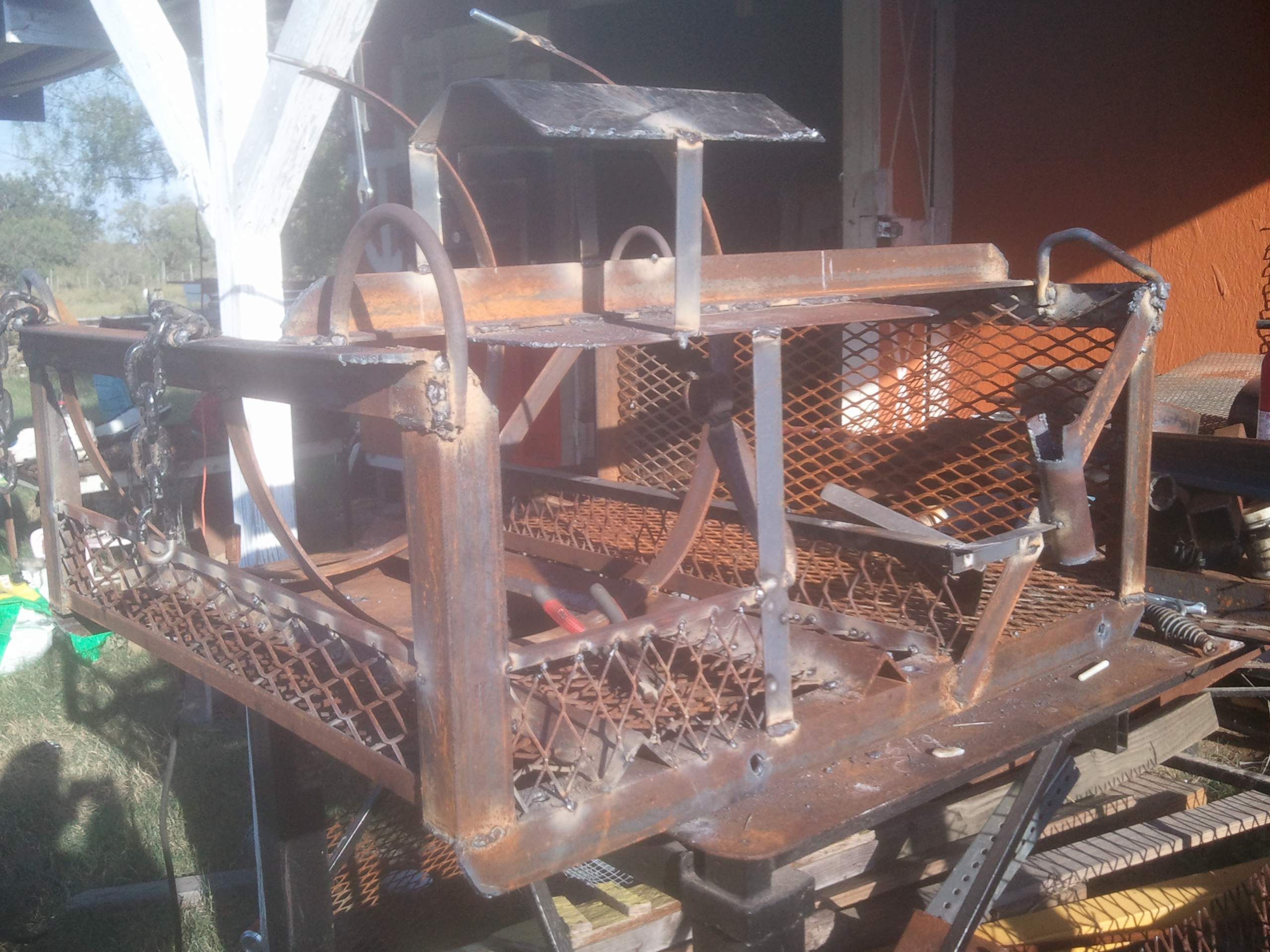

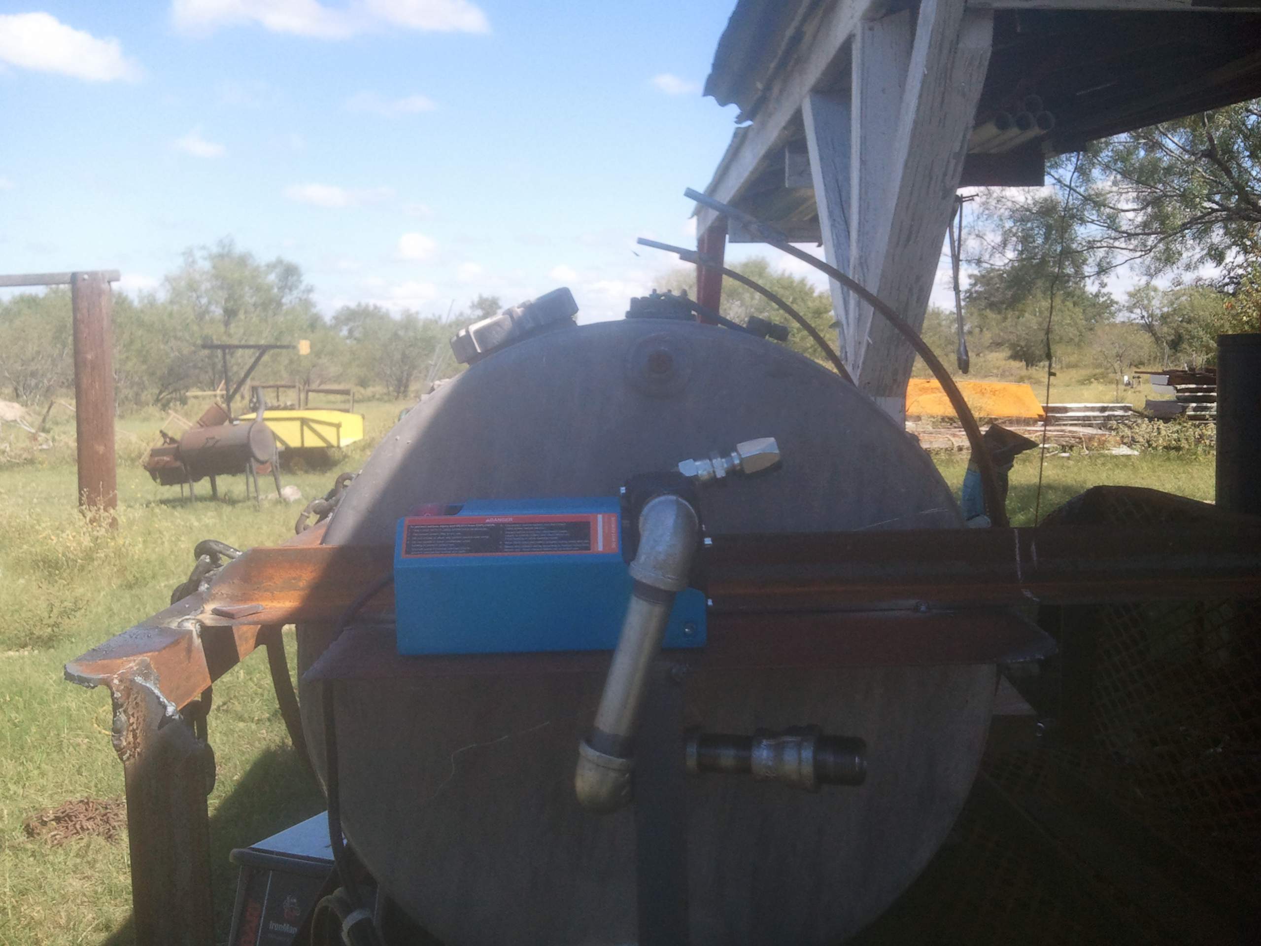

Update. Got a bit more done.
1st pic - trying to figure out pump placement.
2nd pic -you can see lifting points, nozzle holder, shelves, straps with part of turn buckles welded on, chains to hook to other end of turn buckles, brace for holding pipe with fuel filter mounting base, and some bad welds.
3rd pic - we got it grinded, wire wheeled, and primed right before storm came in.
We still need to finish painting and clean aluminum fuel tank before mounting. Also need to make sure we put something between aluminum tank and metal straps or the steel will rot out the aluminum if my memory serves me correct.
   / Transfer Tank #39
You have me looking for an aluminum truck tank. Nice work.
   / Transfer Tank
#40
It is really the way to go. If you have a big truck salvage near you then you can end up with a tank that will not rust and have a larger or same fuel capacity for less money.
