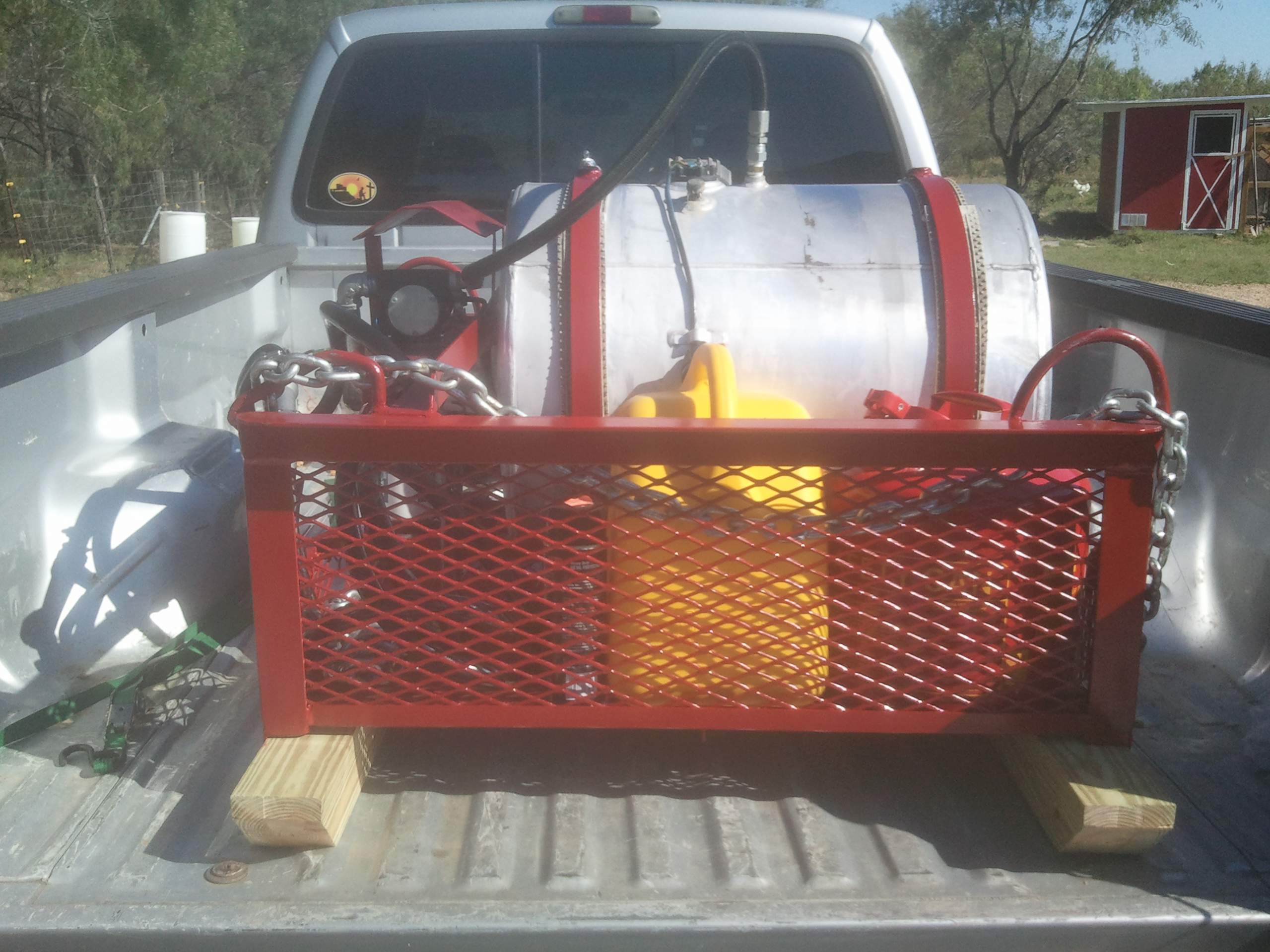

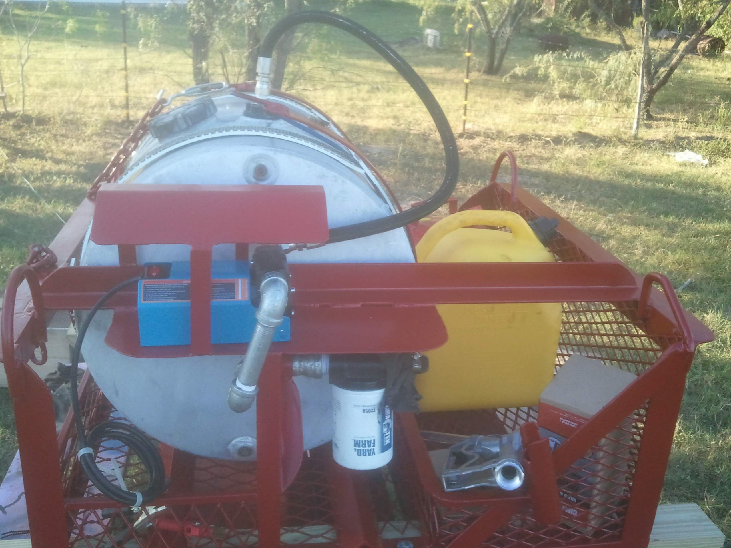

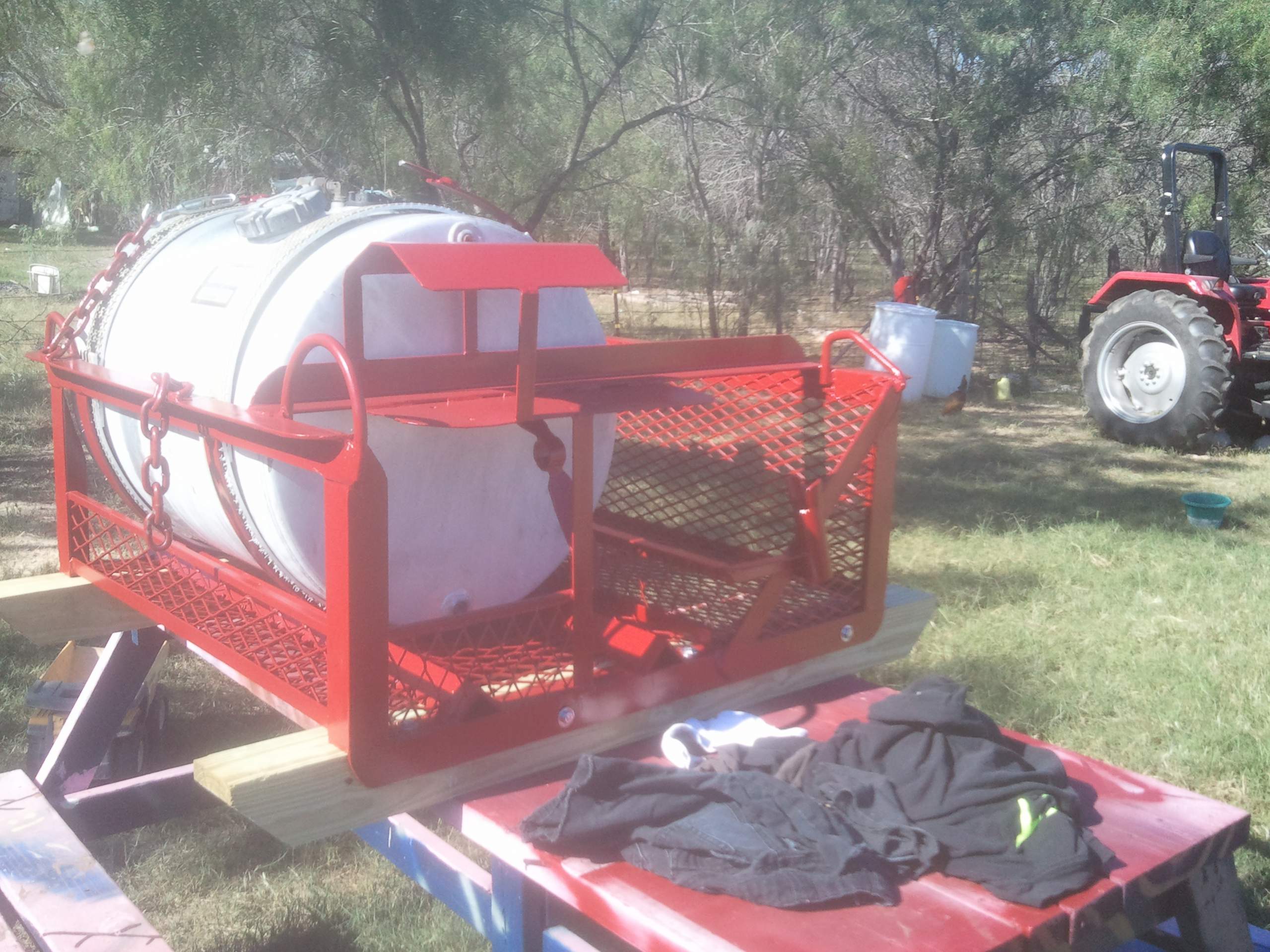

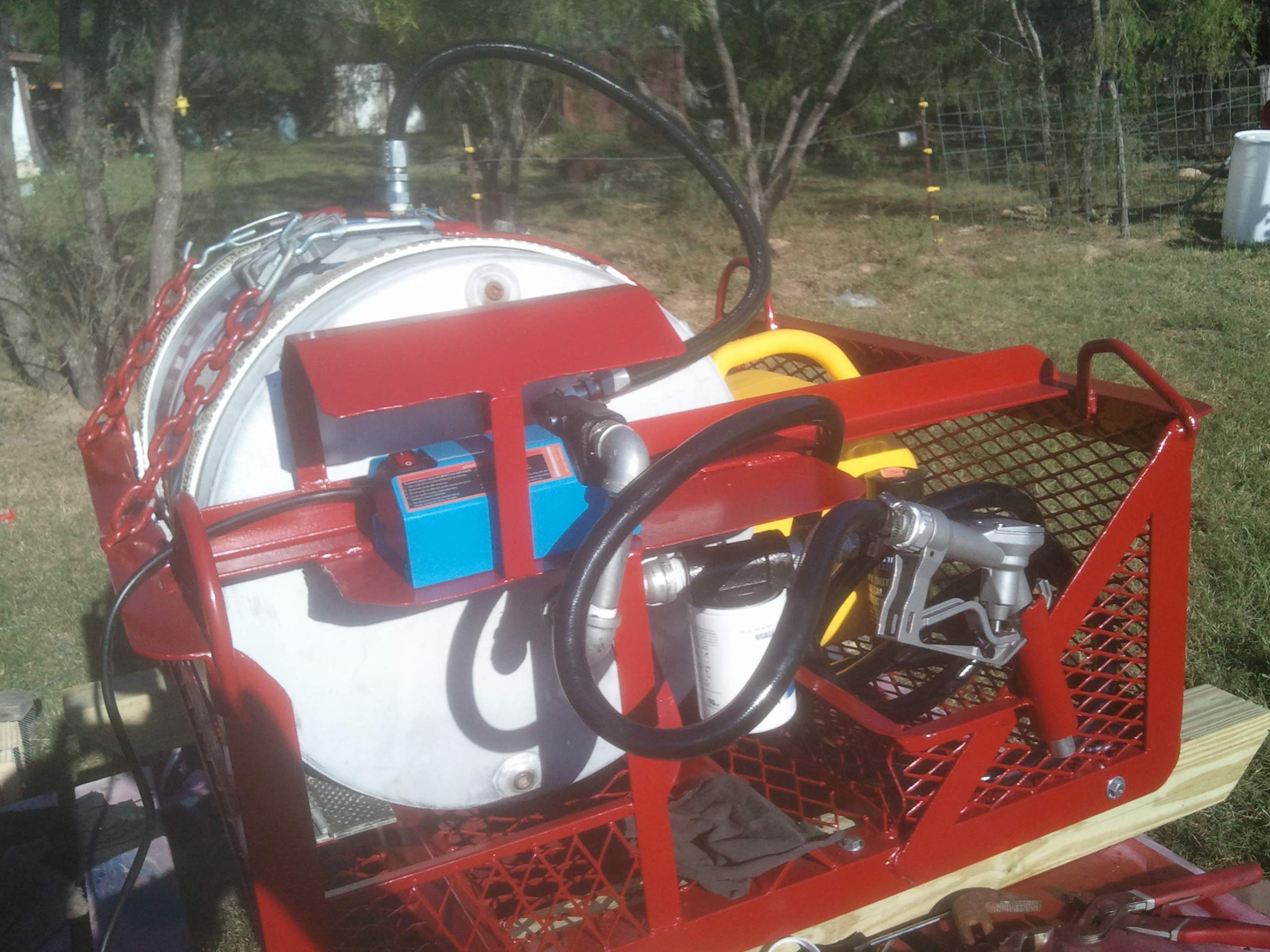

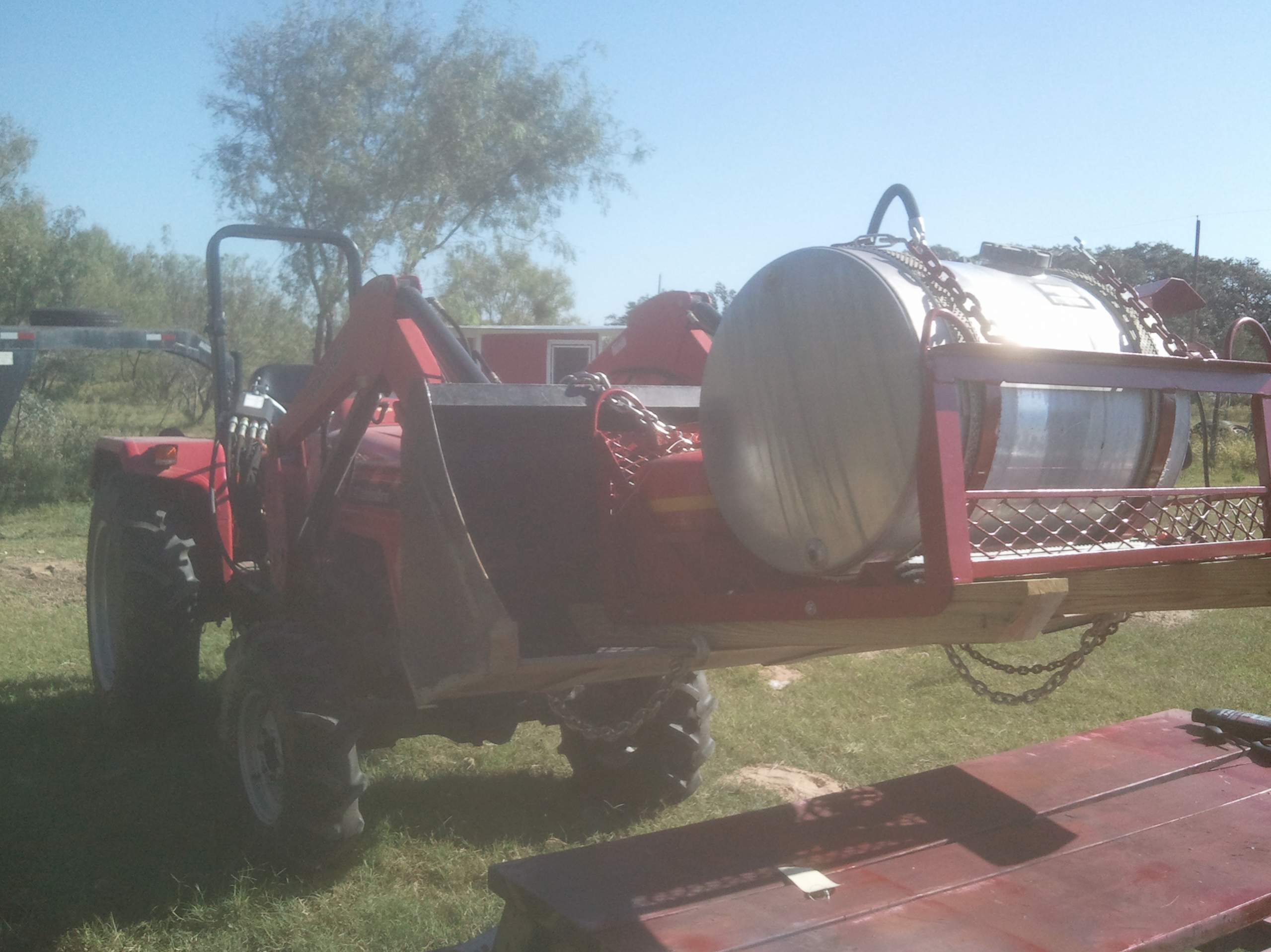

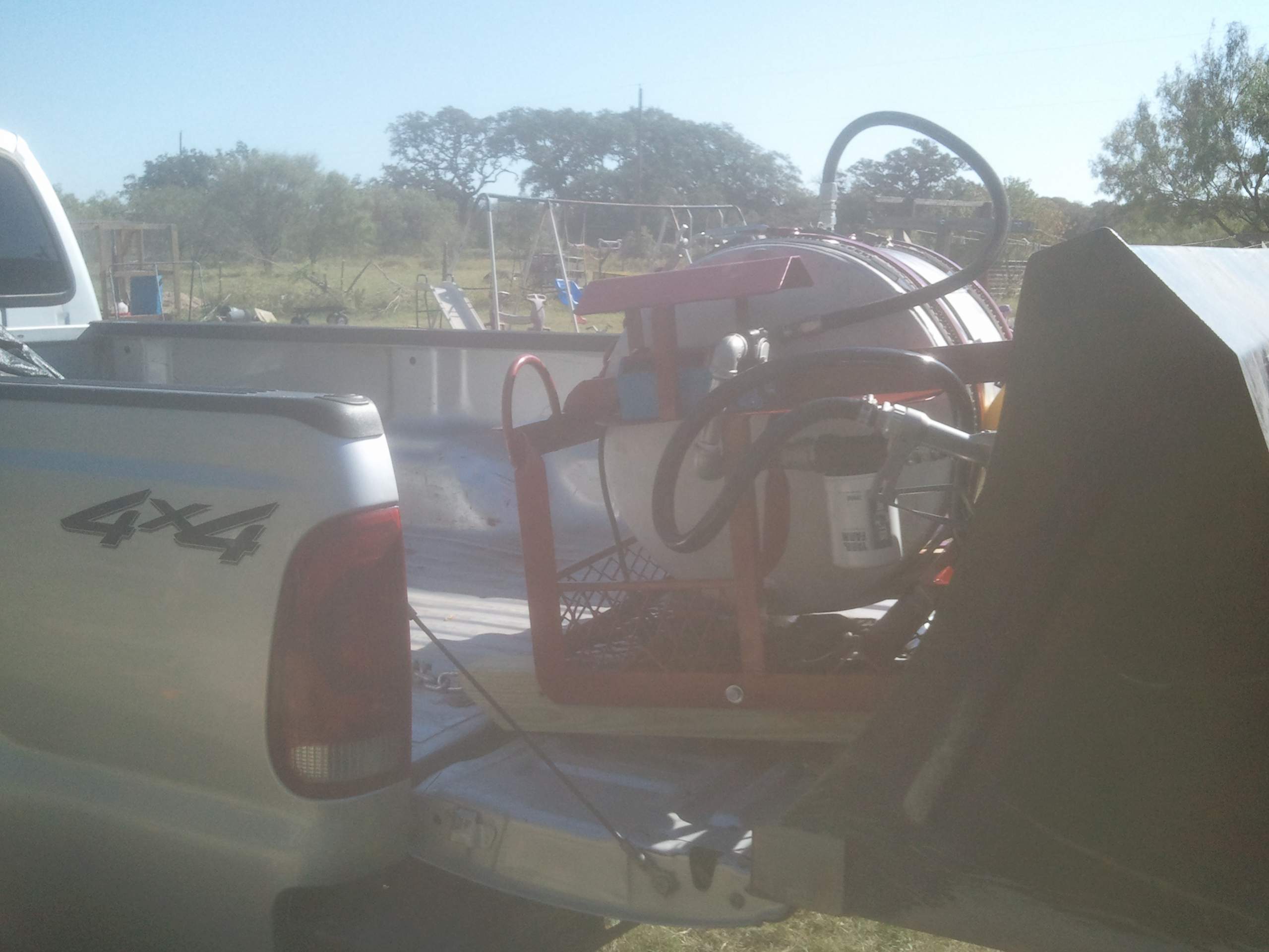

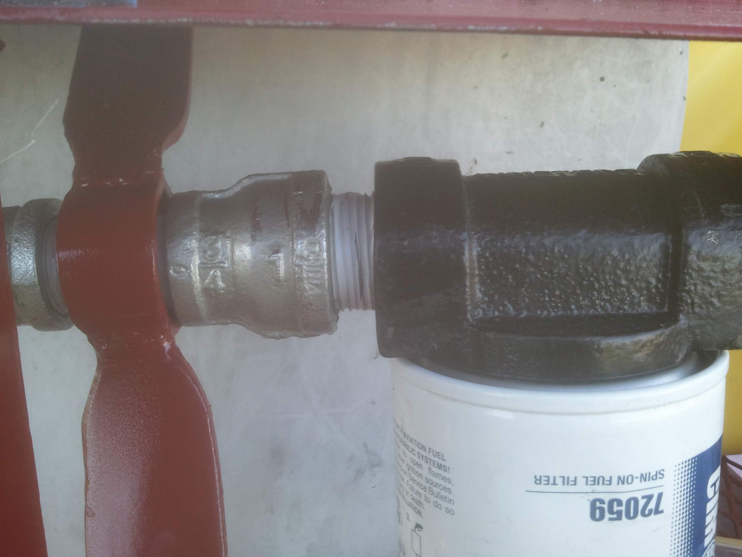

Well here it is. Not the best lookin set up, but fully functional and painted red to match the tractor.
1st pic - is tank sitting on skid. I also put treated 4x4s under it so I can set it on ground and do not have to worry about the steel rusting out.
2nd pic - pump mounted and plumbed. Notice fuel can behind tank. There is enough room I can put three 5 gallon fuel cans back there.
3rd pic - filter house bracing. I put this here to keep filter from sagging.
4th pic - complete unit.
5th pic - putting it in back of pick up.
6th pic - ready to be filled up, but first we will have to sit on the street corner and take fuel donations.
7th pic - right before we put it in back of F250 and scratched the new paint on it.... :eek:

I would find some type of rubber covering for that fuel nozzle. Nothing attracts dirt like diesel fuel.
   / Transfer Tank
#47
Very nice...
Thanx!..... Good idea.
   / Transfer Tank #48
Very nice...
I used a 4" long piece of white PVC pipe with a cap glued on one end. It fits nice and tight.

Someone asked or I guess I could say sent me a PM about the pump I used so I thought I would put the link here > Harbor Freight Pump.
