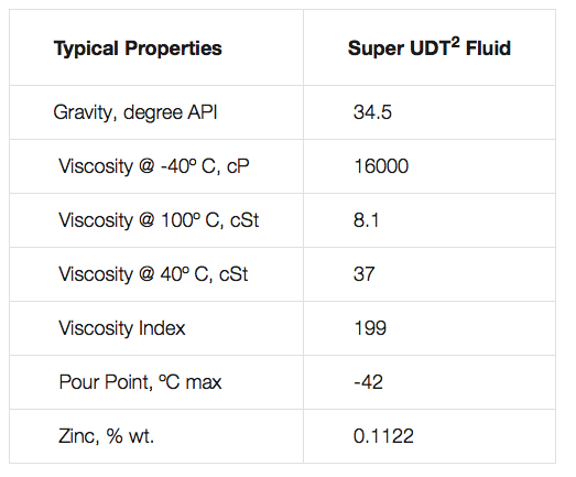

Finally found this:
https://www.kubotausa.com/parts/kubota-parts-products/lubricants
   / Transmission fluid #20
One thing I can say, is that they SUDT2 has a very good viscosity index 199, just a little better than Klondike's full synthetic Arctic grade 191 and a fair bit better that the regular full synthetic 161. However, it's pour point and -40 cP is a mediocre -42 and 16,000 respectively, which is surprising given its high viscosity index.
It is generally slightly more viscous oil than the Klondike also.
