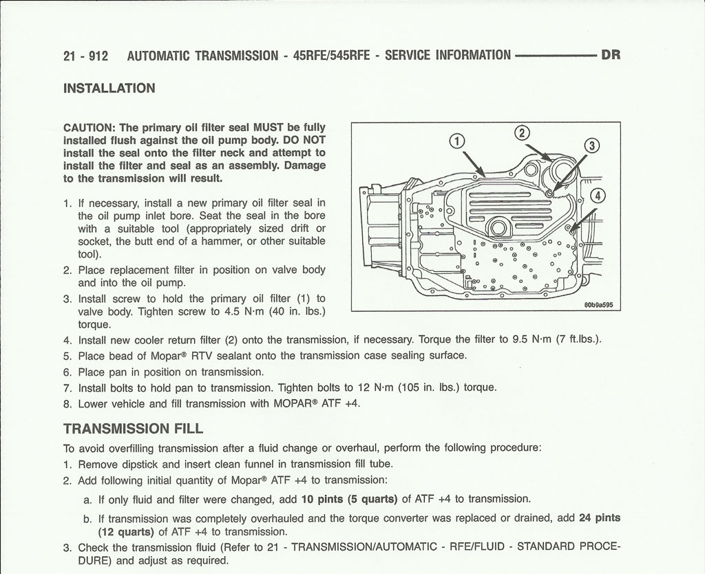

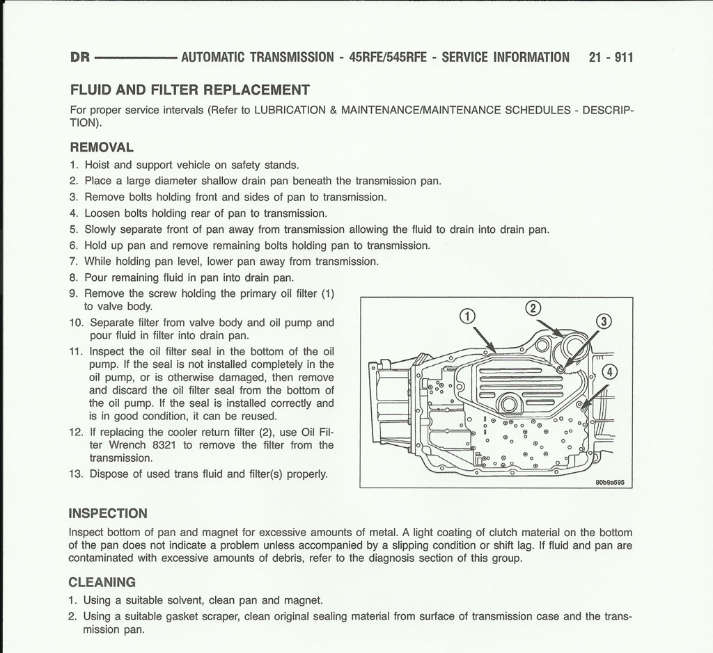

I have no dog in this fight as I do both "change" and "flush" depending upon the circumstances. But in reviewing the 9267 page FACTORY service manual for Dodge trucks which includes the 5 speed transmissions, the attached is the ONLY reference to servicing the transmission. Of course in order to further confuse the situation, MOPAR refers to this procedure as Fluid and Filter Replacement.
Note lines (2) a & b under the Transmission Fill paragraph. To me it suggests a standard fluid replacement is pan only.
Make you own judgement on what they are suggesting.
