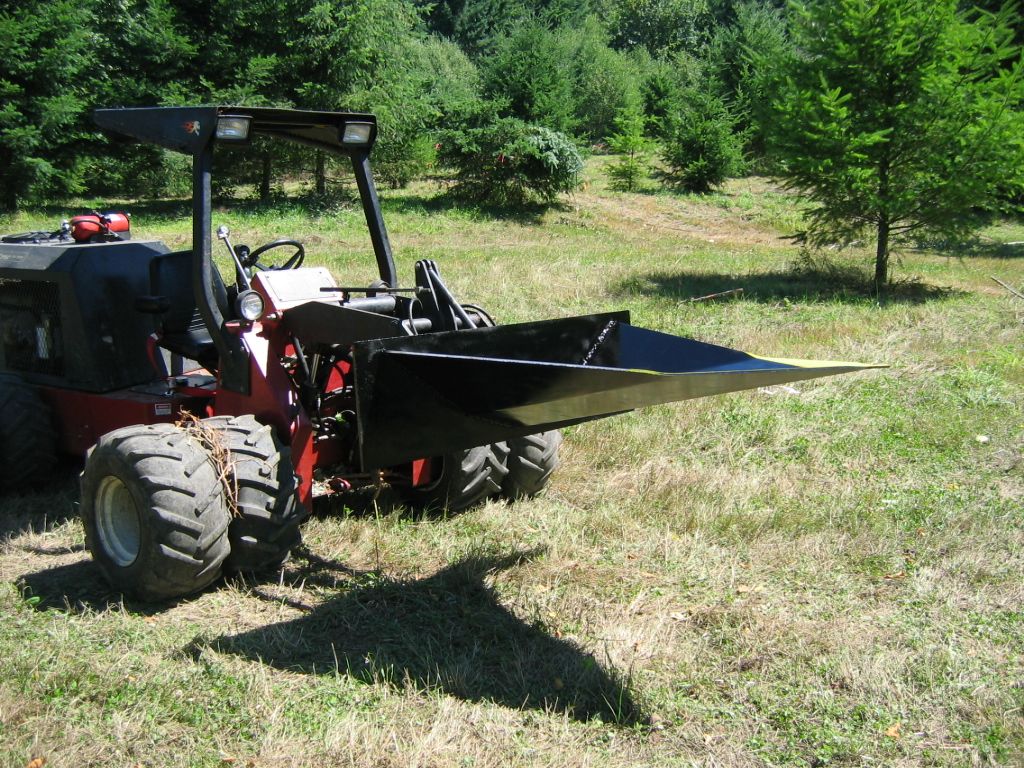

I would like to transplant some trees, they are about 3-4" in diameter.
My question is, is it alright to use a backhoe or should i go rent a tree spade for about $250 a day.

I'm a Landscape Architect, and we frequently use tree spade companies on our projects.
I know very little actually, but do know a few general concepts in the tree spade industry.
- Even a nursery grown well groomed tree with all the proper treatments (including microrihza and other bio treatments) only has an 80% success rate.
- Wild grown trees are very sensative. Some do much better than others. Maples are one of the safer bets. But as a whole, it is a 40 / 60 success rate.
- Trees in the 2-3" range are much more successful than anything larger.
- The main culprit in killing spade trees is air pockets. This is why common practice is to water in very well with sand. It is also why a spade that can dig a perfect hole is more successful. I would think a backhoe could lead to more air pockets.
Hope all that helps some.
In the end, if you have a large supply of free trees and already own the backhoe, why not try it. ;)

Go with the tree spade as you will not damage as many roots. I'd say from past experiece a 18" backhoe bucket will kill that tree, lucky if a 25" would do it!
   / Transplanting trees?????? #6
A 36" bucket works pretty good..... but you only get 1 chance to scoop it! Best be soft soil or you will be looking for a different tree.

The experienced tree spaders I have talked to will tell you that your 4 inchers are too big and your threes are pushing the limit. It takes on of those truck sized spades and a lot of skill to transplant anything 4 inches or over.
Take a look at a Bobcat "Digger" or similar. It's designed to root prune and transplant -- but 2 - 2-1/2 inch is the largest I would tackle with it.
   / Transplanting trees?????? #9
A 4" tree will need at least a 40" root ball.
