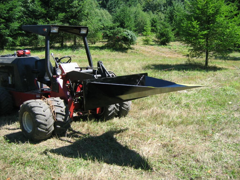

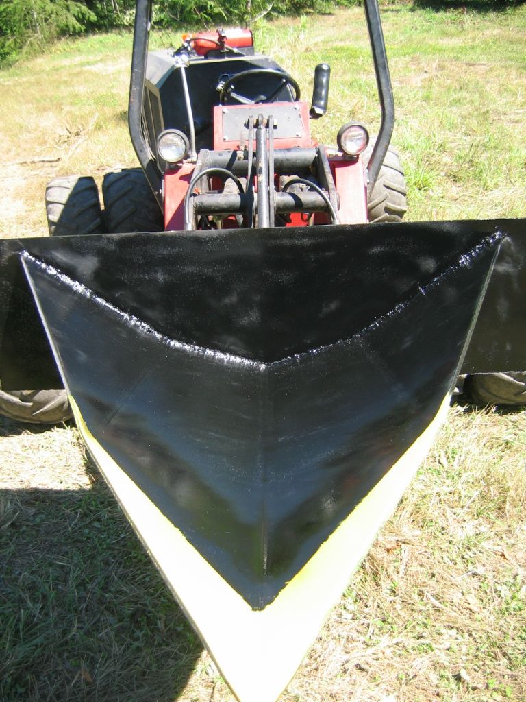

I built this spade for my PT. It has only 1100 lbs of lift. The spade cost me around $400 or so to make....
We tried it out this summer, knowing that we would have a very limited success rate with it. And yes, pretty much well everything died. Last winter we transplanted a few 4" trees and had 100% success. Timing is everything. We will again move some trees this winter...
I would love to have areal spade, but my tractor cannot handle the weight, and my wallet is earmarked for other things...

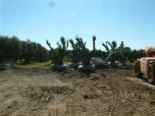

A neighbor is harvesting 100-year-old olive trees and selling them for landscaping.
He gets them out of the ground using bobcats, backhoes and a big transporter thing (on the right side of the photo).
Don't know what he gets for these babies, but my guess would be around $5K each installed.
