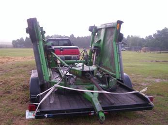

jdmower.jpgi've moved a 15' jd151 batwong mower on a 16' car hauler before.
we folde dhte deck and backed it on.
if i had to do it over again.. I'd just have pulled the ball on my truck and use dhte drawbar for m the mower with a pin.. like the tractor pulls it and roaded it..e tc.
to guess on width.. 1/3 times total width.. plus a lil. if you guess 6' for the center panel and a lil deck fold overhand on ech side i think you will be fine.
i didn't think i had a pic of the mower ont he trailer.. but i found one.
