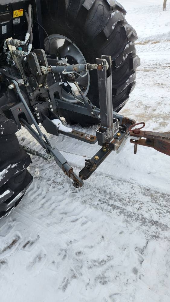

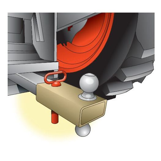

That's pretty much what in mind and described earlier. But I probably wouldn't trust a pin to hold the receiver in place.
Why not? The pin to hold the assembly to the drawbar is far bigger than the pin to hold an insert into a receiver.
