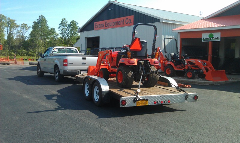

Here's a friend's BX2660 I picked up for them:

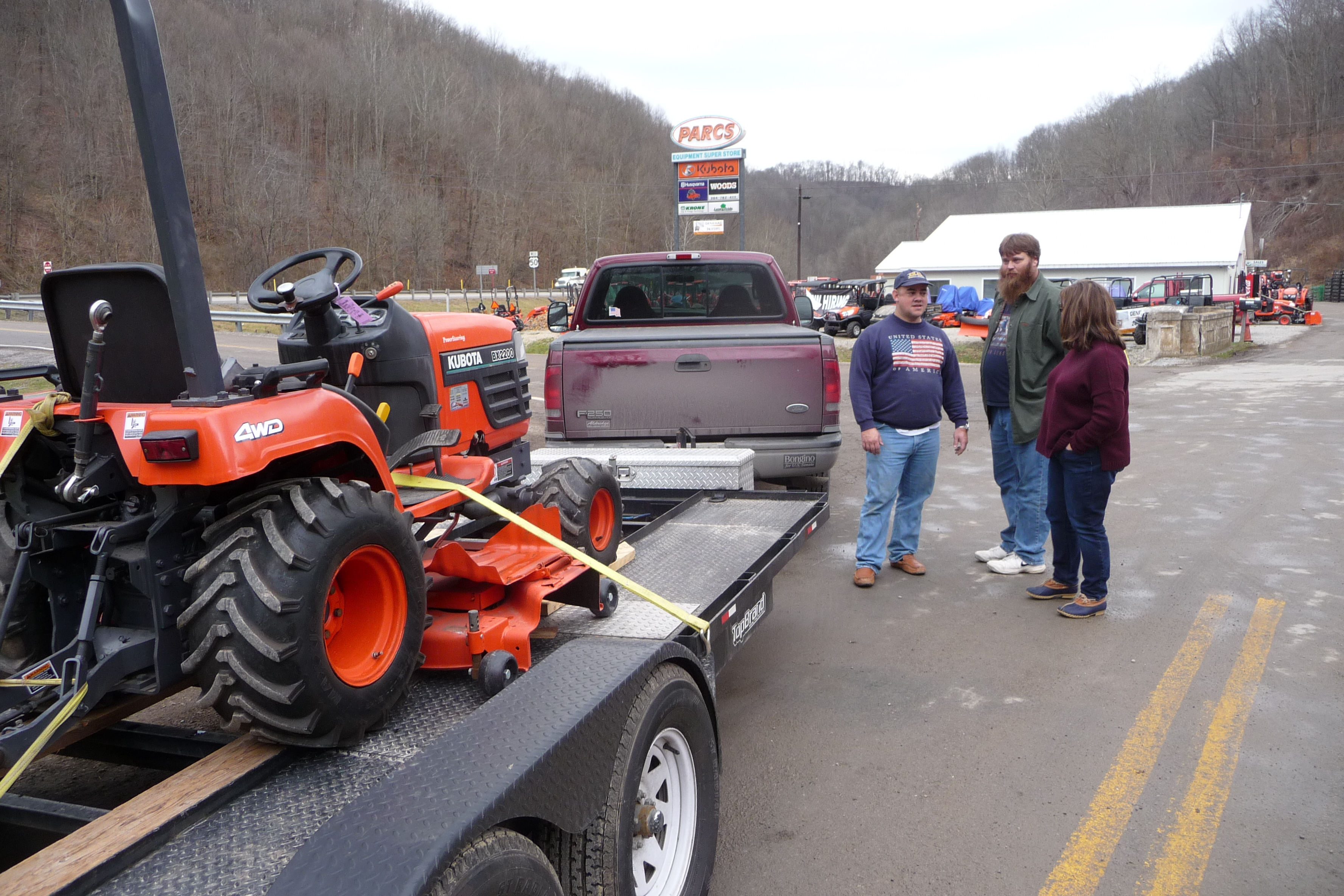

This was a BX2200 loaded on a car carrier trailer (which I do not prefer at all...) but you cansee where I put the straps. There is no logic for caring one way or the other whether you back it on versus drive it on so long as you pay attention to tongue load. No matter the type of trailer or load I always measure from the bottom of the ball hitch threads to the ground before loading and then move my load forward until I get around 4" of hunker down of the truck. Of course that varies with the trailer and the load but you get the idea. With a 3/4 ton truck, 4wd you have stiffer rear truck springs and may or may not get 4" of trunck hunker down. Just make sure you have plenty of positive tongue weight. It will fishtail badly if you don't.

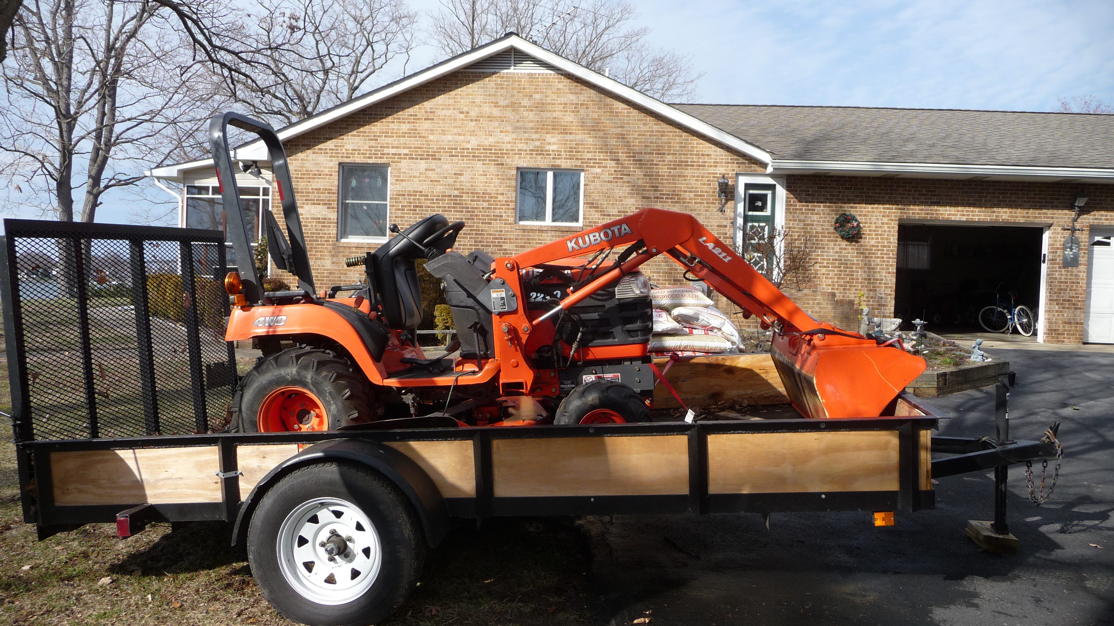

This is a B2150 loaded on a 6.5x12 2 wheel trailer. Little overkill with the big chain behind but I consider the MAIN role of the tie downs to be keeping that tractor from running on to the truck in a collision.

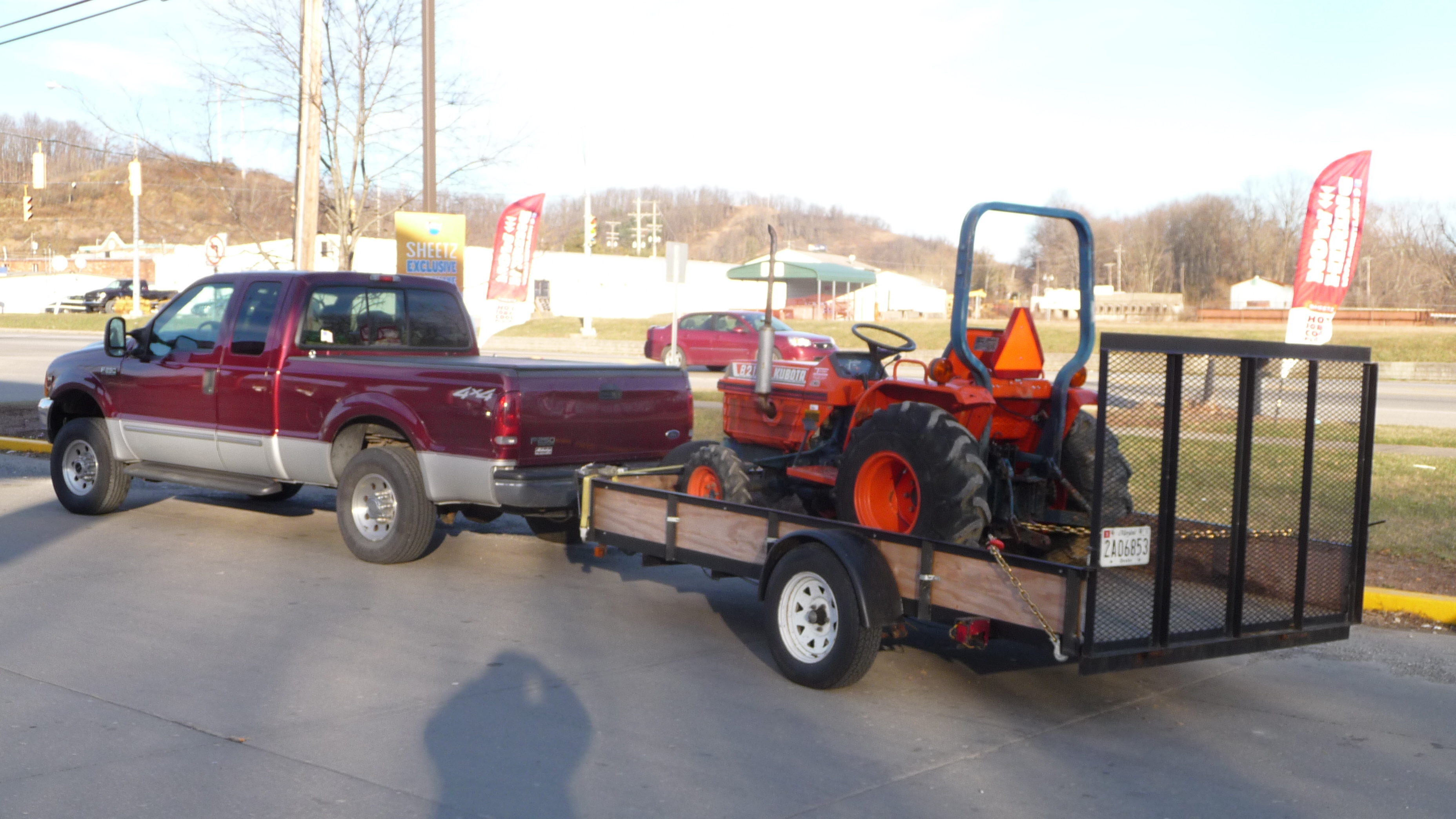

Here is BX2230 I hauled to a guy around 100 miles away in the Wash DC area. This is that same 6.5x12 trailer (which I had nursed back to useful life after it had been discarded by a landscaper.) In this picture I had not yet tied down the tractor. When I did it was with a very heavy strap in the rear attached to the tractor frame and another in front across the bucket and loader frame. Note i have plenty of tongue weight but it is pulled on forward. Zero problems.

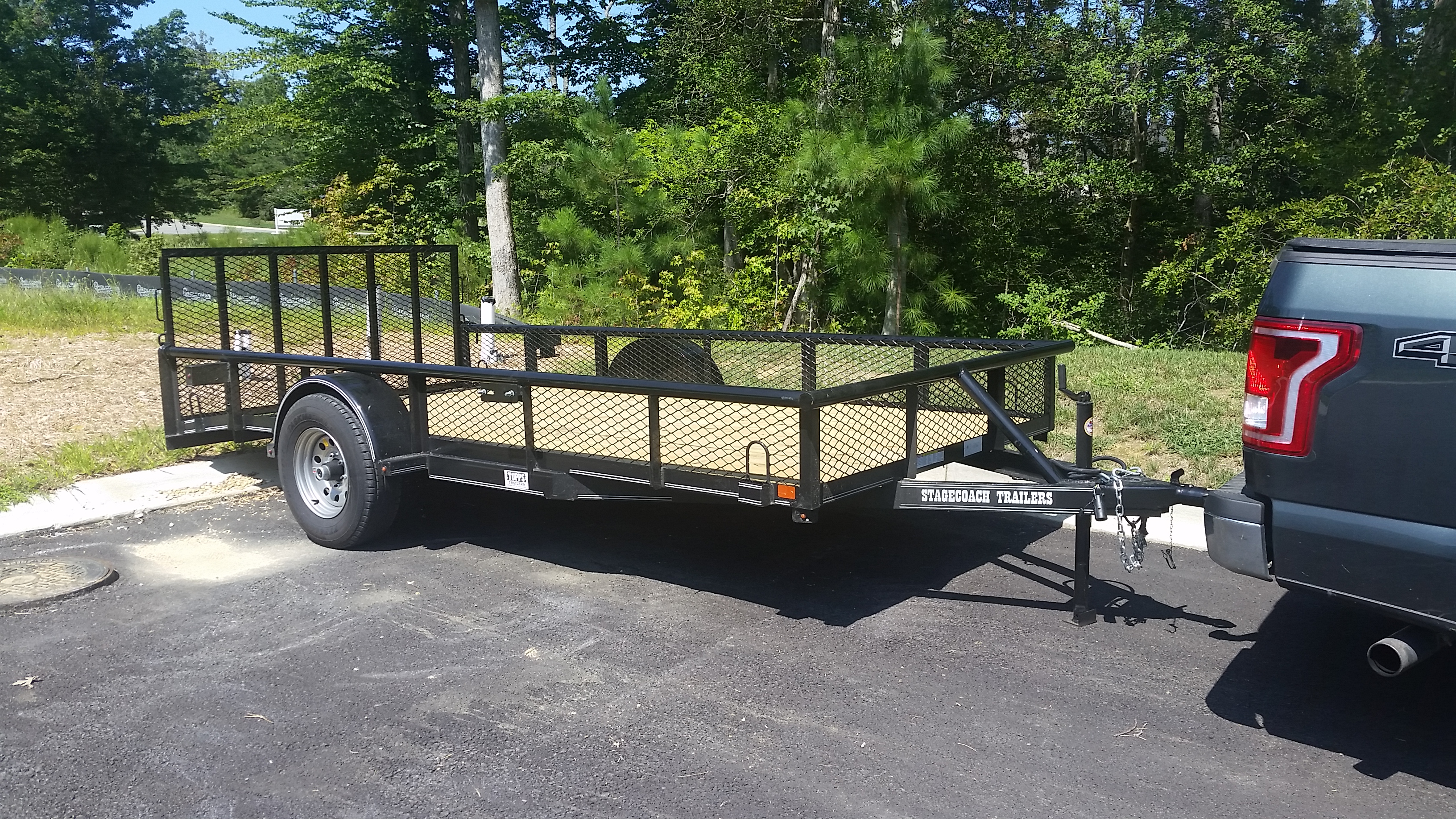

Finally, this is the newer 6.5x14 trailer I bought new in Louisiana. Note the built-in tie-down holes and heavier than std 6 lug wheels. That goes with the upgraded 7000 lb axle. Note also that many mfrs put the wheels further to the rear in trailers to ease/facilitate getting better tongue weight. BY the way, no pictures but I added small pieces of steel cable covered with vinyl tubing (you see that in Tractor Supply, etc.) in loops around the heavy tubular upper frame of the trailer. These loops of cable are placed where any other tie-down would be awkward or difficult and can be relocated if need be. I put 2 on each side.
