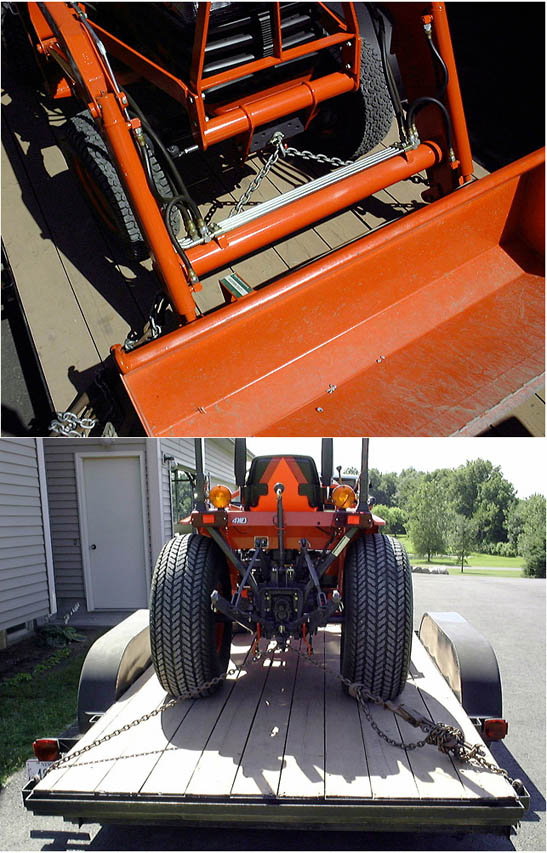

I have a 16' mid-alantic heavy landscaper trailer, dual axle, electric brakes on all four wheels, and use a tekonsha prodigy <A target="_blank" HREF=http://www.bargman.com/tekcat/prodigy.html>http://www.bargman.com/tekcat/prodigy.html</A> brake controller in the truck. great set up for my bx-22. it's trailered at least twice a week for odd jobs. and once a month to my camp which is 100 miles one way and it works just fine. the brake controller is great also, set it once and forget about it, and it can be unplugged in my truck and plugged into my brothers truck so he can take the trailer if he needs it.

I have a 20ft dual axel (electric brakes) trailer that I have been using to transport my tractor. Trailer GW 9000lbs. Tractor between 4500-5000lbs. No problems but it is definately a load on my Ram 1500! Question: The trailer has P245/75R16 tires. They say about 35lbs of air. They also seem low when the tractor is loaded. Any thoughts on running them up to 40 or more lbs of air? I also would like to take this to PA over Thanksgiving (300 miles one way) but am concerned about possible snow. Anyone trailered in snow?Then again I guess if it snows I could hook the trailer to the tractor and haul my truck back?
