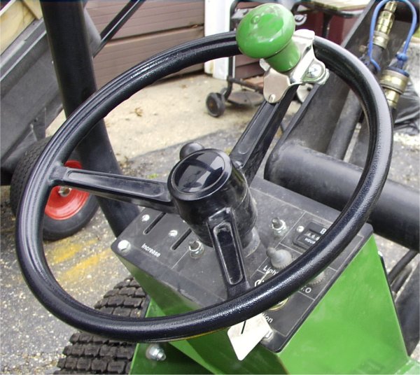

As far as my spinner knob goes, I picked one up at Tractor Supply for under $10.00 many years ago. Its JD green and matches the tractor perfectly. It sticks out an inch or so past the outer edge of the steering wheel, which means its a longer lever from the center, so it gives me more leverage when turning. I love it! Once in a while I'll use the regular steering wheel, but if feels too small and awkward now. I quickly wonder why I am doing this and go back to the spinner! :laughing:

M R, you have to remember, if it was a while ago, they have doubled the price now :)
I have an old one, I am pretty sure, (might even be made out of bakelite) out in my shed, heck, it might be off a Model T, but will see how things steer once I get some more seat time in on it.
I have to remember I am turning more weight. My old JD has a single cylinder that it uses for the power steering, and I don't have half the weight on the front of it.
I am sure all will be fine once I get used to it.
Jeff
