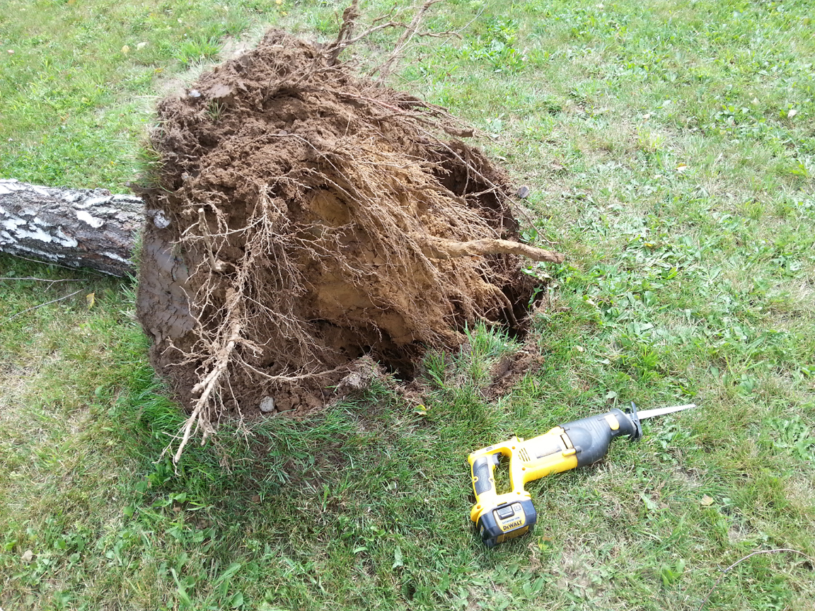

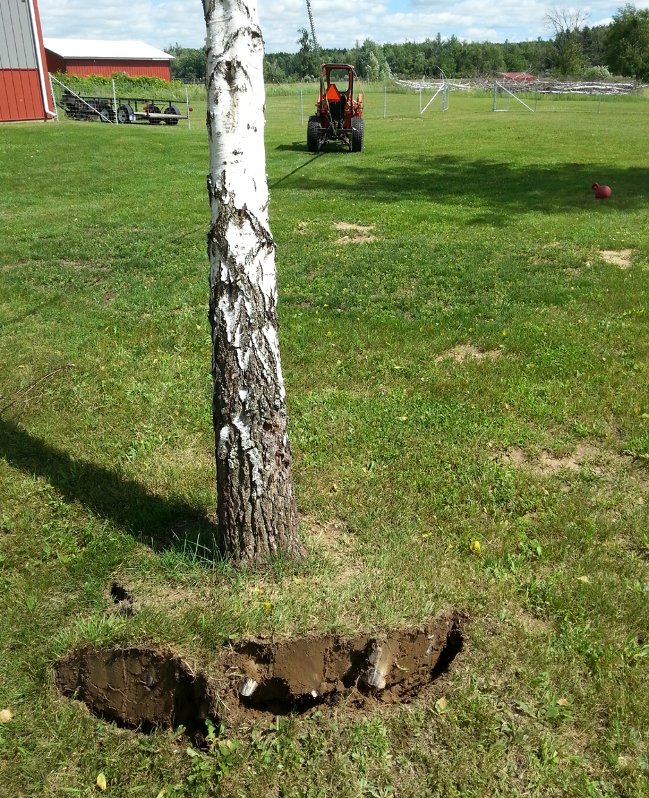

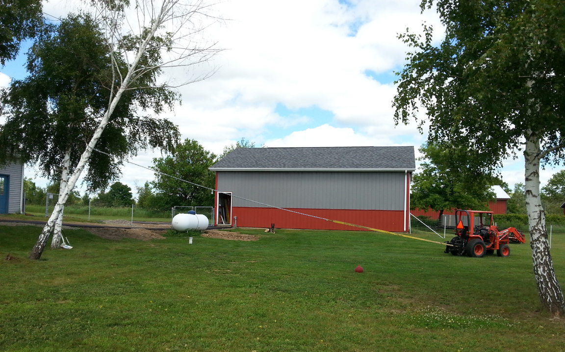

Don't mean to change the direction of the thread here, but just to give you a different idea to consider. This method is only applicable if you also want the stump out. The homestead property I bought 2 years ago had many dead and dying birch trees. Most were a little larger than 11 inches. First I used a ladder to wrap a chain around the tree, about 12-14 feet high. Then I used a sawsall with a carbide tipped blade to cut through the larger roots, about 1 1/2 to 2 feet away from the trunk. With extra lengths of chain and a recovery strap for shock absorption simply use your tractor to fell the tree, root base and all.
The added benefit in doing it this way, I discovered, is that the tree comes down slowly, so felling direction can actually be changed somewhat if necessary. I had a tree over about 45 degrees and I stopped pulling. The tree just stayed in that position.
I also helped a neighbor take down 6 of his birches this way. But being much younger and stronger than me, and with less patience using the sawsall, he opted to cut his roots with an ax. Hope this helps you.

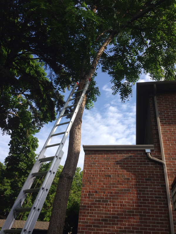

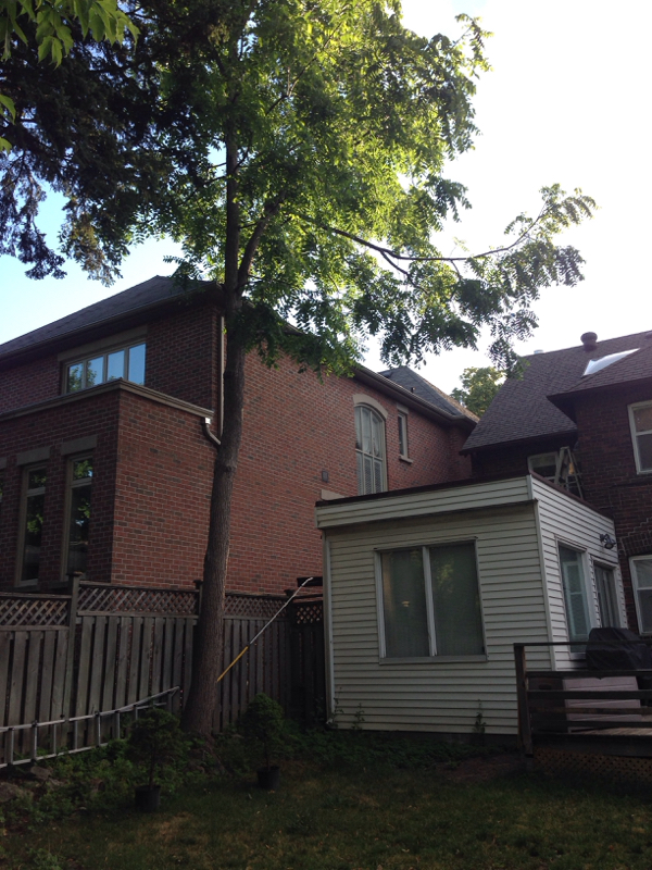

I have a similar problem with a Beech tree that is about a foot or so diameter at the base. I cannot drop the tree inside of the yard, or it will hit the fence. So, I'm going to drop it in sections, and there is a fourth about 12 feet off the ground that you can see in the attached photo.
I planned to chain the two forks to the main trunk before I cut, so that when the crowd hits the ground the trunk of the fork stays up in the air rather than coming crashing down at an angle and hitting the house.
Will use a sawzall, and cut my birds mouth first and then start the back cut in little bitty sections, going down off the ladder each time and trying to snap the hinge. Of course I have to do this a little bit at a time, so that the thing doesn't fall while I'm standing on the ladder. Have done this before, and it works well, as long as you only cut a little bit of your back cut at a time and then climb down and try breaking the hinge from the ground. If you cut too far and it starts to fall while you're on the ladder….��
One potential issue is the chains slipping off when the crowd hits the ground. So, I'm going to drill holes through the tree and attach the chain with a bolt so that it cannot possibly slip off. Any other ideas, guys? Any suggestions at all would be appreciated.

Eeesh! Cutting from ladders. :eek:
Generally frowned upon, but many have done it successfully...and likewise, many have injured themselves....
There are some good youtube videos of people cutting trees from ladders that show the limb swinging down, taking out the ladder and/or the person on it. (Google tree cutting fail). That's why a cheap climbing belt and spurs are preferred (IMHO), or even the OSHA non-approved method of cutting while sitting inside a tractor loader (FEL) is better (IMHO).
At least tie off the top of the ladder and/or yourself.

Check, that's not a beech or birch tree shown in the picture. It should not be $590 to drop it. Maybe to haul the wood and chip the brush from a back yard.... Easy to climb and what appears to be plenty of drop zone. Looks like a 20-30 minute job to put it on the ground. Removing it all may be worth the $590 depending on how far the drag is and the access. Just sayin'.
