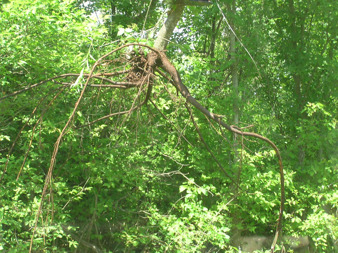

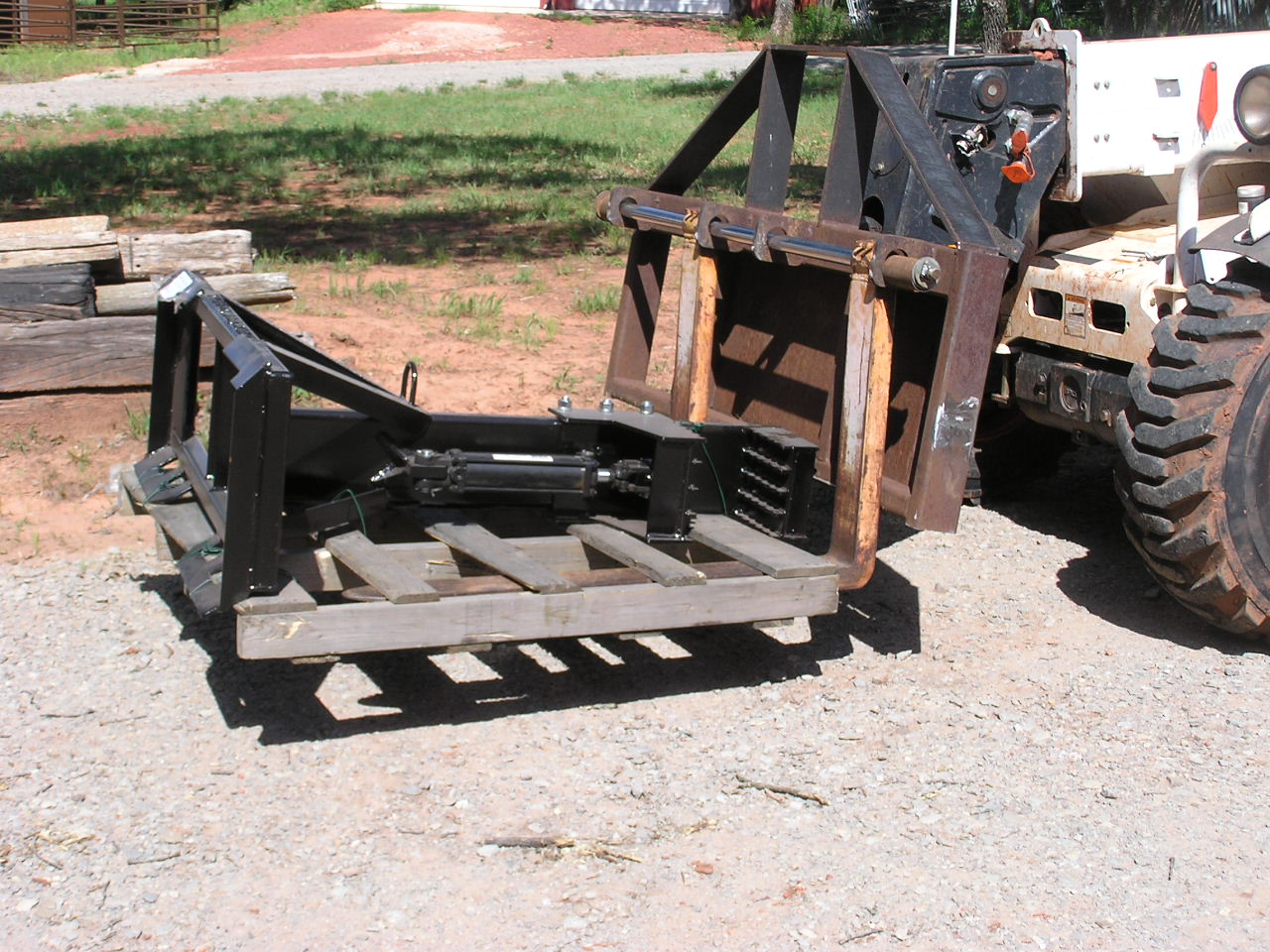

The Brush Grubber is the reason that I got the Long Arm Tree Puller. :D
Buckthorn Puller - Custom built Skid Steer attachments to fit almost any need you may have.
The view from the seat.
Link to the big cedar: http://www.tractorbynet.com/forums/attachments/277824-tree-puller.html#post3444397

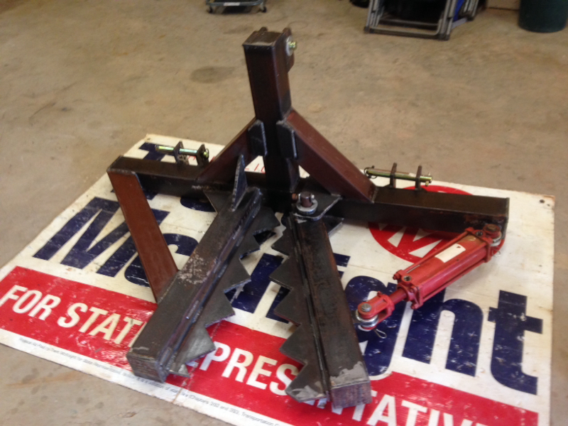

   / tree/post puller #15
Not as nice as xfaxman but works for my needs.
Homemade 3pt puller.

   / tree/post puller #17
Very good idea, since the 3pt has more lifting force than the FEL. :thumbsup:
