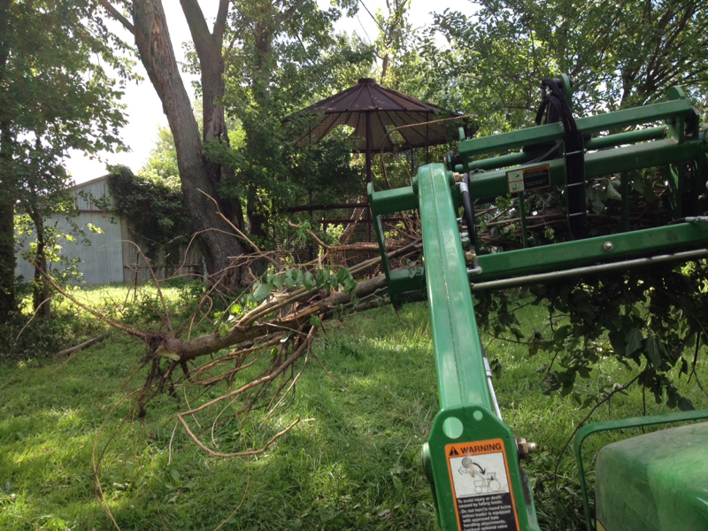

Looks like it is about 1/3 - 2/3 centering on the smallest trees, bigger trees would be more centered than that, that doesnt seem like a real killer off center. It seems if there is enough grunt to pull it up by the roots carrying it should be OK ?????? I'd be more concerned with keeping it upright if it were real tall no matter where it was centered.
   / Tree Puller: Pleased with my new Attachment
#12
It is slightly off-center, to the right. I notice my left rear wheel lifting off the ground when I attempt to pull out a tree that is too large. That surprised me because I thought the lift capacity on the loader would constrain me.
I have a JD4105 with a 300CX loader. Yesterday's ballast was a 74 inch Flail mower -- I will go heavier next time.
Mostly, I have willows to extract -- small, but too big to bush hog. They are tall, pretty straight and I'm thinking about putting the chipper on the back (3PH) and after uprooting each tree, I'll chainsaw off the rootball and chip the whole tree 1-2-3!

Mine weighs about 300 lbs -- one of the reasons I chose this design was it's light weight -- so my lifting capacity wasn't consumed by the attachment. Also the tree is close to the pivot point on this design.
It is my understanding that the 3-point hitch option I chose added 50 lbs. I can hook-up on the front or back.
The cost was $1450 plus $200 for my option plus shipping. Customizing for my loader was included in the base price. I will get my money's worth out of this thing before I run out of trees!

I do have a grapple. I used it to pile-up all of the trees I pulled yesterday. As for digging, it is not very precise due to lack of visibility. I can't see the grapple tines from the tractor seat. Result is usually a big, ugly hole the width of my grapple, or wider.
The cylinder movement is fairly slow -- no need for flow control on this gadget! I was doing most of this work at idle speed. It would close faster if I revved up the engine speed.
I have not owned a tree shear. However, I have a stump grinder like you.
