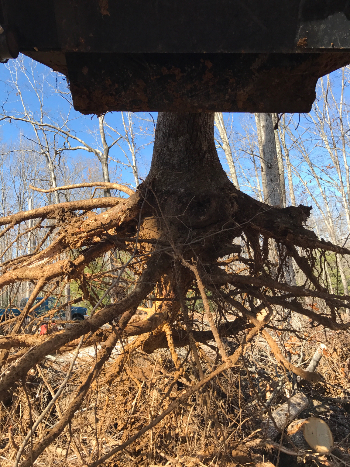

Tree pullers are sweet, but IMO a tractor lacks the muscle to use it. IMG_9390.JPG

Your lift capability is going to be your main issue. Don't forget the weight of the implement when calculating how much you can lift. If your puller weighs 500lb you are already cutting your ability in half.
I have a 100hp JD 5100. I purchased the Danuser Intimidator, and I would do it again in a heartbeat. IMO, it is the best out there, but you pay a price. It would NOT be good for your size tractor, however.
I suspect that you would do fine with the puller you linked on YouTube. I wouldn't get the 'bucket attached' version. There is a lot of leverage and pushing it out 2-3 more feet will only hinder you. I think the puller would likely be a good investment. You might not get all the trees out you'd like, but avoiding cutting all those small 2-4" trees and just pulling them up might be worth it for you.
Also, whatever you choose, recognize you really should do your pulling with something heavy on the 3pt. This will significantly improve your ability as well as improve your safety and stability. I use a 2k lb box blade.
