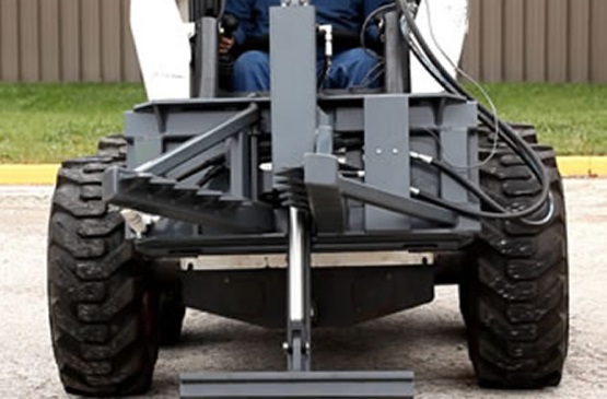

I sure would like to see the hydraulic foot in action. It does appear that it would lift the front of the tractor a couple of feet off the ground. Perhaps it only lifts 10-12 inches to assist in breaking the rootball free.
/ Tree Pullers #31
It's a different force. The tree puller it lifting the whole machine. Not just the front.
The one linked earlier is a hydraulic cylinder built into the tree puller. Tree Grapple / Post Puller - TJ12UN-TRK-BF
I don't see that lifting the whole machine. Even without the loader in float, I don't think it would overly strain the curl cylinders.

That beast is way out of my league! $10K+ and it weighs in at 700 pounds. Don't think my little compact tractor would be up to the task. Sigh!
