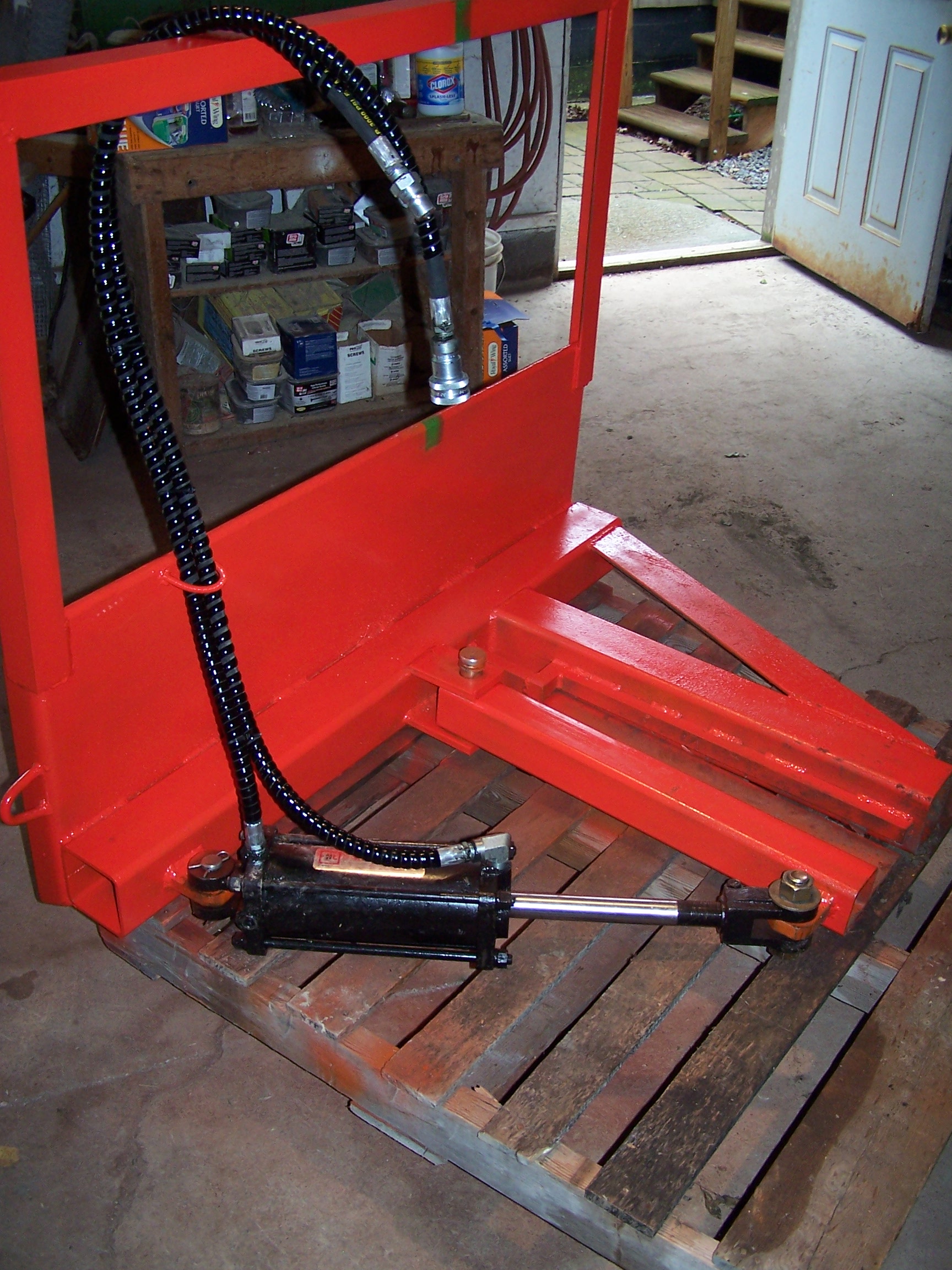

I built one a few years ago,pain-fully slow work.I ended up using a chain saw and hand run brush saw.I don't see how it could stress the loader arms at all;it applies pressure to it-self not the loader arms.

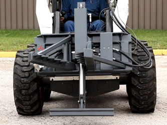

I was thinkimg about cutting trees up to 6 inches. That puller pushes against the ground, doesn't it? I was thinking a puller would put pressure against my front spindles and break them. If the ground pushing puller would break the roots from the ground, so the loader could lift them, that might solve the problem. Thanks for the link.

Shear is (was)_powered by the tractor hydraulics.I never tried any trees bigger than may-be four inch.
My tractor weighs about 7,000lbs.Again;way to slow for my liking.I would rather leave the grapple on and cut by hand.

I meant to mention the FEL stresses and forgot. I didn't notice any lateral stress on the FEL at all when using the Shear. If you look at the link I posted you can see that the horizontal movement of the shear jaws is minimal. Much more lateral movement in a jaws type puller such as Xfaxman posted. Lastly, when digging in hard material with an FEL you will put far greater lateral stress on your FEL. I wouldn't worry about it too much. :)
