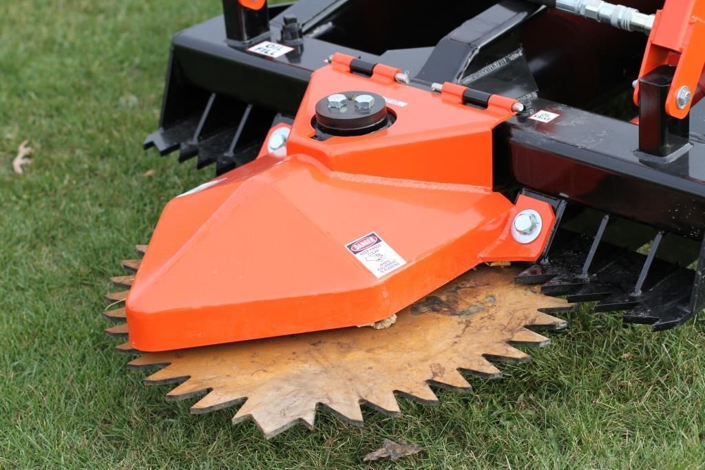

Basically anything you could use a shear on (using a tractor as the driving force) it seems the Tree Saw would be quicker. Not only that but you can cut at ground level (depending on rocks) and leave the FEL grapple on for material handling.

Agree that the excavator is the best tool for the job when pulling trees out of the ground, I was impressed with a small 6k lb unit that I rented for a job on small trees about 4" in diameter. I've always been interested in something like the Turbo Saw or the Brown Tree Saw.
I've "internet shopped" quite a bit with these and was going to buy the Brown Tree Saw last year for a job but it ended up falling through, too bad because it would have paid for itself on that one job. It seems to me that for a tractor implement the Tree Saw is the most efficient way to take smaller trees down, say under 14" or so. Basically anything you could use a shear on (using a tractor as the driving force) it seems the Tree Saw would be quicker. Not only that but you can cut at ground level (depending on rocks) and leave the FEL grapple on for material handling.
Unfortunately most of the youtube vids on these units only show small bushy trees in a field and not backyard hardwoods like I'm dealing with in New England. Compared to a tree shear, I imagine it would work considerably better. (Assuming the operating platform is the 60hp tractor you mention)
My neighbor has a 16" tree shear that cuts at ground level, and with his ASV-100 it makes quick work of it, but he also has something like 40+ GPM and over 3500psi for hydraulics. I think a tree shear wouldn't be very effective for clearing trees on a tractor. Course, even with the Tree Saw, you still have the stumps to deal with like Richard mentioned, although at least they would be somewhat level to the ground and easy to mow over, but if planning on plowing the land then all bets are off, unless you grind each stumps afterwords (there is another implement) ....man it gets expensive to clear your own land with a tractor! :laughing:

Problem he had with a Saw was the violence of it all. He said you had to be very patient when engaging the tree or the blade would dig into the tree and try to spin the SS sideways. He thought it put a considerable amount of stress on the loader arms.

The Brown's Tree Saw looks good. I wonder how quickly I'd wear out my clutch easing up on all the trees in a severely overgrown pasture.
That's a good point, if you don't have creeper gears it may not work well at all. Might be worth a call to the manufacturer and see what they say (taken with a grain of salt of course, but I've spoke with the owners of Brown equipment numerous times and have always felt they were honest with their opinions.)

Good point about the "violence" of it all, that 144lb spinning blade has some serious momentum at 788RPM. I would think the 3 point arms would take it better than the FEL, but still an absolute concern.
The tree saw may not be the best option for you, I was just throwing it out there as an idea to consider. I can just picture a Tree Saw on the 3 point, and a grapple on the FEL, that would be a serious land clearing machine right there! (for a tractor)

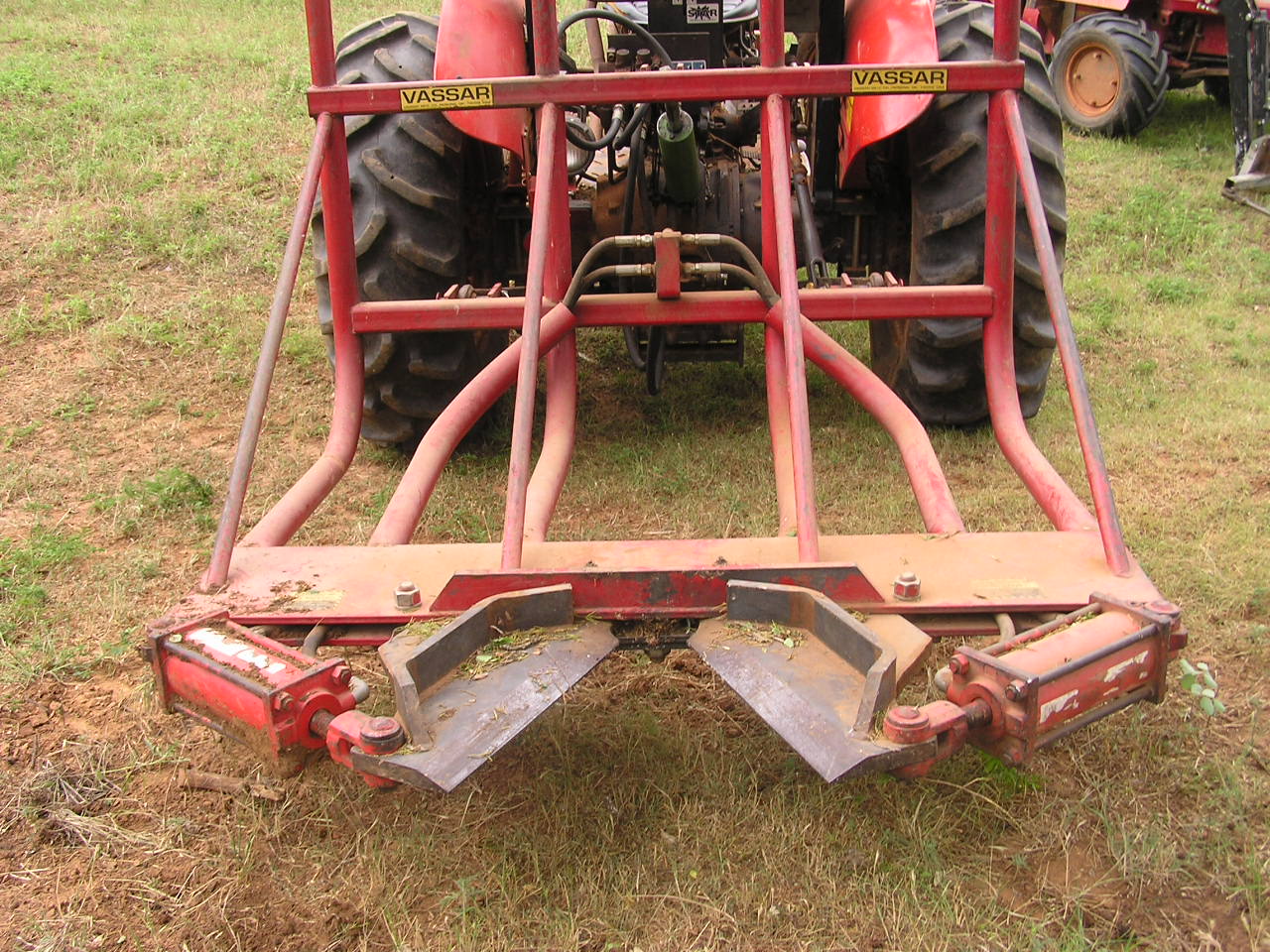

Here's a tree saw that doesn't have high rpm, so might not be as prone to self-destructing when encountering rocky ground (speculation on my part, though).
Marshall Tree Saw - Home
Bob
Yep, not a spinning saw blade, cuts more like a shear:
