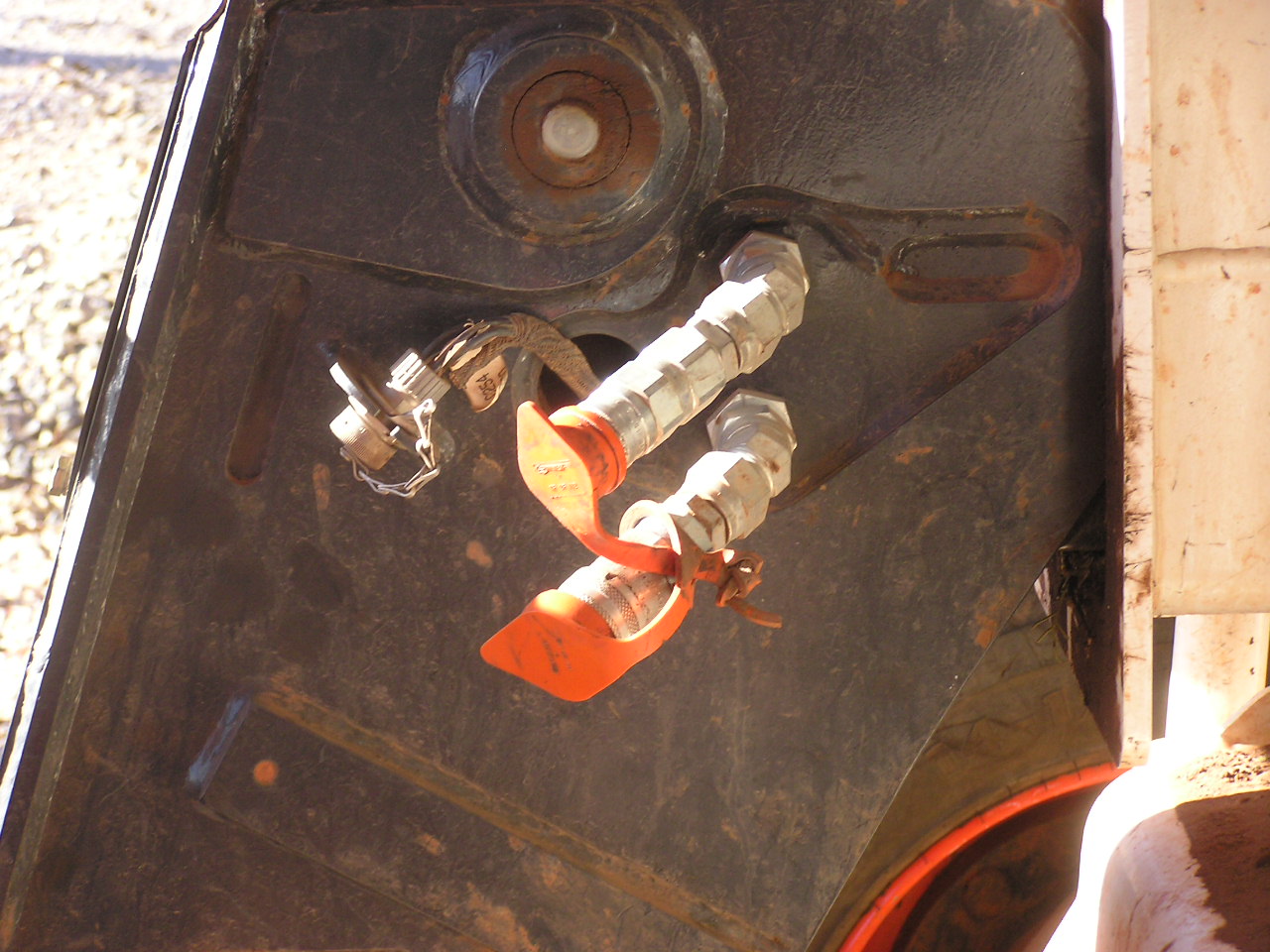

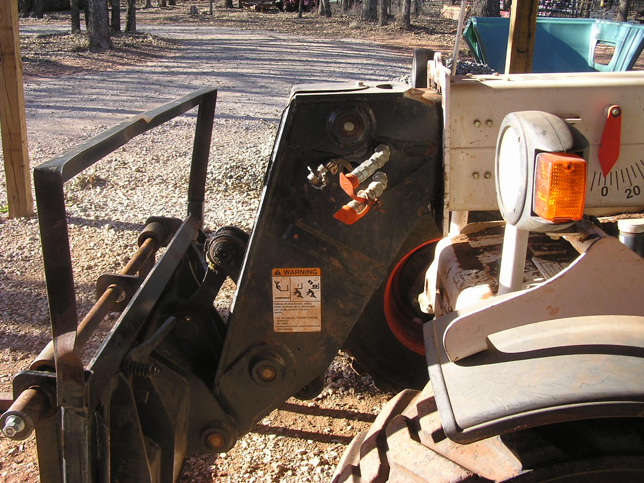

Thanks for the clarification Xfaxman. So, on your Compact telehandler, the outlets are at top of your boom?
   / Tree shear #93
Yep, out at the end of the boom near the SSQA plate.
Flat faced couplers and the electrical connector has a screw-on cap with a small chain on it:
Since this is the "Tree Shear" thread I will add on Edit, the Cedar Tree Cutter plugged into the aux hydraulics on the boom:

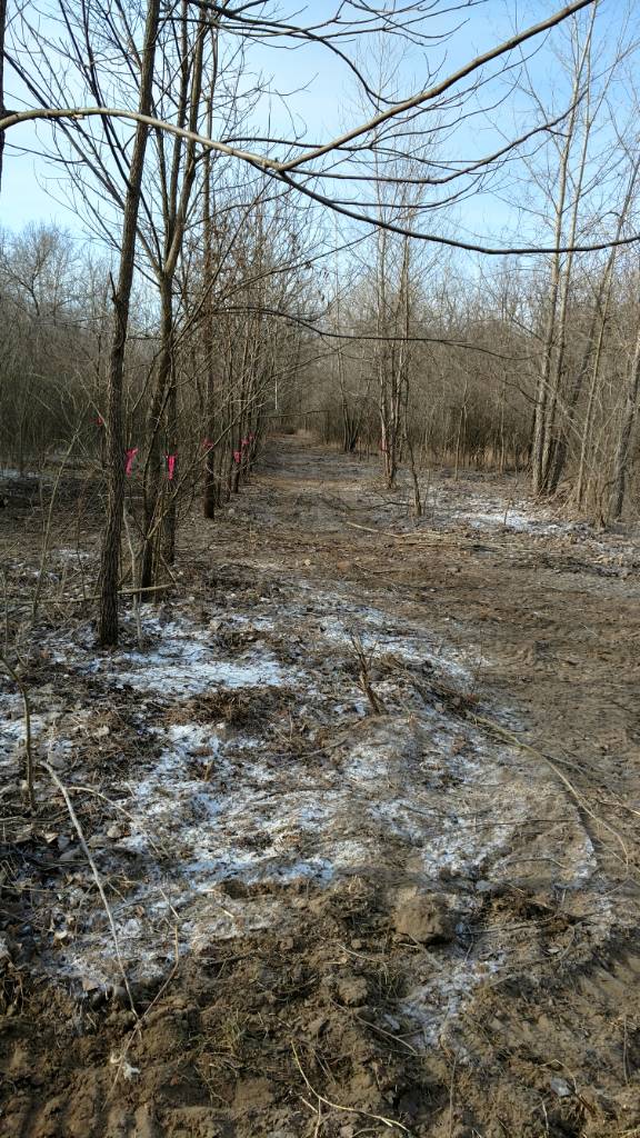

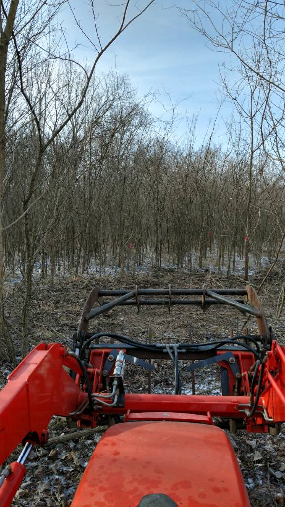

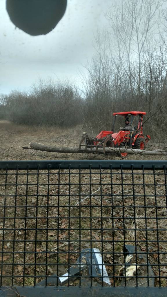

Spent all day Sunday and Monday working on my project. Put the shear on a John Deere track loader and grapple on b26, and used the M5400 with a landpride brush mower. We got a lot done but the small stuff takes quite while, guess we should have started this project about 10 years ago.
On the large cottonwood I could get through them a little better with the track loader as it has about 3300 psi vs the B26 has about 2500. With the track loader I could drag out the large trees to the open area for the Kubota to handle them. Took a few videos but can't get them to load on the app?
All in all very happy with the grapple.IMG_20180205_092939676_HDR.jpgIMG_20180205_141613646_HDR.jpgIMG_20180205_093009296_HDR.jpgIMG_20180205_131150299.jpg
