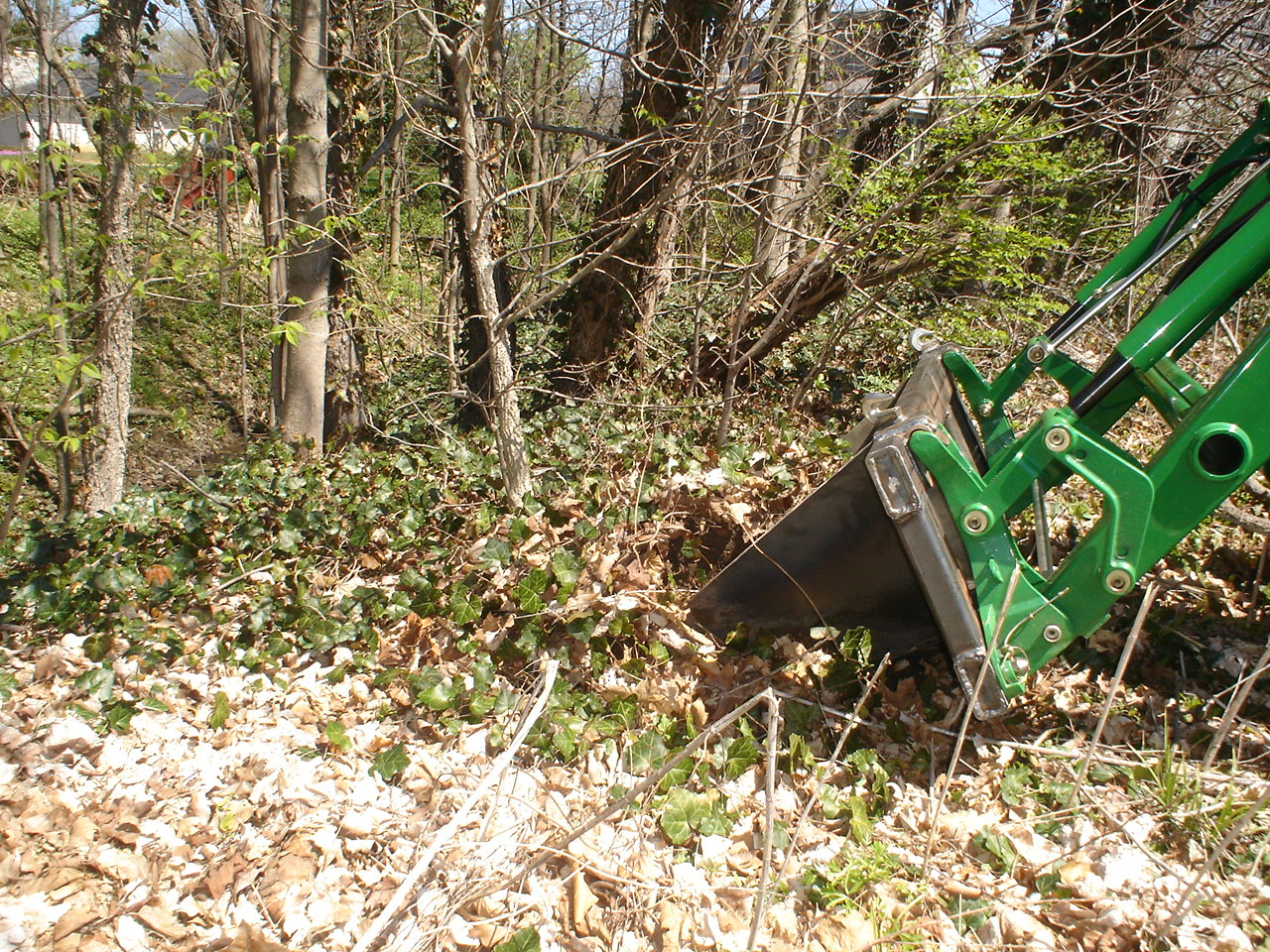

Carl - It is critical to understand some of the parameters of your quest... How big are the trees (1" vs 24"); what type of tree are they (small fiberous shallow roots like with Cedars vs single giant deep tap root); Soil density / moisture; etc.....
I have had success doing the plunge approach with my Shrub Bucket from each side to cut all the roots and attachments to simply lift a Cedar tree out, but have yet to tackle a bigger hardwood.
Here is a sample picture on an easy (very small) sapling that came out in one plunge.

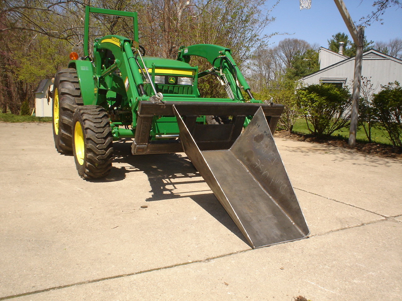

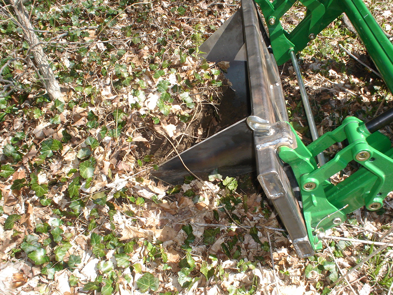

Some other images.......
I believe you can modify your bucket however you want, but if you go too narrow it won't have enough of a chisel effect to cut roots and create a good enough slice through the turf. Regarding a more shallow side angle - keep in mind that the sides of the bucket are also providing a significant amount of strength....going too shallow will create a larger surface area and when you start rolling the bucket as you plunge it may flex or bend due to the "flatter" perspective. More upright sides are better at levering out the load. It's mostly about finding a good compromise of angles; length; and strength....... Hope this helps

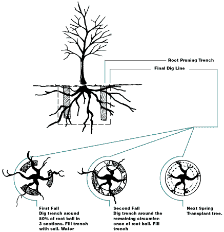

Large trees should not be transplanted with root balls smaller than 12 inches in diameter for each 1 inch in trunk caliper, however most Cedars have large fiberous root systems that are shallow and very widespread so a foot per inch diameter might be overdoing it. You should try to capture at least 75% of the root system to ensure better odds of surviving. Sometimes you can push a Cedar over exposing the whole root system anyway. If you have a lot of these and they are destined for removal anyway, pick one out to experiment on to determine the best approach and estimated root spreads.
However you eventually choose to move them, the receiving hole usually needs to be double the size of the root ball to encourage faster root growth into the new soil. i.e. - 2' diameter root ball = 4' diameter hole. Tree Spade machines simply cut a new hole to match the old one and drop it in, which works since they are taking the whole tree system together, but the tree will take longer to begin new growth without a prepared rootbed.
If you had more time, you could prune the root systems in preparation for transplanting.
