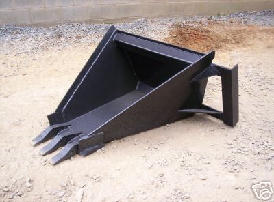

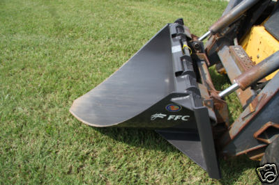

For those of you that know where these tree spades are in a specific tread, I've seen a few on the forums. JJ I'm interested in a couple pics you had under home made attachements etc.
Do you have any others or did you make them yourself? How much ball park for materials.
Any and all information would be great. I'm a landscaper and this would be an awesome attachment.
I'm looking for a tree scoop,scrub scoop etc like that of a tree spade
Any and all pics would be great or home made ones that have been made
I own a PT425 in the Maryland area.

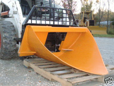

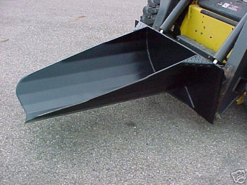

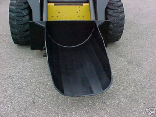

I have a bunch of pictures. I will see if I can find them. Most of them are made with 3/8 steel. I just purchased a Case skidsteer with a lot of attachments, including a tree scoop, homemade .
I would suggest that if you have the capability and material, to build your own, to match the capability's of the 425. A good metal shop can roll or bend that 3/16, or 1/4 steel to your specifications. If you are going to so the straight sided scoops, just have them cut the metal and you do the welding. There is a bunch of them on Ebay. They are not cheap. The white scoop, is mounted on the end of a fork. The third picture has a concave front to better cut roots.
The cost is related to the kind and amount of steel used, plus the workmanship of yourself or someone else. You can figure $200.00 to $1000.00 on material and labor. If you can find used, that would be good.
I did make a light duty scoop out of a bladder type water tank, by cutting it to shape, and bolting it to one of my forks. You can find those tanks for free.

I wouldn't expect the PT-425 to have enough weight or grunt for a brute force tree spade. I notice that PT doesn't make a spade for any of their machines. Makes me wonder why not?
/ Tree spade #4
I wouldn't expect the PT-425 to have enough weight or grunt for a brute force tree spade. I notice the PT doesn't make a spade for any of their machines. Makes me wonder why not?
I believe that it could push a light weight blade in the ground. One of the PT owners pushed their forks in the ground deep enough and were able to lift the PT off the ground. Most of the scoops are pushed in the ground by shifting the front end around until it is at the depth they want.

But seriously, the PT425 could push a tree spade UNDER something, but it does not have the weight or traction to push THROUGH something like large roots. You will bend, spindle and mutilate something trying to force it.
It will work on small trees and shrubs and will also do well for digging holes for transplanting.

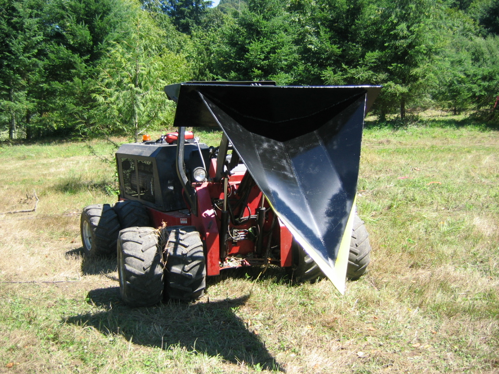

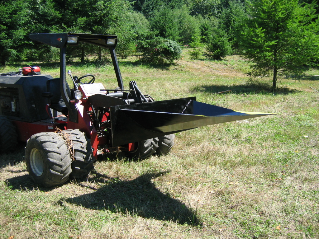

Here is mine. something I built myself. The really cool ones are the skid steer versions with the hydraulic arms. Problem is they weigh too much for anything but maybe the 1445 or 1460 You need at least 3000lbs worth of lift. - 1500 lbs for the device, another 1500 for the tree and dirt.
My bucket works OK, In the summer the ground is too hard, in the winter, the ground is too heavy with water. Not the worst implement, but does not meet my expectations.

Carl, Did you make those bends in your tree spade, or have someone do it for you . Those guys at the metal fabrication shop can cut or bend or roll that metal in no time. All you do is give them the design and pay. Most of the time, you don't have to touch the metal until it is in your truck all cut and bent. I have a shop press, but can only bend small stuff. Straight cuts work better for me. . Just tack and weld.
On the 425 capability, I think if you down size the tree spade it will do a credible job. A sharp pointed spade might slip to the side of a root. whereas a concave one might cut through the root. 1/4 in thick might work. The spade that I just purchased is designed for a skidsteer, and weighs about 275 lbs. 3/8 steel.
/ Tree spade #12
Oh, yeah. I had it bent. I have NO skill with metal. Still learning. I took my plans to the metal shop, said I wanted to practice welding. They looked at the plans and asked why I had the bucket being made in multiple peices and not one peice bent. I asked how much, I think they said another $20 or so...

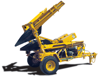

Have you seen this machine? It looks neat. Has me wondering for I am expecting to need a method in a few years to dig trees.
Know a little about the TP rig and my thought may be way off, if you could come up with a vibrating action to the tree spade would it not cut the roots better? So how to get that vibration? I know there are trenchers used to put down cables that have such and wondered today if there is any other option to operate a home made blade like on this unit. Can you buy vibration attachments or would you have to make such? Realize this is very crude but even wonder if you added a hyd motor with a out of round weight to the cutter if that would help. To operate a blade like this thought about hyd impact wrench. I have never used one but would assume it gives blows as does an air impact wrench. Hey mounting a hyd motor to the cutter with an unbalanced weight and it's normally shaking action from that might give a bucket enough action to help slice through the roots.
native plants,oregon plants,ashland natives,nursery stock,holmac treedigger,plant oregon,wildlife gardening, bio-remediation,bird habitat,bonsai maples,landscaping trees,siskiyou bio-region,rootpruner,riparian restoration, rogue ecosystems,treespade
/ Tree spade #15
Wow! That looks like a very specialized and expensive piece of equipment. The digger moves left right, up down, in out and the tracks even move wider or narrower and the whole unit weight shifts forward and backward on the tracks. I'll bet it's 50K or higher! :)
As for a tree spade on a PT, remember, the 400 series can only lift 800 pounds at the quick attach plate. You hang a 300 pound attachment out there a few feet in front of the quick attach plate and you will only be lifting root balls that are 2' across and a foot deep MAYBE in wet or heavy soil. The larger units have more lift, of course.
I think a tree spade on it's own wheels that is just transported, positioned and powered by the PT would be a better choice for small units. Something like the Vermeer TS-44A comes to mind. Find something like this with a blown engine and you are set to go.
Vermeer TS-44A

/ Tree spade #16
Vermeer TS-44A
Moss, that Vermeer weighs 5390 lbs. A 400 series machine could not tow or position it properly, certainly not safely, even on level ground. It will extract an 1100 plus lb tree from the ground. I hate to think what could happen with the tongue end held down by only a 1400 lb or less PT, even with the moment arm advantage.
I think another solution is in order.
