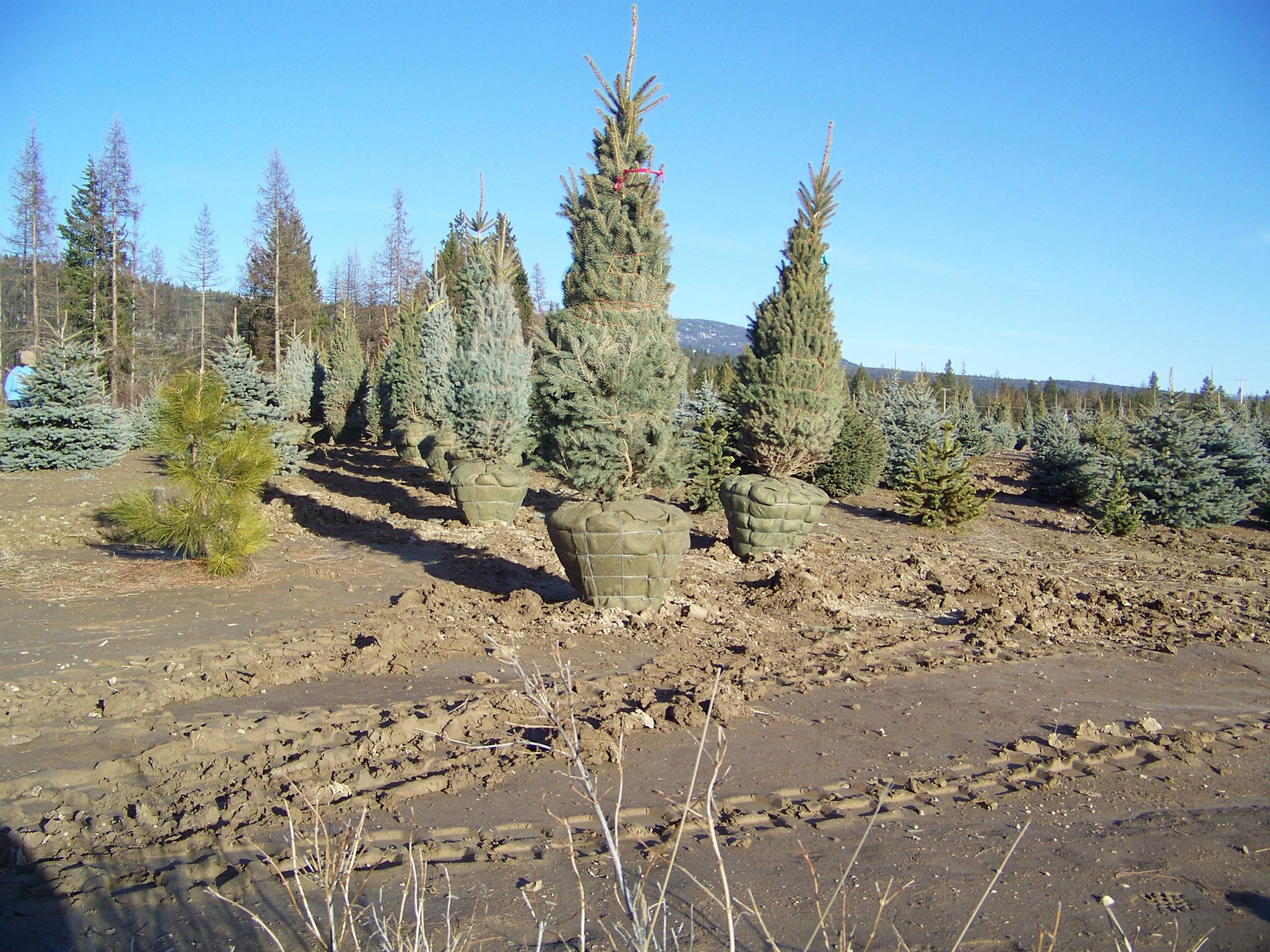

my first four trees:

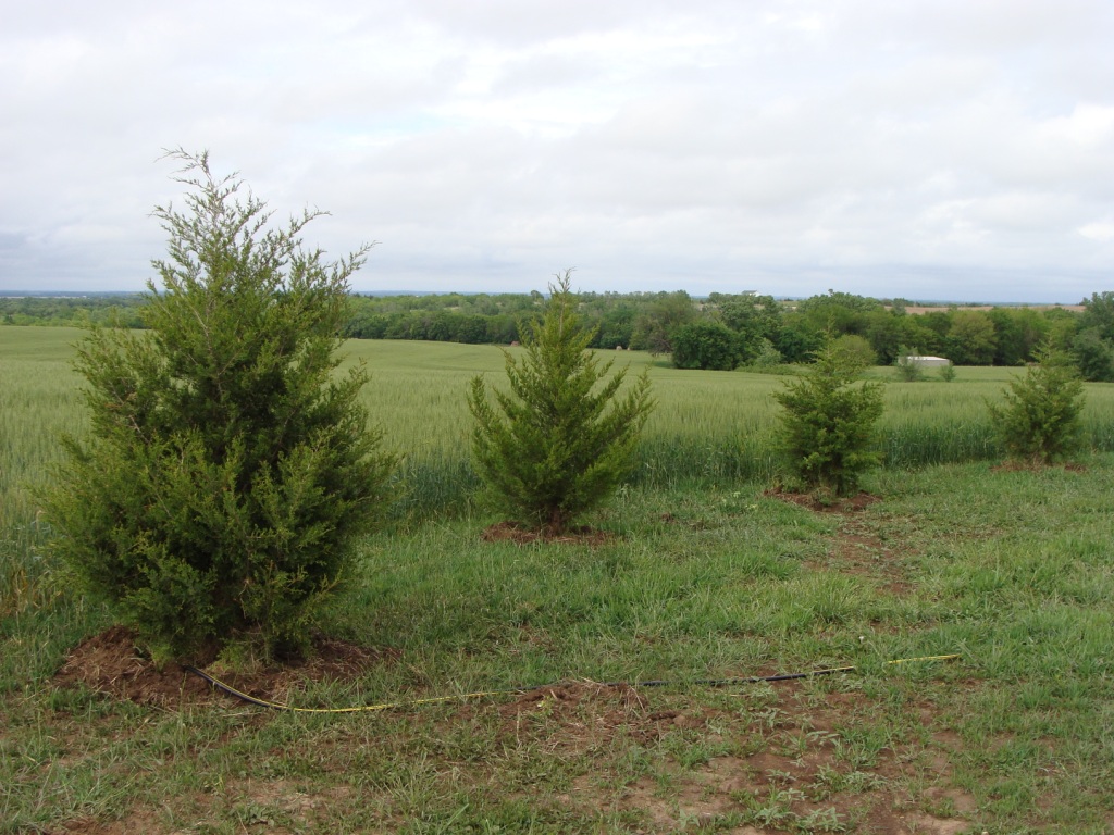

   / tree spade #13
Looks like the tree spade does a good job moving the cedars but I gotta ask.... for a windbreak shouldn't you be re-planting them closer? Or do you plan to fill in the gaps with more trees? Or maybe the cedars will fill out the gaps as they grow and branch outward??

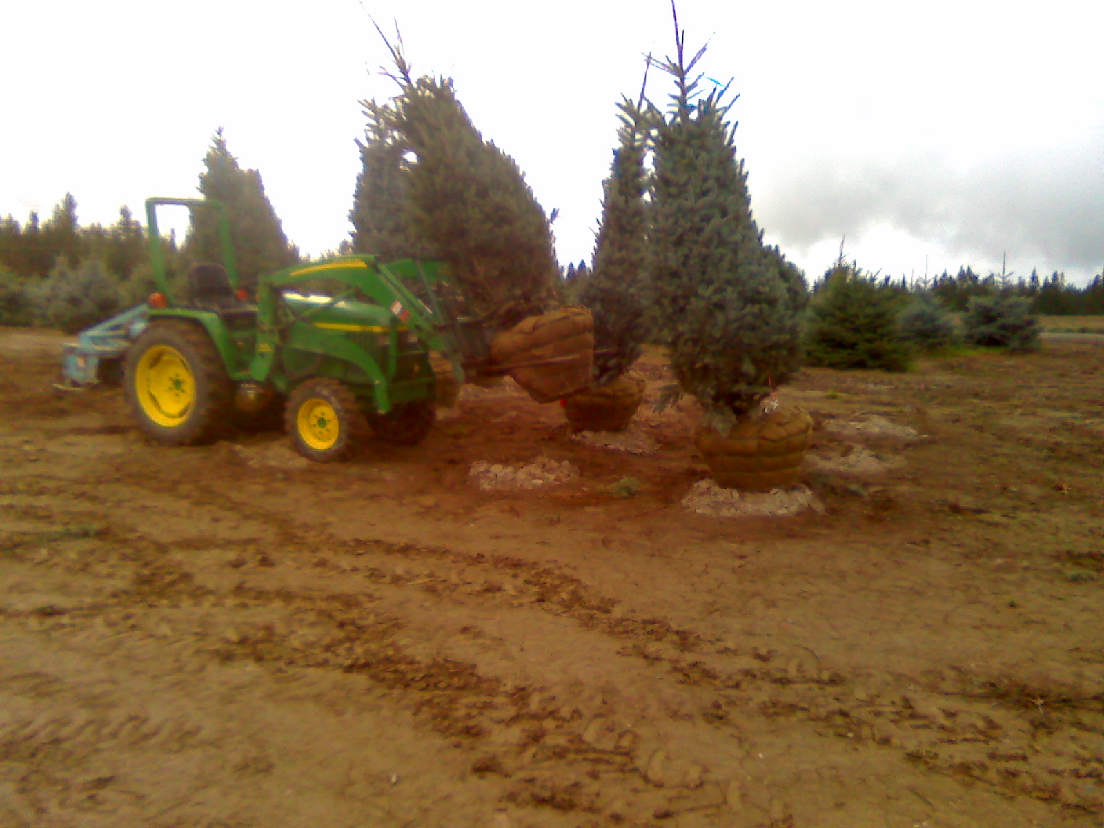

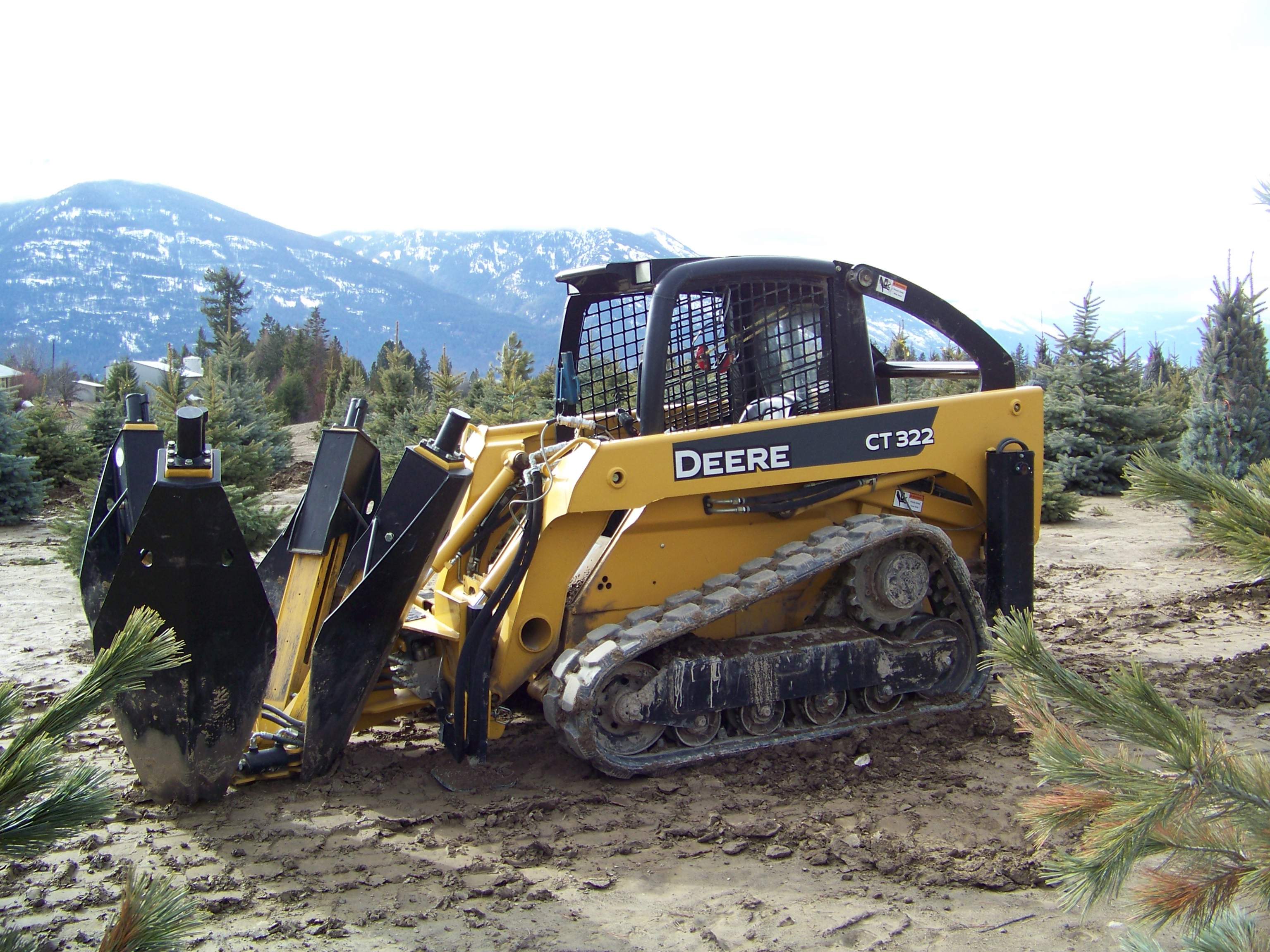

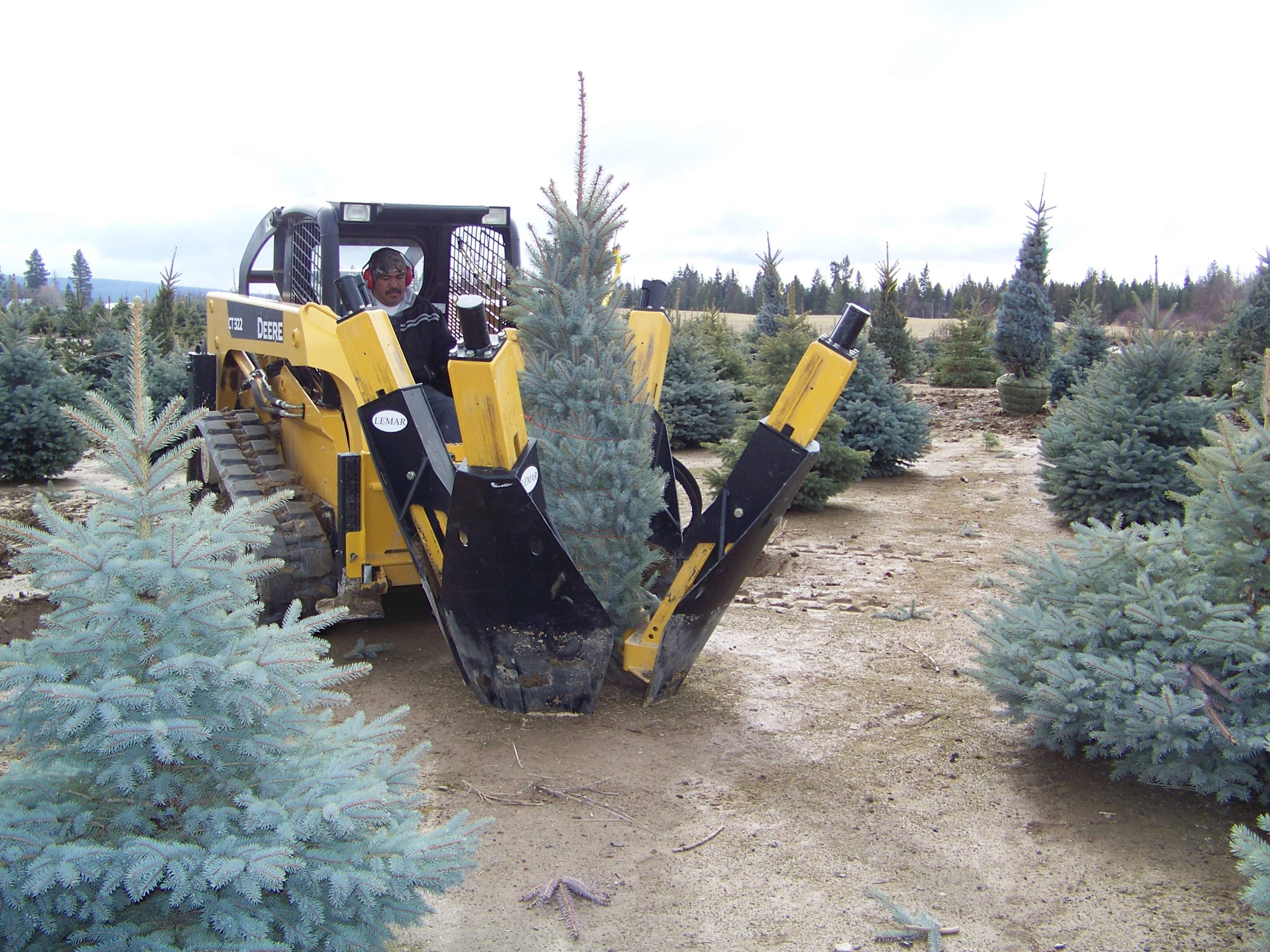

Hello beavis, Here is a few shots of the tree moving that goes on here in the spring and occasionally in the fall. A 36 inch lemar spade on a jd 322 track machine and me little 790 loadn' trees to get hauled to a customer:thumbsup:
This is the beginning of the first row, with the trees being approximately 12' apart. There will be a second row planted behind, that will be offset (left to right) by 6' which will fill the gaps. I guess it will look like a big zig-zag if looking at it from above. As the trees grow and fill in; a pretty good windbreak should be established.
