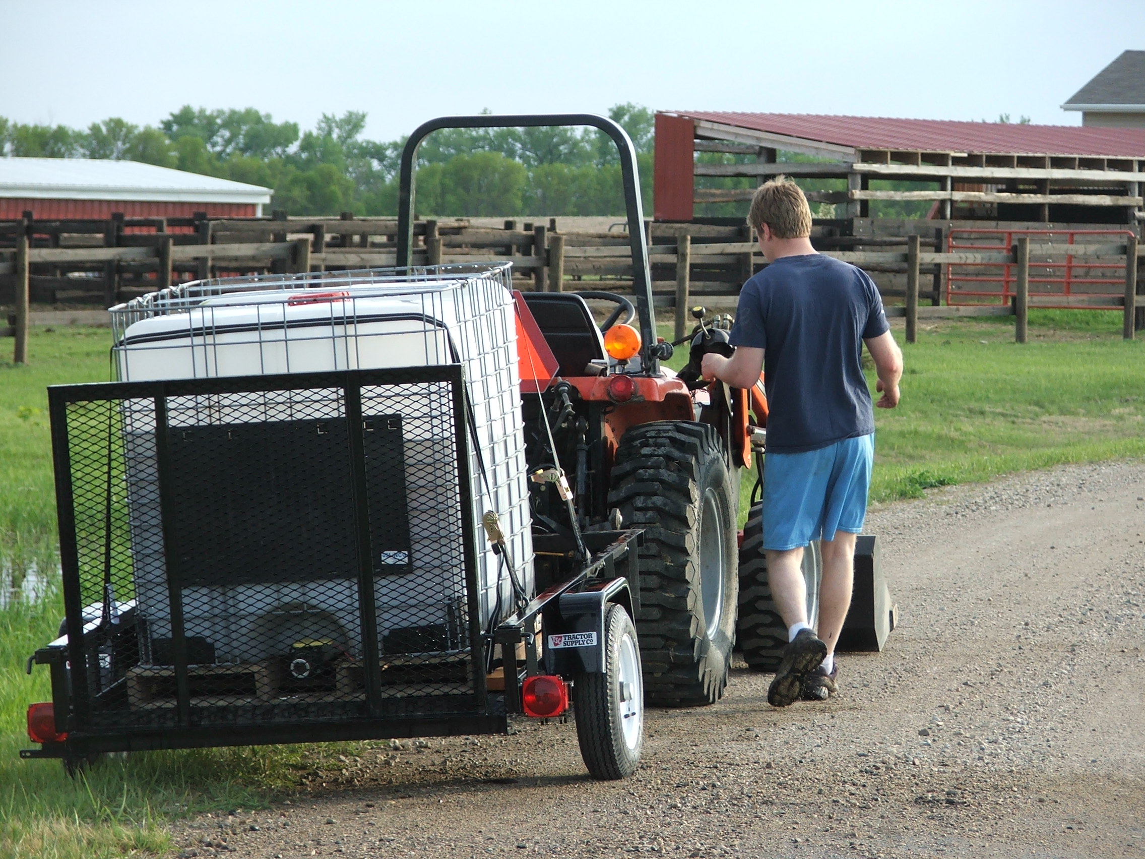

So i got a Tractor supply ad in the mail and they had some small trailers for sale for 399.00 so and at another place in town they had these large 285 gallon tanks so i made this to water my trees.

Assuming that water weighs around 8.5 lbs per gallon, the trailer is carrying about 2500 lbs. I dunno what the rating of the trailer is.... but I'd be real careful pulling it at any real speed. That said, should be a really handy tool.
/ Tree watering trailer.
yeah it is only a 2000 lb cap trailer. i only filled it to about 200 gal. and i only use it behind the tractor for now. seems to work ok.
tank was only 75 bucks so that seems like a steal
and yes i use a 5hp two inch transfer pump to pull out of a pond type area. it fills it in probably less than a min.

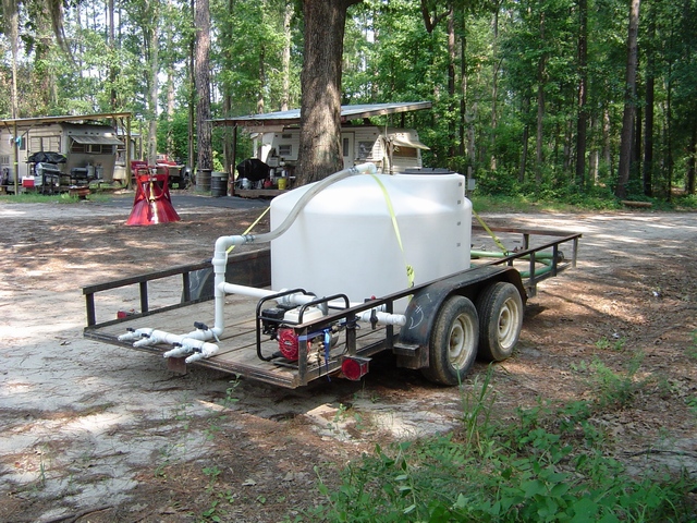

Here's one we use...You can pump the water in from a creek using the large valve on the side and the green hose up front. The smaller valves in the back are set up for garden hoses.

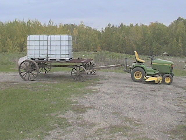

Here's mine

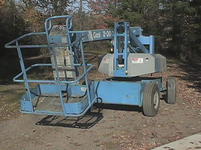

/ Tree watering trailer. #16
Interesting idea! I've never seen one up close, so I don't know how sturdy the frame is; but if it can handle a full tank of water or other fluids, then I would think it could be modified to be a manlift.
I wouldn't try as it is single use engineered structural system. They hold huge loads distributed evenly - they stack.
A manlift is much more robust.
