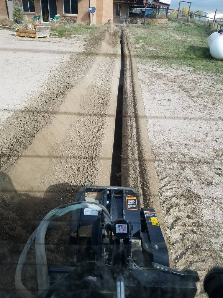

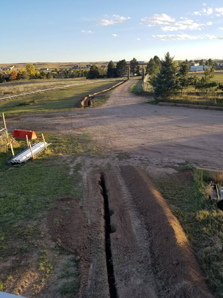

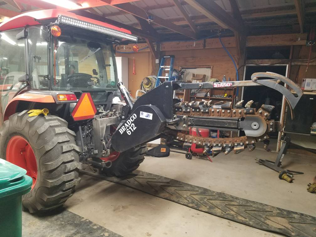

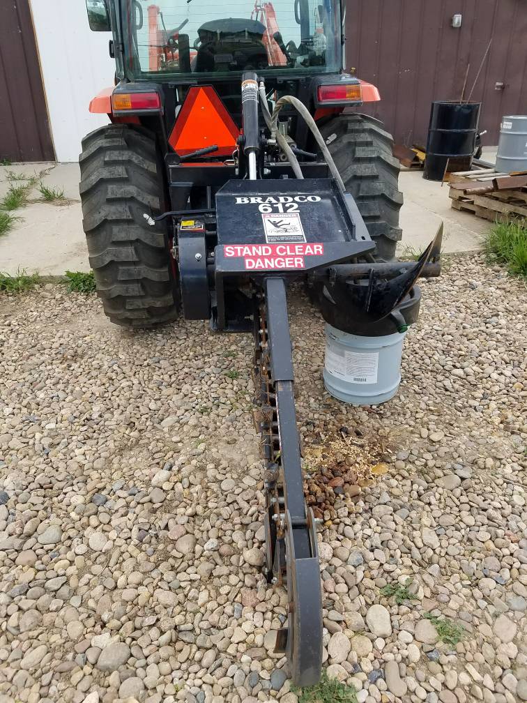

I got my 3pt trencher for $1,500 from a propane company via Craigslist. I think it was simultaneously to big & to small for them. To big & needed a tractor for home tank setting jobs & not really big enough for water.
It does 3', which is the frost line around here (Colorado). But personally I wont use it for water as I want more safety margin than 0". Its worked good for handful of electrical projects. It's nice to bury my conduit 3' down rather than the required 18". I know there will be an idiot with a box blade working over some of that stuff. I dont want to have to ever worry about catching & fixing it.
I'm guessing I'll be selling it in a year or 2 when all potential projects are done. Probably get what I paid for it. But even if I only get $700-100, that's still 2 days rental of a riding trencher. Not as capable as a rider, but way more convenient to have this one laying around for a few years.
HST is a requirement for a 3pt trencher. I'm unaware of any geared machines, even the big 21 speed geared machines that go down to a yard a minute or so. HST+ with the extra low/low range is really nice over a normal HST for this too. 20170516_153522.jpg20170612_215139.jpg
